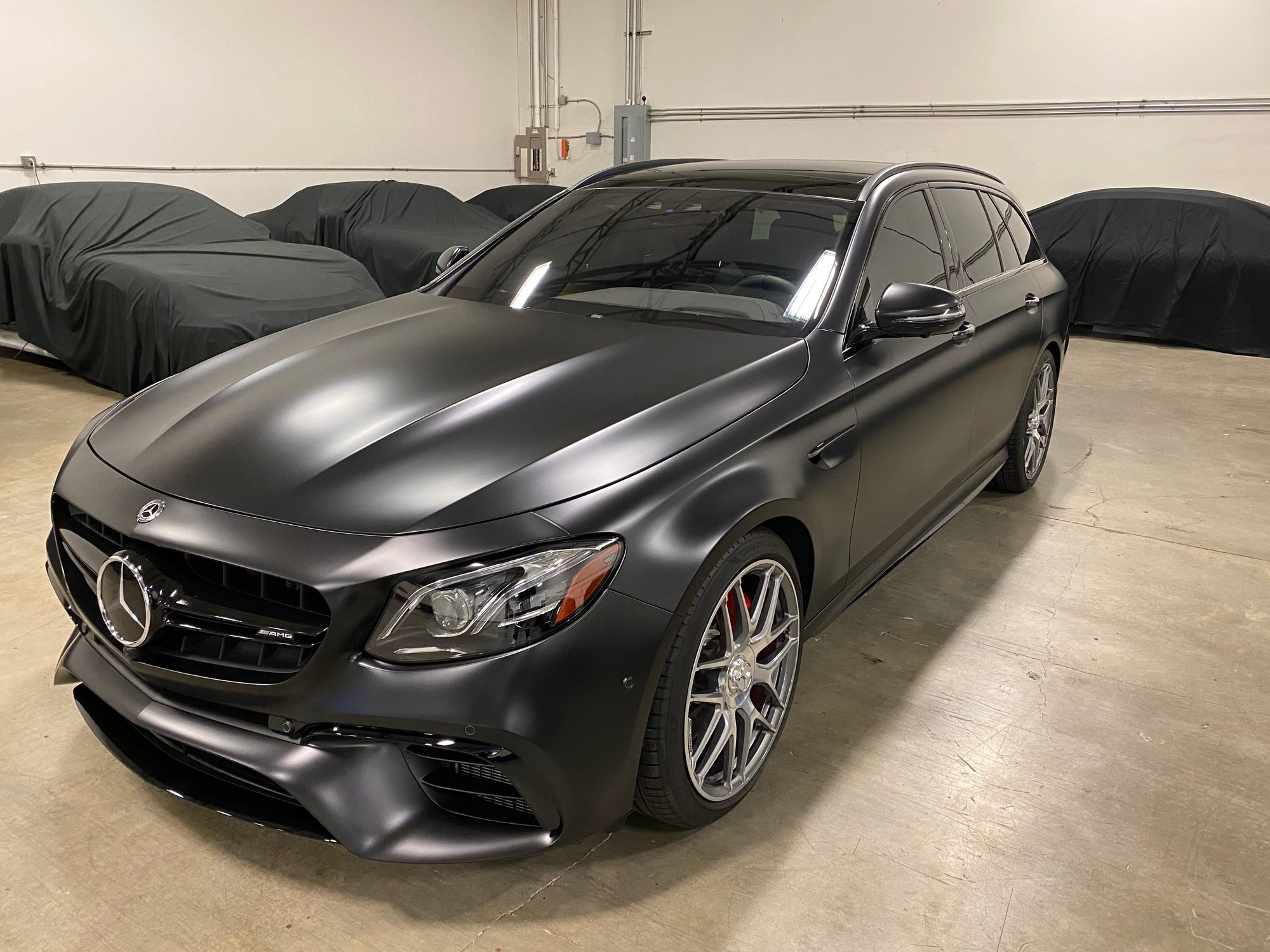

Just got our car back, and our installer was able to wrap it. Said it was tricky but think it turned out great!

You should wrap the ring as well. Ye i wrapped it as well but it was way too much tension. Did you use inlays? as long as it holds up all good.

IMO, looks much better without the outer ring blacked out because that's part of the Mercedes star emblem. It would look equally odd if you blacked out just the ring on the rear emblem and had a chrome 3 pointed star.

The "outside" of the ring is wrapped, but I'm not sure if he could do the "front" of the ring. We are happy as it is, and most likely will leave it as is. BTW, this is Obsidian Black with a Stealth wrap. He used a black gloss wrap for the grill.
