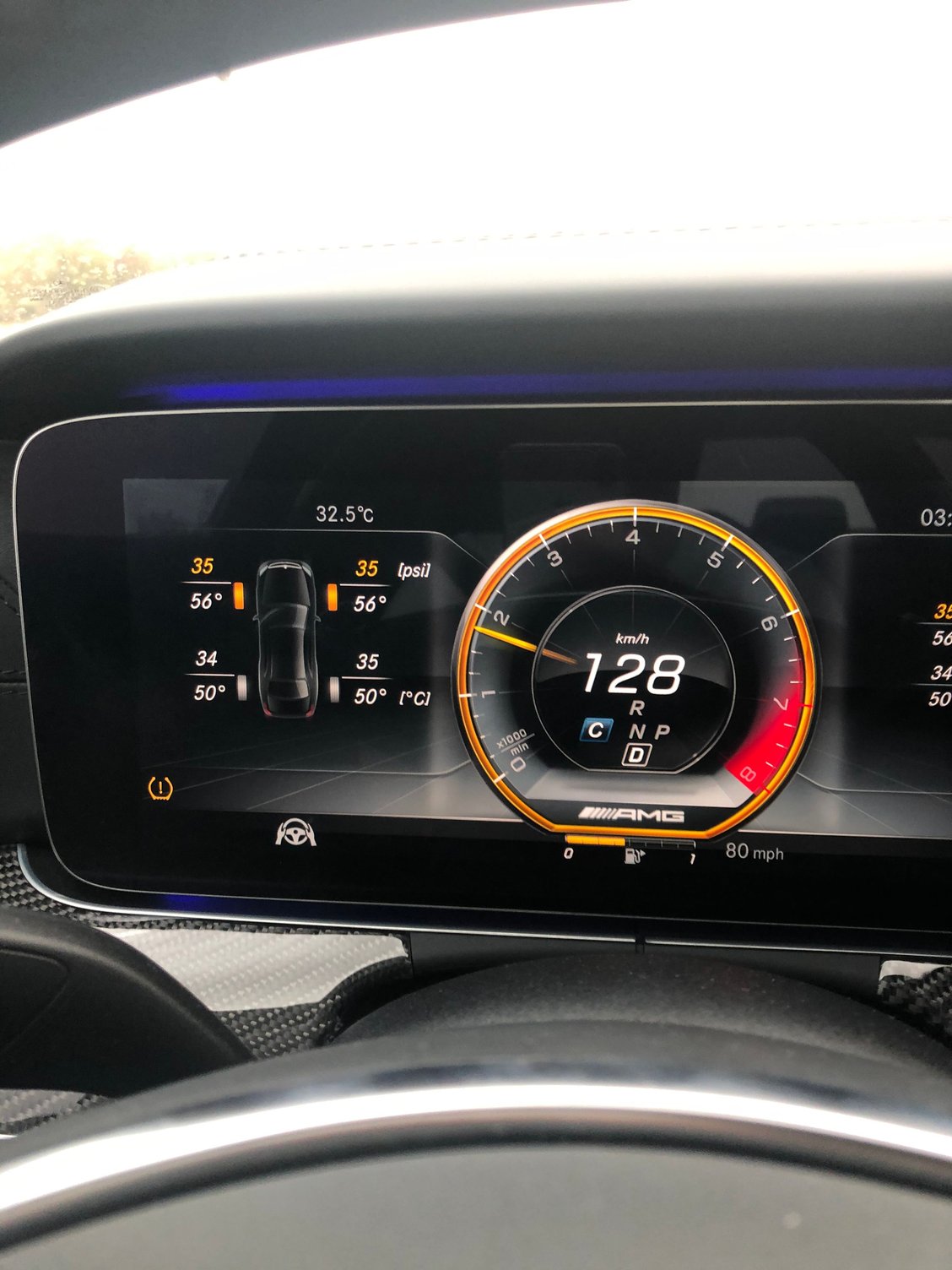

every once in a while ( every 3 days ) i get the “please correct tire pressure” and it only appears when i drive the car for a certain period of time, i am currently sitting on 35 psi front and 34 rear ( warmed up ) so is it normal to get this message many times or i am doing something wrong or it is an issue related to the tires? thankyou

MB recommends 41psi for the front tires and 36 for the rears. At least in my wagon. Any reason you keep the fronts so low? You can adjust the tire pressures on the tire pressure monitor in the car to accept those tire pressures as normal, but they are lower than MB recommends.

Any reason for running at 36 psi? Are you in the US? The sticker on my fuel door says front tires at 41 psi, or higher for heavier loads. I usually run mine around 40 psi in front and 34 in rear.
i am located in kuwait and yes it makes the ride more smooth instead of being rough

You are running the front seriously underinflated and wonder why you're getting an alert?
It's your car so if prefer the ride at that pressure go for it, but the handling and dynamics of the car are compromised. It's not just about mileage. It's the way the AWD system is calibrated. As long as the TPMS detects that the front axle is not around 5 psi higher than the rear, it will complain.
i will lift to to 38 then , thankyou

That will help. Also note that your front tires are quite a bit warmer than your rears. That's another sign that the chassis is being driven unbalanced. In addition to handling, it will result in premature tire and brake wear. If you can get the temps closer, your car will thank you for it.

Originally Posted by fahad alamiry
39 front (warmed) 37 rear (warmed) will be good?
The factory recommendation is 41 for fronts to speeds of 250 kph and 51 above that. Rears can be as low as 33.
These are cold settings. If you are talking about 39 warm that's 37 or so cold, which I would call too low. I never go lower than 39 cold.
But I was pointing out that your display shows you the tire temperatures, and they should be close after the tires are warmed up. You have 50 C in the rear and 56 C in the front. When you adjust your pressure, check out the tire temperatures for important clues on how the chassis balance is.
and if i adjusted the tire pressure correctly but the temperature in front is still higher? what to do next?
Mine always runs within a degree or so (F which is about 1/2 of a degree C). Why don't you see how they run when the tires are inflated according to spec? I suspect they will be close.
The temp sensor is very accurate. If I'm driving with the sun on one side of the car, those tires will be a degree warmer. Cool tires are happy tires (once they're warmed up).
