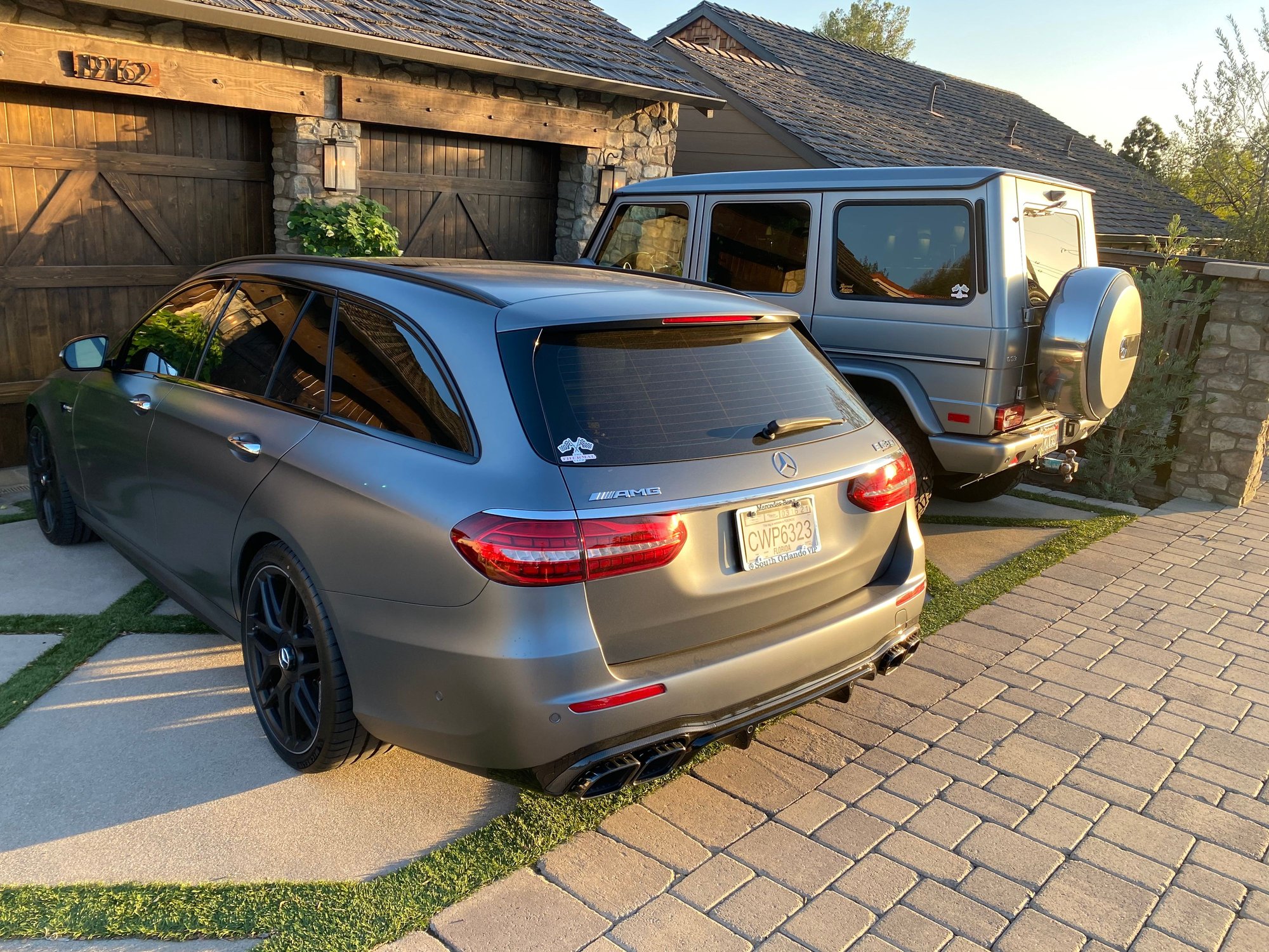

Just picked up a new 21 E63s Wagon and loving it. That said, it needs a bit more growl. Any advice out there on exhaust? It seems as if the US cars do not have OPF, and the exhaust system is pretty efficient and free flowing so I am skeptical if any aftermarket system would increase volume. Any help there? I would be open to a downpipe if anyone has successfully used one with an 02 simulator or something as I do not want to tune the car just for more volume. Thank you all for the help.

Congrats! Looking very sharp next to your G wagon. Yeh, turbos suck when it comes to exhaust sound. IDK maybe try Akra. Enjoy.

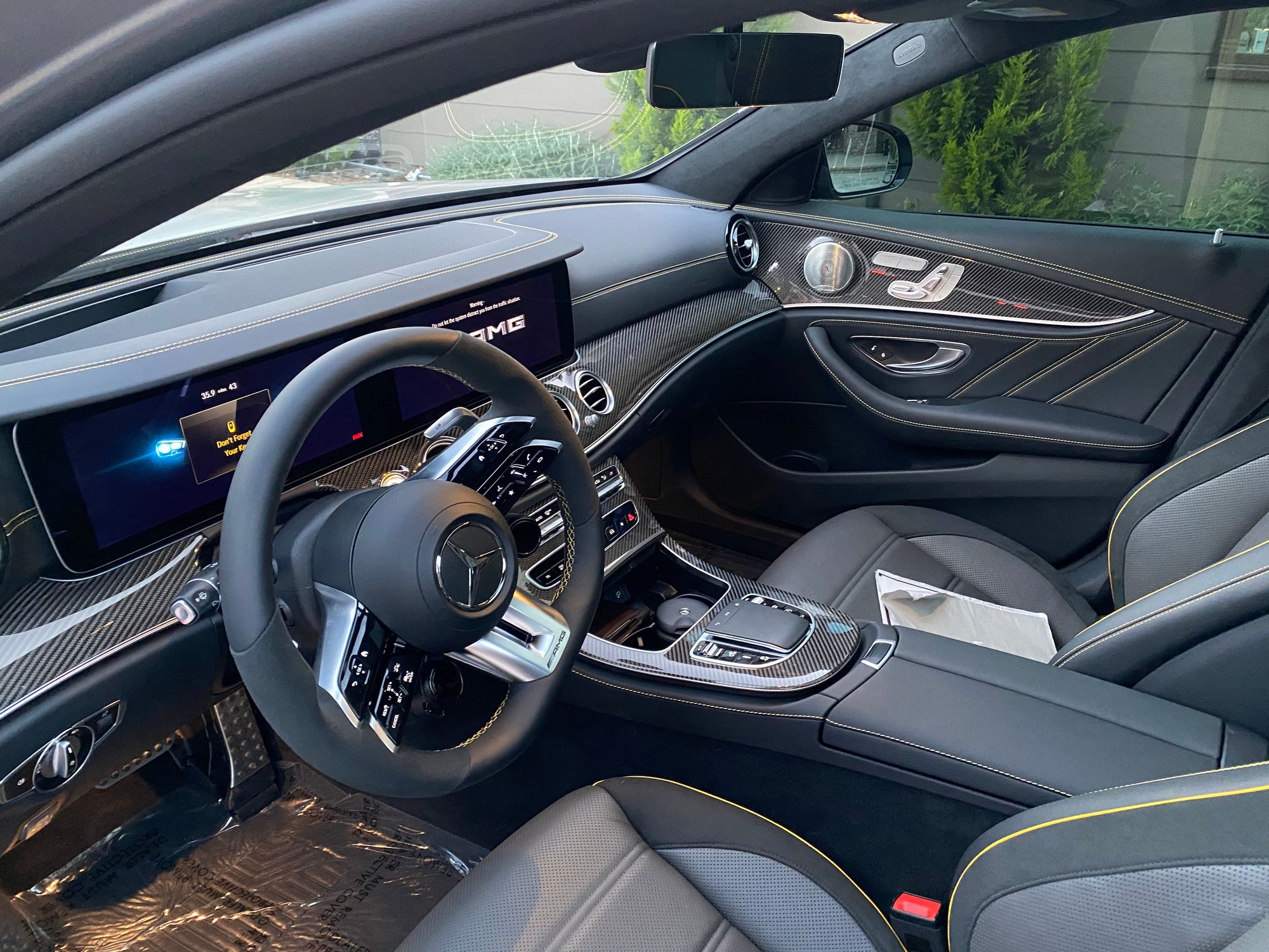

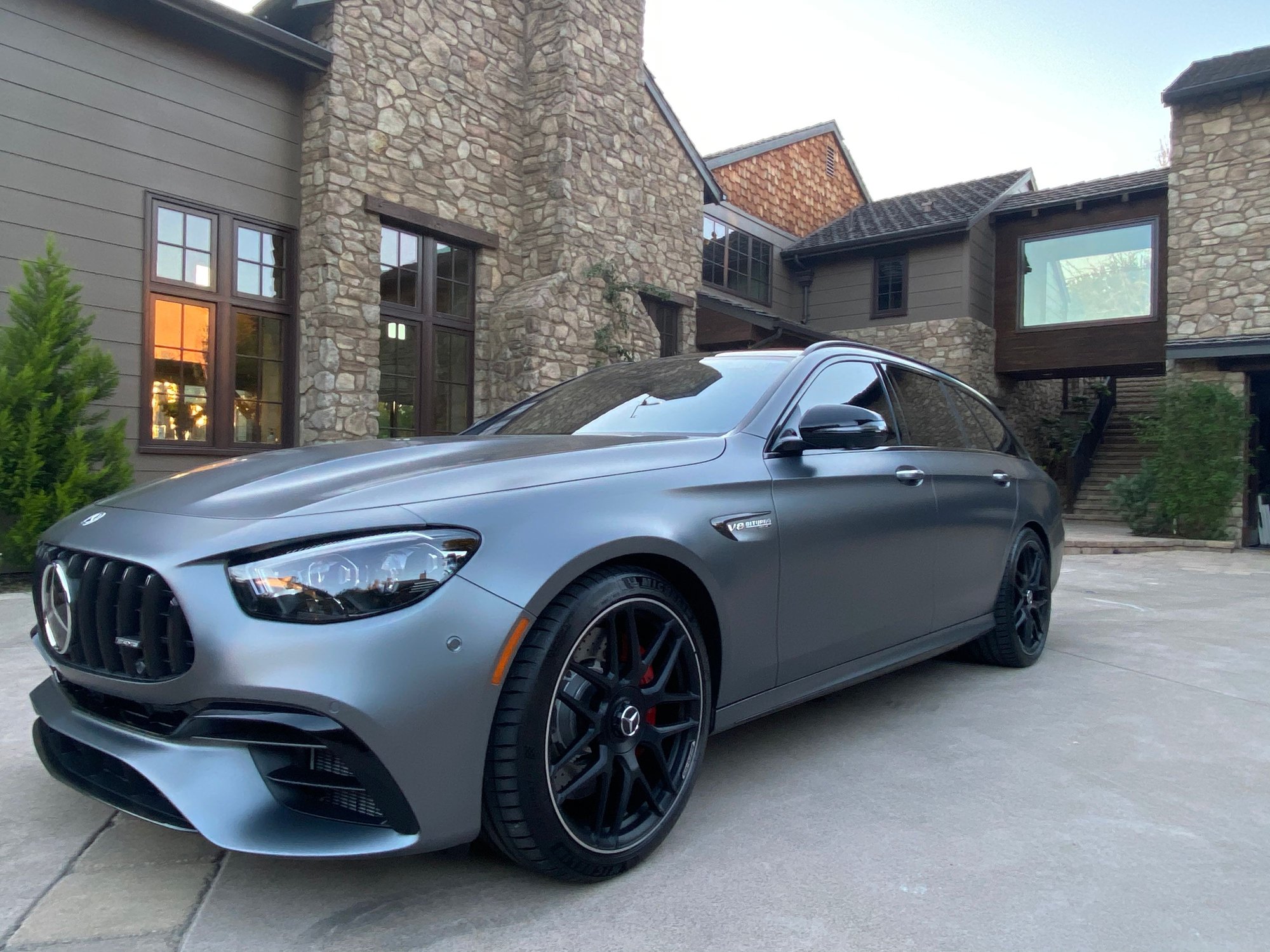

That i a fantastic spec!
Magno paint, CF interior and exterior and the yellow stitching! Sweet!
