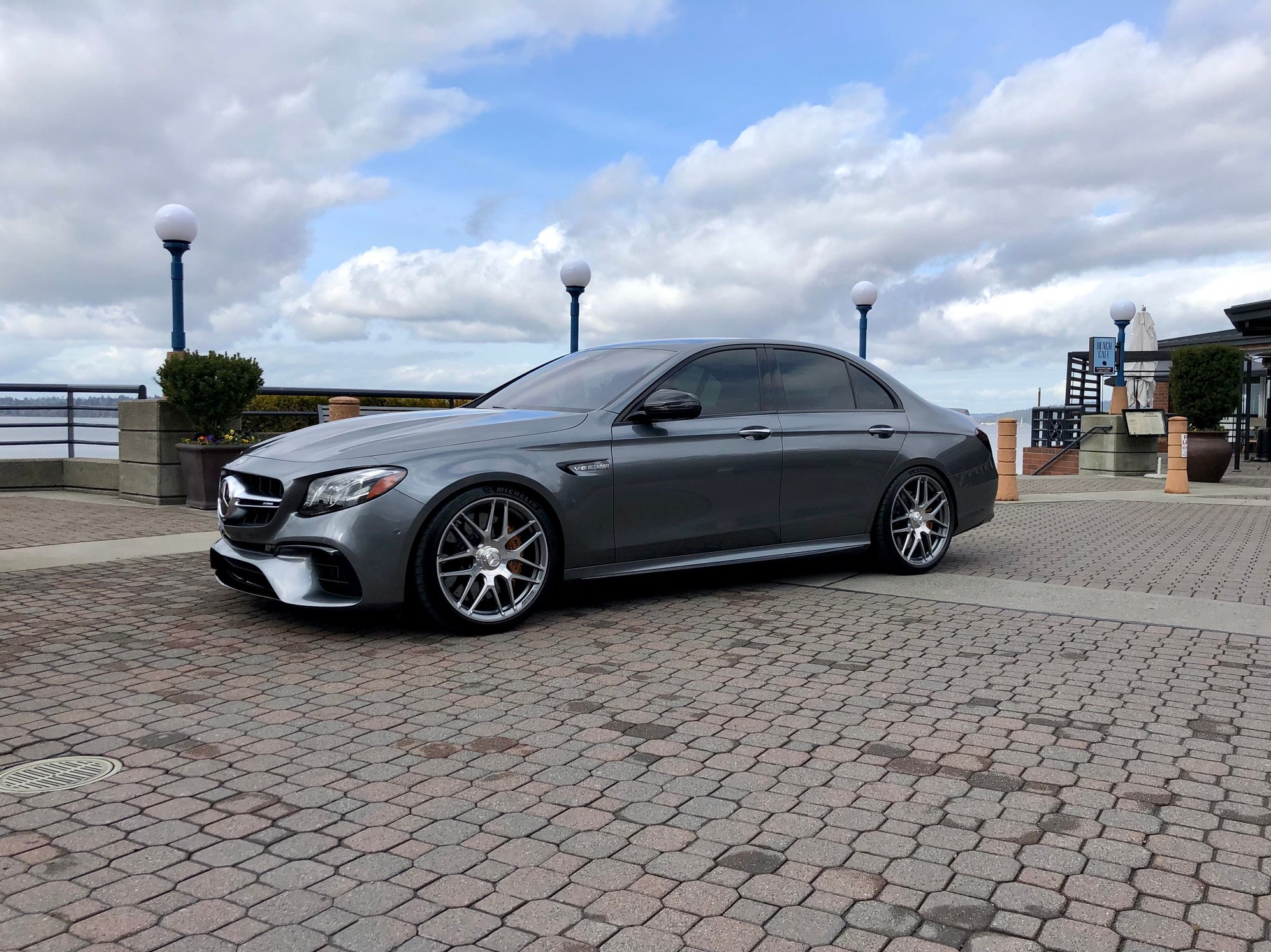

Just going to say outright I wasn't paid anything or given a discount for posting this. I lower all of my cars tastefully and have used every method under the sun to achieve this goal. Springs and shocks, coilovers, just springs, STAR lowering on my W211, links etc. When I picked up my E63S I instantly hated the monster truck stance as I do with every off-the-lot AMG. I knew this new model comes with Airmatic on all four corners and I've had a good experience lowering this type of suspension. However, it's never been so easy in the past as to plug an OBDII module in and fiddle with some buttons for a couple minutes like I was able to do with loweringmodule's T1 OBD box. Plug it in, start the car, follow the prompts, and bam your suspension drops to where you want it. I know there is an Amazon and an Ebay solution as well, but I was more comfortable going with a company based in the US that I could communicate with. It didn't even get that far as they have a Youtube how-to video that couldn't be easier to follow. The module arrived at the same time as my "@Vic55 Special" spacers and lugs from Supreme Power and I couldn't be more happy about the aggressive stance this thing has. If you're thinking about lowering your E63, this is a fantastic, easy and instantly reversible solution for $510.

Tell us more about the "Vic55 special!
...or is there a thread for this already?
P.S. Loving the look of that!

Looks great...but how do you compensate for negative camber?

By not caring about it and buying tires more often. @Drewsky00 If you call Supreme Power and ask for the Vic Special they will send you 15mm spacers for the fronts and 12mm spacers for the rears with corresponding lug bolts.

How big of an issue is that? Would it not get corrected with an alignment?

I lowered my 18 E63S 20mm and had it aligned at the same time. In ~3K miles the front tires were toast. Ended up getting special A arms installed w/alignment and no problems whatsoever.

Congrats CH--- car looks great.

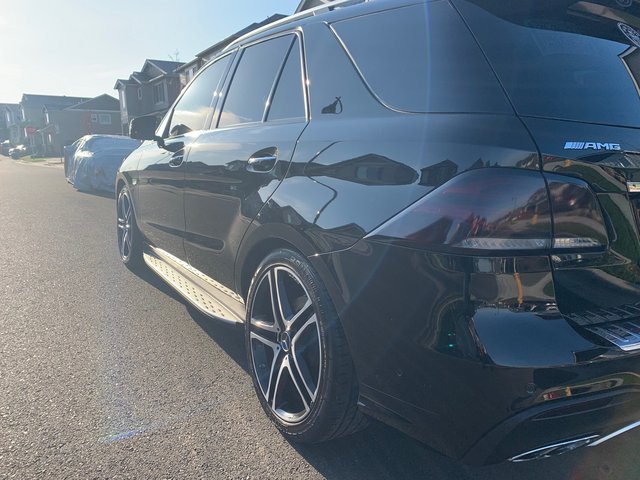

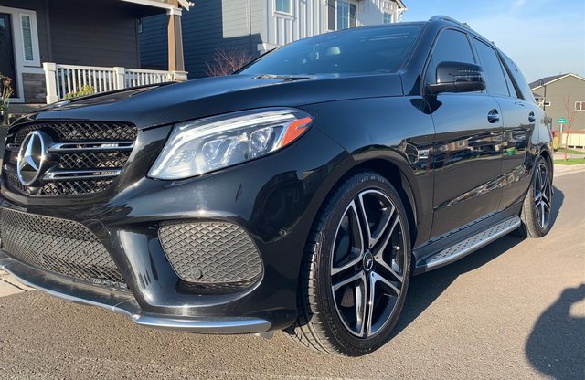

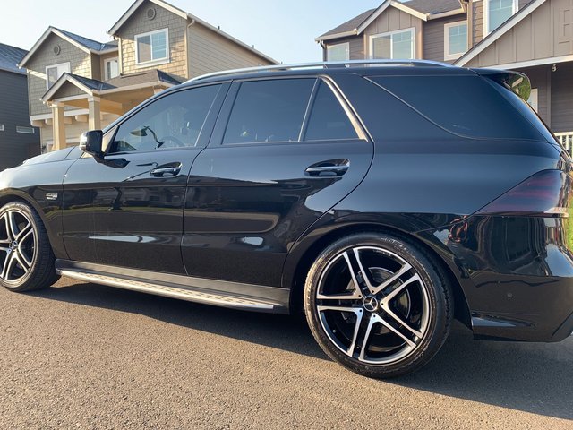

I just installed the module on my GLE43 AMG and freaking love it!!

Would love to but throwing away tires so frequently really makes me not want to mess with this suspension at all =/
Car looks great, btw

Looks great. This was also my very first mod.
must have.
if you want to get rid of the front camber, message me. I wasn’t a fan of replacing front tires every 3k miles at my lowered ride height 😅
