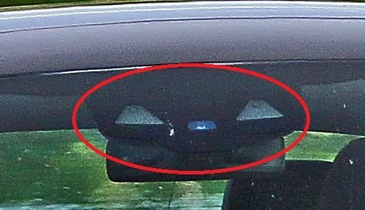

Originally Posted by crimson96
So where are the "eyes" (camera) that read these signs? Can we cover them with tape so they can't see anything?
Just trying to figure how to avoid becoming automatically compliant with laws that will require the ISA. 'm guessing if your car has an ISA in it, they will require it's full use when it becomes law, so looking for a permanent work around - or are there tuners who can properly and permanently disable the software?
The stereo camera is in the windshield behind the rear view mirror, but they are used for other things, too, such as collision detection etc., so if you cover them up you'll get faults as they will detect if the view is obstructed. The one in the middle is the rain sensor if you are wondering. Cars w/o the driver assistance package only have a single camera. As far as speed limit recognition goes, it also works in conjunction with the navigation system. It doesn't just rely on the detected speed limit signs. If no signs are detected for a while it assumes the national prevailing speed limit for the current road you are driving on based on the map data. So not sure what that means for the proposed requirement in Europe. To fully function they would also have to make the navigation system standard on all cars. The navigation data is important not just for the prevailing speed limits, but also to process the detected speed limits and decide which one applies depending on the road you are driving on. For example frontage roads in the USA would be an issue otherwise as it might detect the lower speed limit of the frontage road while driving on the highway. With the help of the GPS position and the navigation data it can determine if you are driving on the frontage road or the adjacent highway and display the correct speed limit. Same goes for exit speed limits. It shouldn't pick up the lower speed limit of an exit, unless you are actually exiting.
