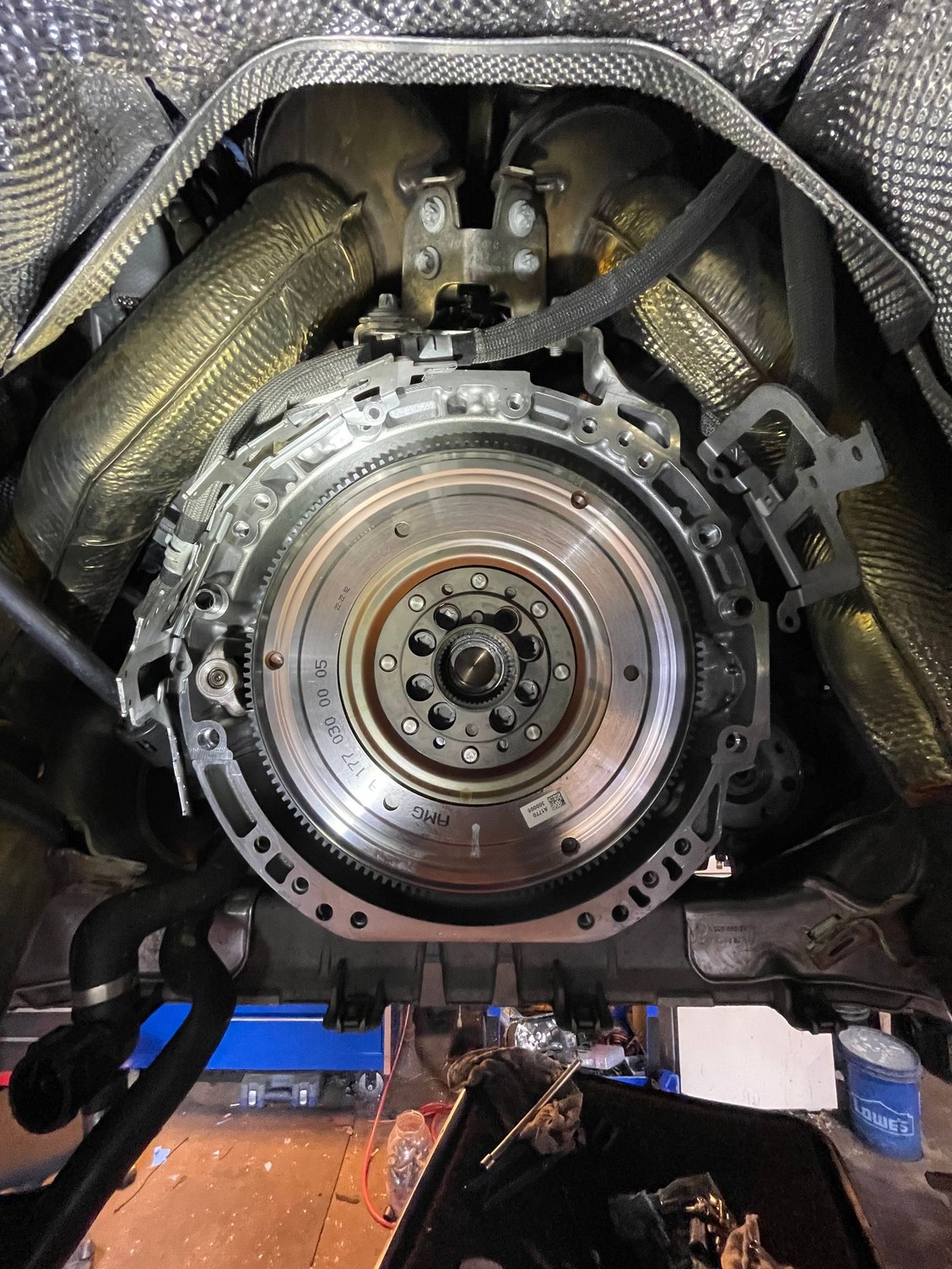

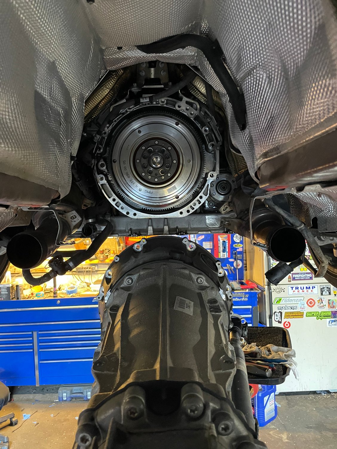

i can’t say for sure about others, but my RMS definitely failed… and the car hasn’t leaked a drop of oil since replacing.

Cool photos. Did you have air/oil separators replaced? What was the root cause of RMS replacement in your vehicle's case?

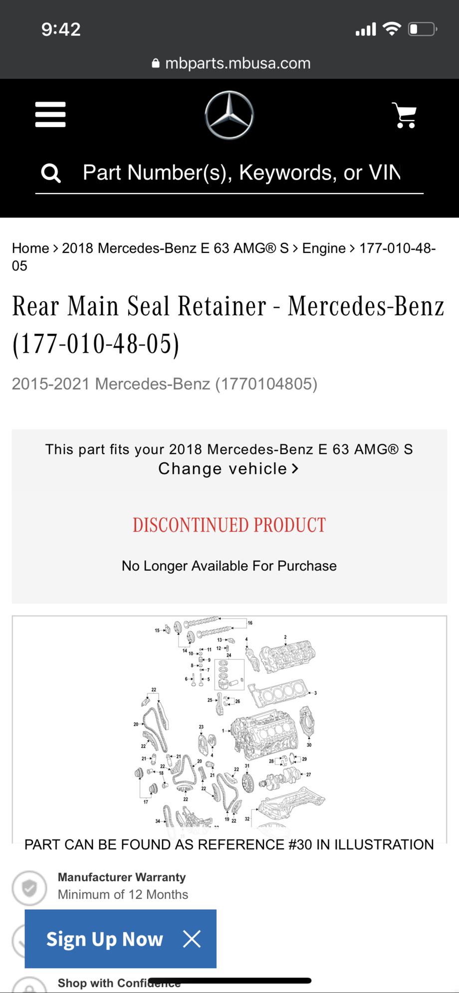

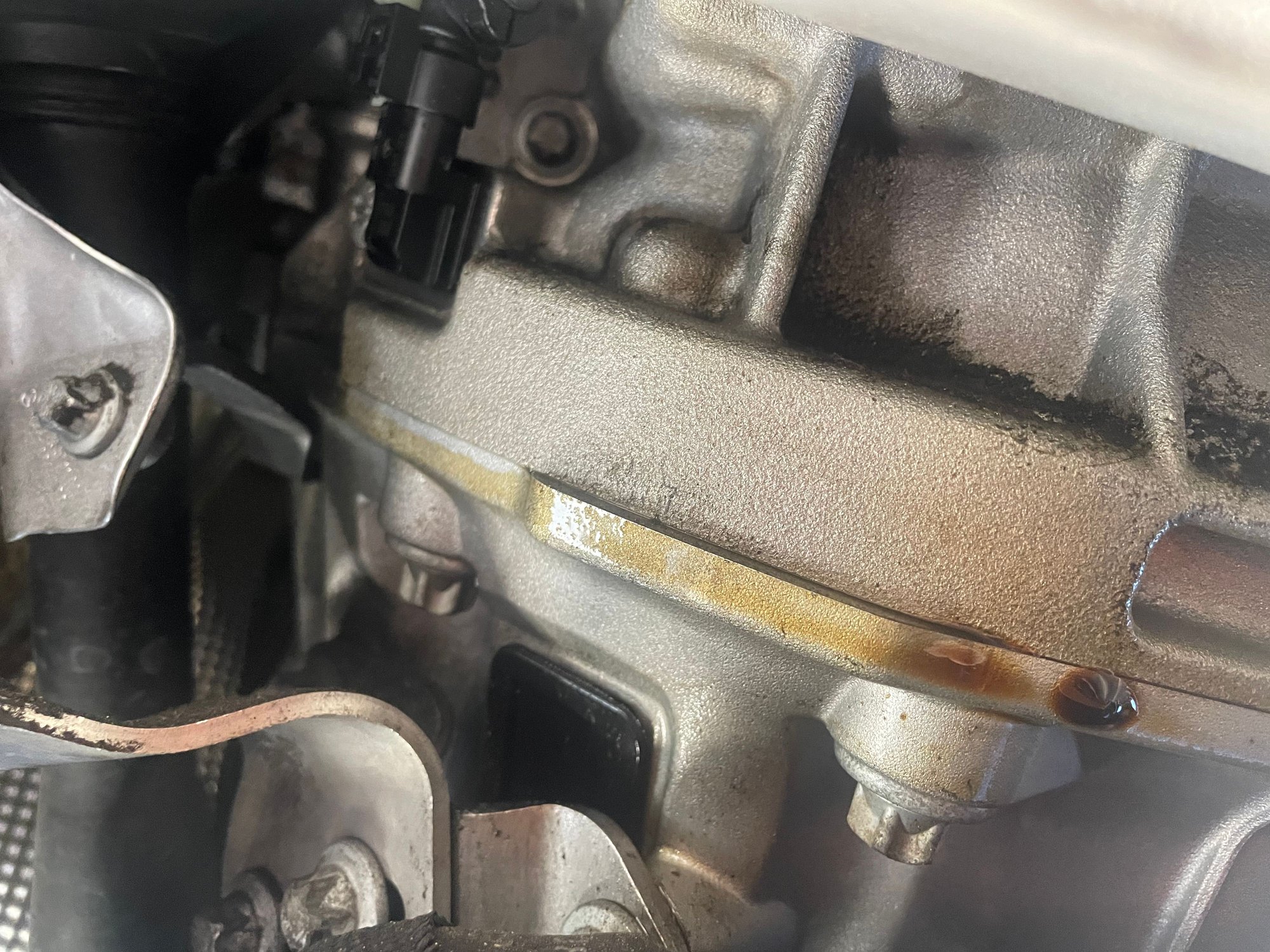

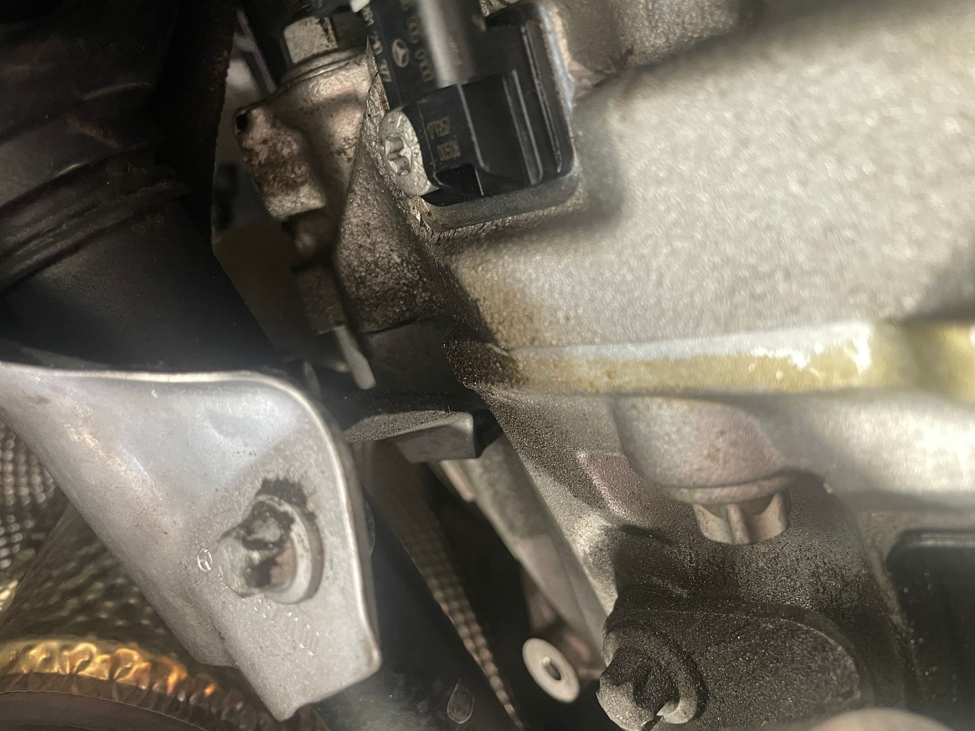

does this seem like a RMS Leak? My thought would be that it would be coming out if the bottom, seems pretty high up, but could be wrong. Also the rear crankcase cover with seal is showing as being discontinued. So not sure how to fix this… lol
