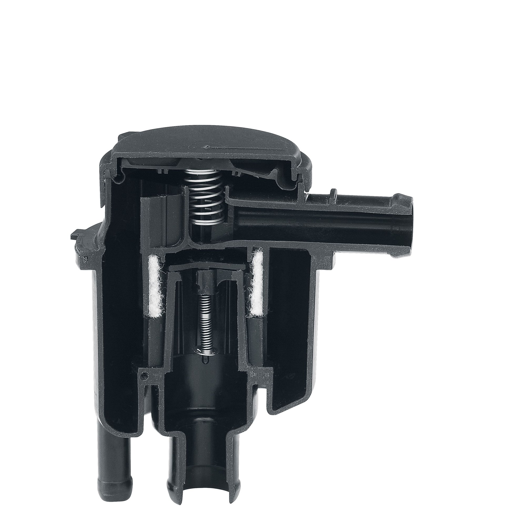

VAG separators have at least two check valves. The valves can stop working (plug) and pressure builds up behind them, and finds the path of least resistance. Apparently with the M177 MB 4.0 TT V8 this path is out the rear main seal.
Mahle is the supplier for the M177 vapor separator. It is a dead simple component - only three screws plus hose/tube connections. However, the intercoolers on some installations need to be removed or at least moved out of the way, which increases the labor time significantly.
The images below are from Mahle, the supplier of the M177 component. The images do not show the M177 separator but show at least 2 springs which control the "overpressure" check valves. There is also some "gauze-like" material in the assembly. I can imagine the internals of the separator and gauze-fiber filter getting gummed up and the spring/rod/valve assembly getting sticky. Good idea, bad implementation. As usual.
Separators are beta technology in the industry, car companies are still figuring them out.
First image is similar to the M177 component. Second image shows internals for the principal of operation.
https://www.mahle.com/en/products-an...ir-management/

Great info , thanks for clearing that up. Yeah surely some diy's will make their way around eventually on replacing these . Can't find much yet except for valvestuds wis attachments .
