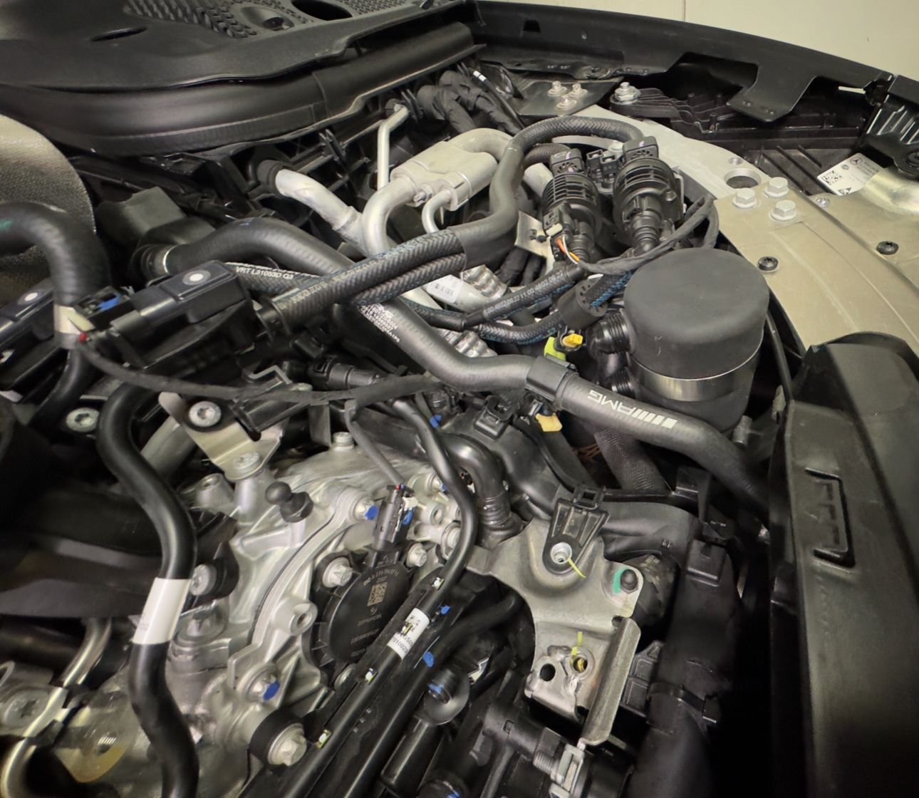

I keep following up on my wagon on the status of the prototype catch cans as I am hellbent on not wanting to deal with RMS/AOS failures on this car.
1. it better not result in any codes;
2. It must look OEM to pass visual inspection (be somewhat hidden); AND
3. IT BETTER WORK!

Sorry if this was already discussed in this thread . There are new separator part #'s - whether or not it's a worthwhile revision who knows . Has anyone done the separators themselves , or paid to have them done proactively ? Curious on labor/cost.
Old Jan 30, 2024 | 11:51 PM
its a fairly involved job being sandwiched between the intercoolers and cylinder head. I would be curious as well

I dont want to worry about RMS/AOS garbage so when this hits its all about going fast all time everytime.
This is pre-AOS routing of catch cans getting developed. Unlike Zac motorsports this one reroutes before the AOS to prevent it from getting overwhelmed and clogging. Zac’s routes after the AOS on a return to intake and by that point the AOS is already riddled w contaminants. God I’m ready to take this out for spring. The wait over winter is rough!
