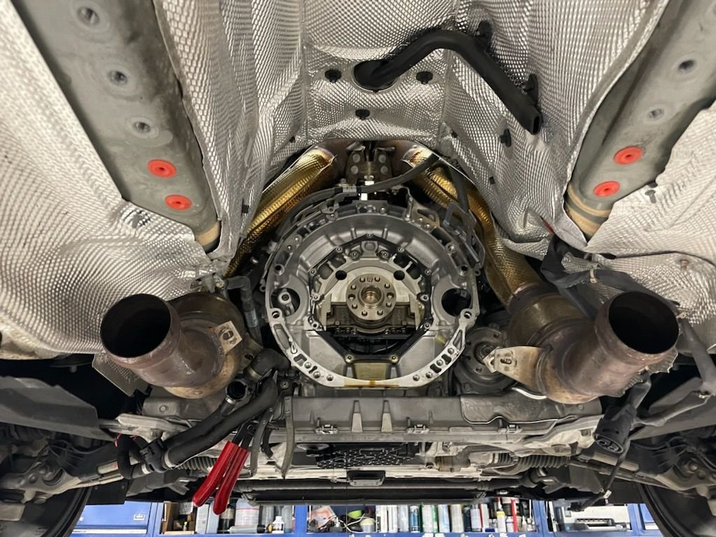

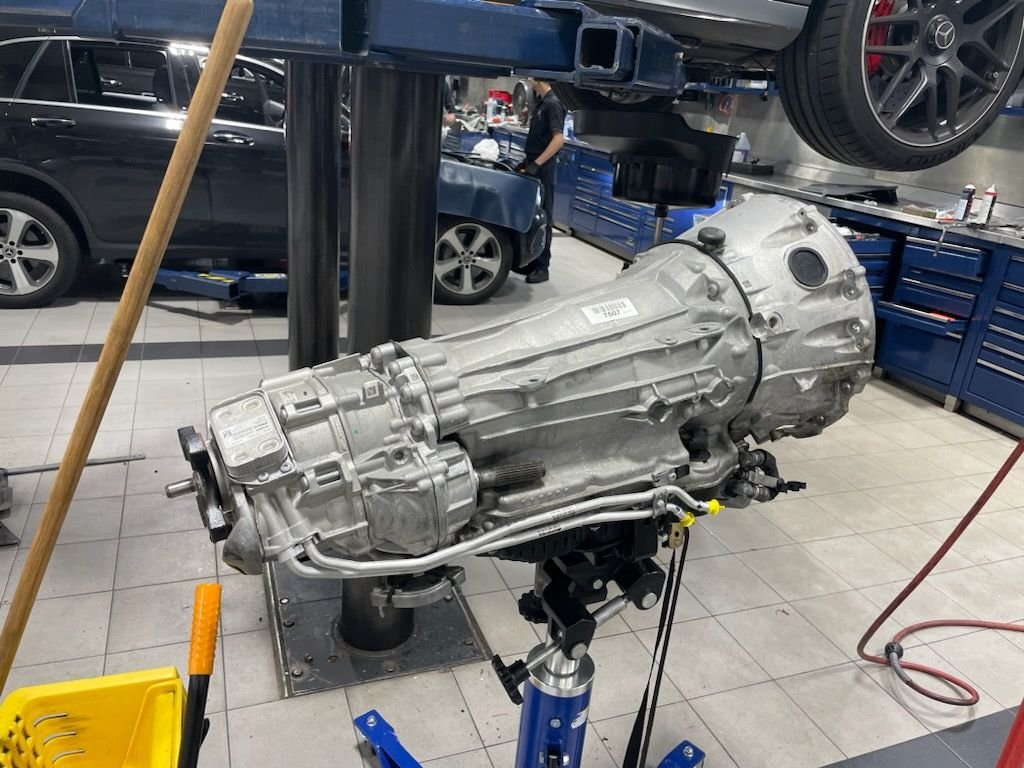

RMS no oil separators :(
2019 e63s with 28k miles getting a RMS fixed. Dealer here in seattle is refusing to replace oil separators under warranty so I guess we will see if it leaks again. (car was originally in Manhattan I purchased it as CPO and had it shipped)

'19 E63S
LOOK AT THE SIZE OF THAT EXHAUST PIPE! I had a feeling it would be significant but never seen it til now . . . wow, just wow!
