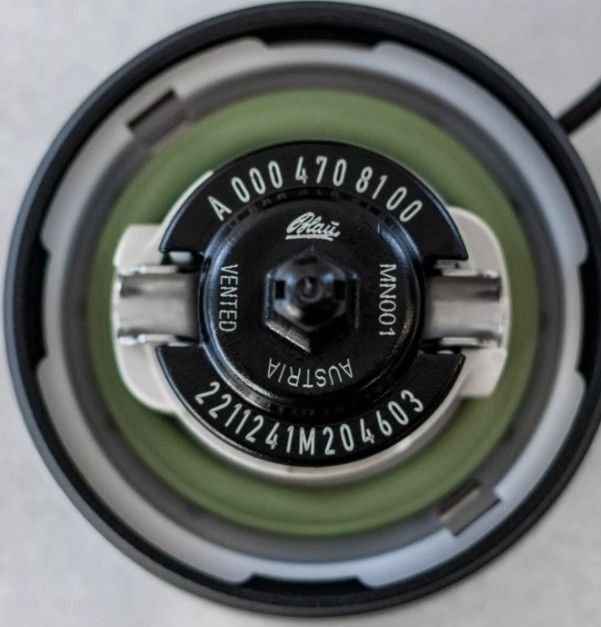

Update #2:
Ok after all that hoopla, the car has been running golden once again. About to trip 150,000...
With that said, I think (just a guess but due to the problem seen on Xentry) that the issue stems from the Vented AMG "silver" cap. I have since re-installed the OEM black fuel cap that came with the car just incase.

Originally Posted by figuwx
Update #2:
Is there a superseded part available for that silver cap that might work?

2018 AMG E63s Ed1
If there is, i have not seen it.
They are all vented (at least that is what the bottom shows) and they have that center protruding..
Which is a shame I mean the cap looks good and it is important because you know, we need to gas up pretty often with this beast and it is nice to be able enjoy the gas up more with the newer style cap.

2018 AMG E63s Ed1
at the cost of venting...
As i said, no clue if this is the culprit BUT it wont help as most European cars do actually monitor the pressure in the fuel tank hence why most will kick MIL when the gas cap is left off.
Being an oem part it should not cause a CEL though, is it a design fault or just not working on this particular vehicle? What was that cap originally designed for? the AMG GT?
