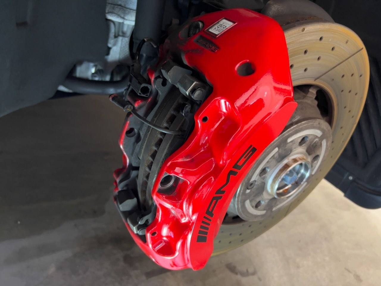

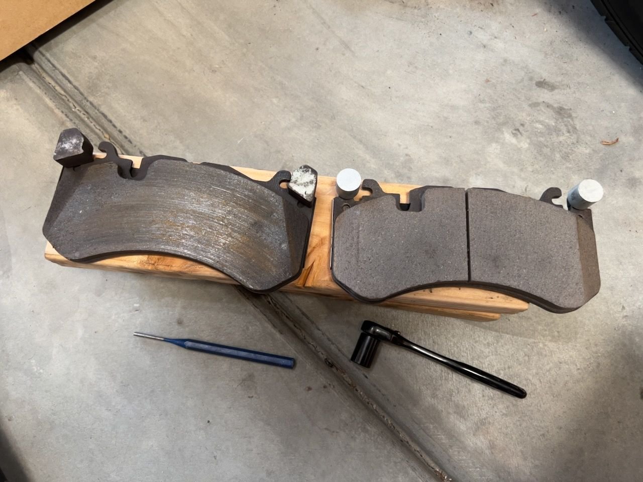

I changed the front stock pads to the Z23 today. The rear pads are still in shipping. Stock pads are Brembo.
It took me a while to figure out how to put the rear parking break into pad change service mode.
First turn on engine, disengage parking break.
Turn off car.
With foot off brake pedal, press engine start button once.
Go to Trip display on the center that shows mileage.
Hold down left steering wheel HOME button for 10 seconds, then release.
Hold down left steering wheel OK button for 10 seconds, then release.
Press HOME button, then swipe left with arrows to get to Workshop menu, and the brake pad change mode is there and ready to engage.
Learned from this video
