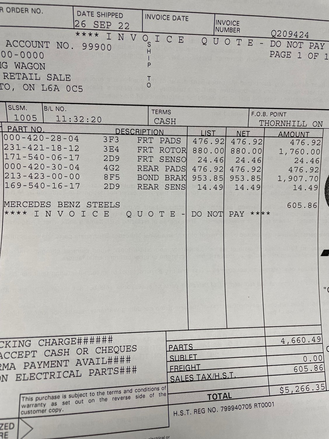

All OEM parts quoted from Cdn MB dealer …. If you want everything in OEM
i went with these but bought from local OEM parts dealer with 20% discount.
