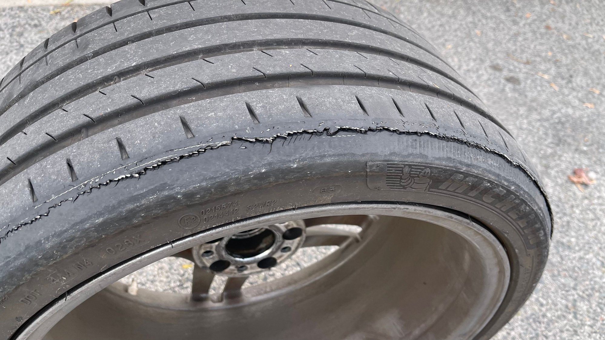

go fast grocery getter wagon
Those are tires destroyer 😄
Yep been there done that.
even after an alignment? im not going to slam it maybe like 1" drop

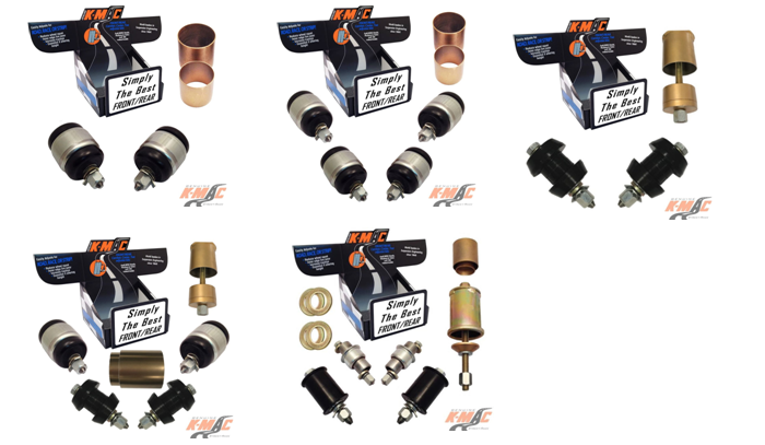

Reality is there is no longer Camber or Caster to adjust !
WITH EVER INCREASING SPEED OF NEW CAR ASSEMBLY LINES IT HAS BEEN DELETED. Now only one “showroom height Camber (and Caster) position.
THE OFTEN QUOTED REASSURING “We will carry out a full Front & Rear ‘4’ wheel alignment!!”
….IS IN FACT ONLY “TOE” (directional adjustment).
No Camber to change tire contact angles, spread load more evenly. Excess edge load can also lead to higher impact ruptured side walls.
We saw the need therefore to re instate Front Camber and Caster. Rear Camber (& extra Toe).
Designed to fit without special tools or need for arm removal. The K-MAC patented design allows precise single wrench adjustment. ULTIMATE - direct on alignment rack “UNDER LOAD”
SEE SPOILER
AUDI to VOLVO - K-MAC Experience Of Resolving OEM Suspension Shortcomings Since 1964 !

ALL MODEL W213
FRONT SUSPENSION (Lower Arm Inner Bushings).
E200-350 #502816-1i $345
Camber only (less cost then one Performance Tire).
#502816K $480
Camber & Caster
E43, 53, 63, E220-450 4MATIC #503416-1i $345
Camber only
#503416K $480
Camber & Caster
Caster bushes are also Monoball / Self aligning significantly improving brake and steering response.
REAR SUSPENSION (Lower Arm Inner Bushings).
Coil suspension #502226K $480
AIRMATIC #502326K $480
AMG/S Models #502326-1K $480
FRONT & REAR - No special tools, fit without need for arm removal.
And Tested by BenzNinja years ago!
Great product!
SEE SPOILER
Spoiler
Spoiler
Other than correcting caster/camber do these have any effect on ride? Stiffer bushings, etc?
Besides background info re bushings ride / stiffness do point out constantly designing / updating and latest design breakthrough is that all kits now - no special tools required or need for time consuming arm removal re fitment !
Bushings that effect ride stiffness are the Front forward facing thrust arm bushes. OEM are large 75mm diameter incorporating rubber and internal oil reservoir allowing arms to oscillate / travel through their required suspension arcs without binding, locking up.
Majority of aftermarket brands replace these bushes with urethane - improving brake and steering response but the consequence is exceptionally firm ride through above mentioned binding / locking up of arms, through lack of being able to self align.
K-MAC design replaces the OEM bushes (on car) and incorporates precise “Caster adjustment” for the first time. Bushes are also Mono ball / 2 Axis / Self aligning with extra large impact, surface area.
Owner feedback is significant improvement to brake and steering response but without undue ride harshness. With situations in competition racing where “Race Safety Scrutineers” stipulate only K-MAC bushings allowed to be fitted !
Kevin
I wont be racing, this is a street vehicle. So will your caster/camber kit make it ride rougher and increase conducted road noise/vibration or not?
As above - not the rear (Camber and Toe) kit or the front Camber kit. Yes the separate front kit that “also includes Caster” - these forward facing bushes do effect / is noticeable but as pointed out being Mono ball / Self aligning owner feedback (now in production refined over last 25 years) is positive re no undue harshness and the benefits of the tauter steering response whether heavy ‘S’ Series AMG W222 models or a lightweight CLA.
Kevin
