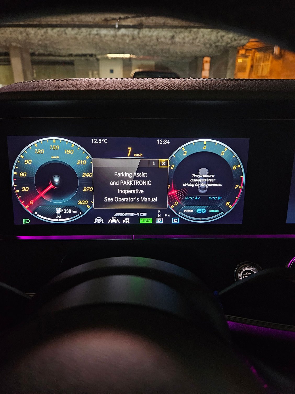

I am often getting a message when I turn on the ignition about parking assist and parktronic not working (please see pic).
Anyone have this issue or know why? Before the message comes on, the sensors make noise showing red around the car in the display.
It doesn't happen all the time but often enough.

One or more of the sensors is bad or needa to be recalibrated.

Or possibly there is some dirt covering one or more. Sometimes it just needs a washing to clear a sensor.

Ok so here is an update on this issue. When I start the car if I do not wait a few seconds before putting it into drive then I get the issue but if I just wait a few seconds then the problem does not occur. So it seems I was just putting the car into drive too fast for it to load all its software or calibrate its sensors I guess? Not sure but the issue is resolved as far as I'm concerned.

Hmmm, it does indeed sound like the system is still booting, like for example booting windows.

When you go into the cameras after you have let it 'boot up' is the blue line all the way around the image of the car? If not, then its still faulty, just not giving you the error message. I had this not long ago and one parking sensor in the rear needed changing.

I checked and it is blue all around the car and all sensors work well.
