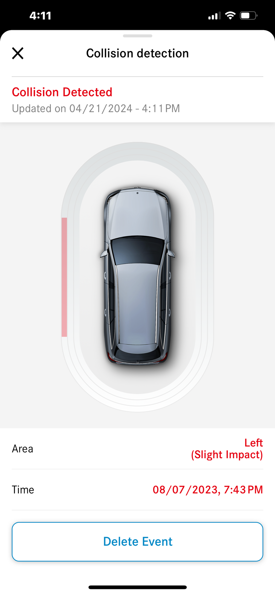

Brand New Car - Collision Detected
I bought a car out of state and had it shipped to me. Car showed up 10 days late, it's been a nightmare. So I climb into the car to see a collision detected message, there's no physical damage to the exterior but I'm guessing the warning doesn't appear from hitting a bump in the road. What does it take to generate this message?

Was it shipped enclosed? Was the battery still connected during transport?
likely the sensors over reacting to car movement vs proximity of obstacles (enclosed box) or another car near it (on the carrier); it can warn of collision if its being towed
also may need software update or adjustment of settings
https://mbworld.org/forums/e-class-w...ion-issue.html
https://forums.mercedesclub.org.uk/i...tected.178194/
Thank you. It was on an open carrier, they did not disconnect the battery. The area illustrated on the screen was the right side of the car, maybe some kind of hard swerve that surpassed a G limit? I drove around the block and it seems ok but I'm thinking I need to have MB inspect the suspension. If I don't do it now and something happens later I will be screwed.

They just needed to turn off the Guard 360.. it senses the car shaking on the carrier and it knows its not on/running, so it things its been hit...

I was thinking about this....the car will not set off an alarm if you are driving down the road and hit a bump. How about if the engine is off? Could be a lower threshold for a 'parked' car indicating that something has collided with the car.
