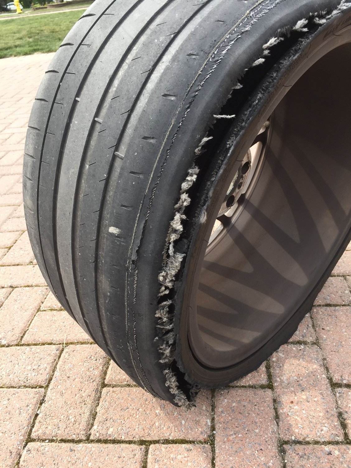

Here was my front passenger side. All my front and rear tires had excessive wear to the point of steel belts were showing.
