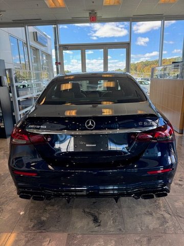

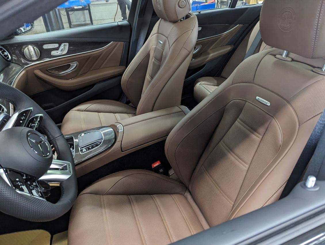

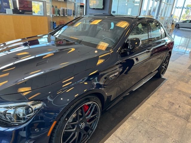

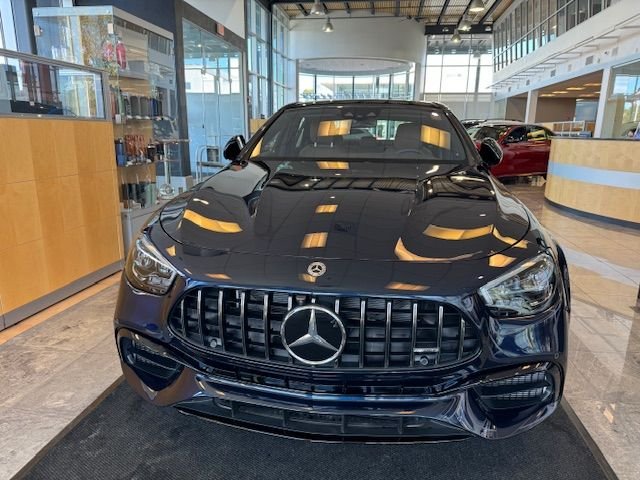

My apologies to all. I need to find dealer paperwork to see what they said they did to fix. The sluggishness is marginally better but still around. Here are pics. Sorry I’ve been off the grid to get back on the forum - had a major family milestone that took all of my focus away! I only have the pics from the dealer when I took delivery. I park outside and it’s pretty dirty currently!

Gorgeous! Thanks and congrats to the milestone mentioned!
