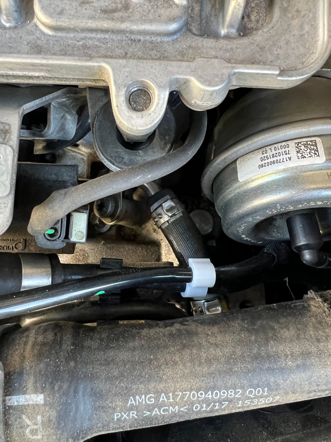

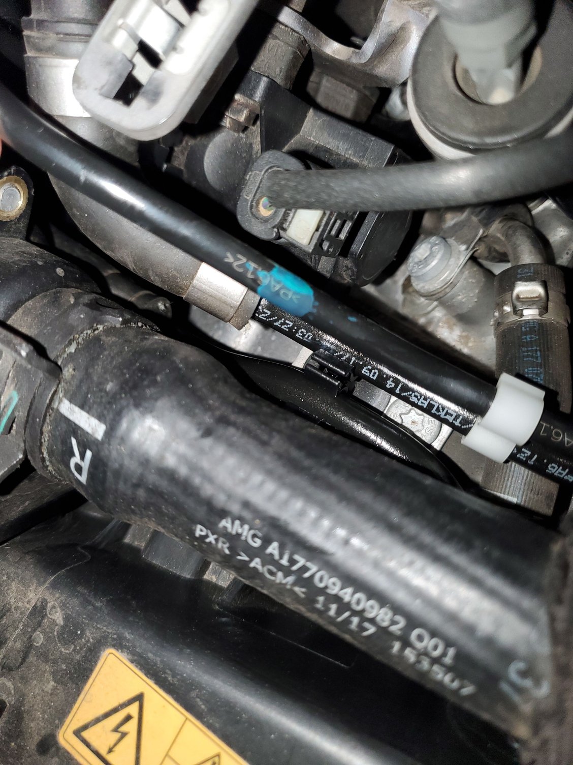

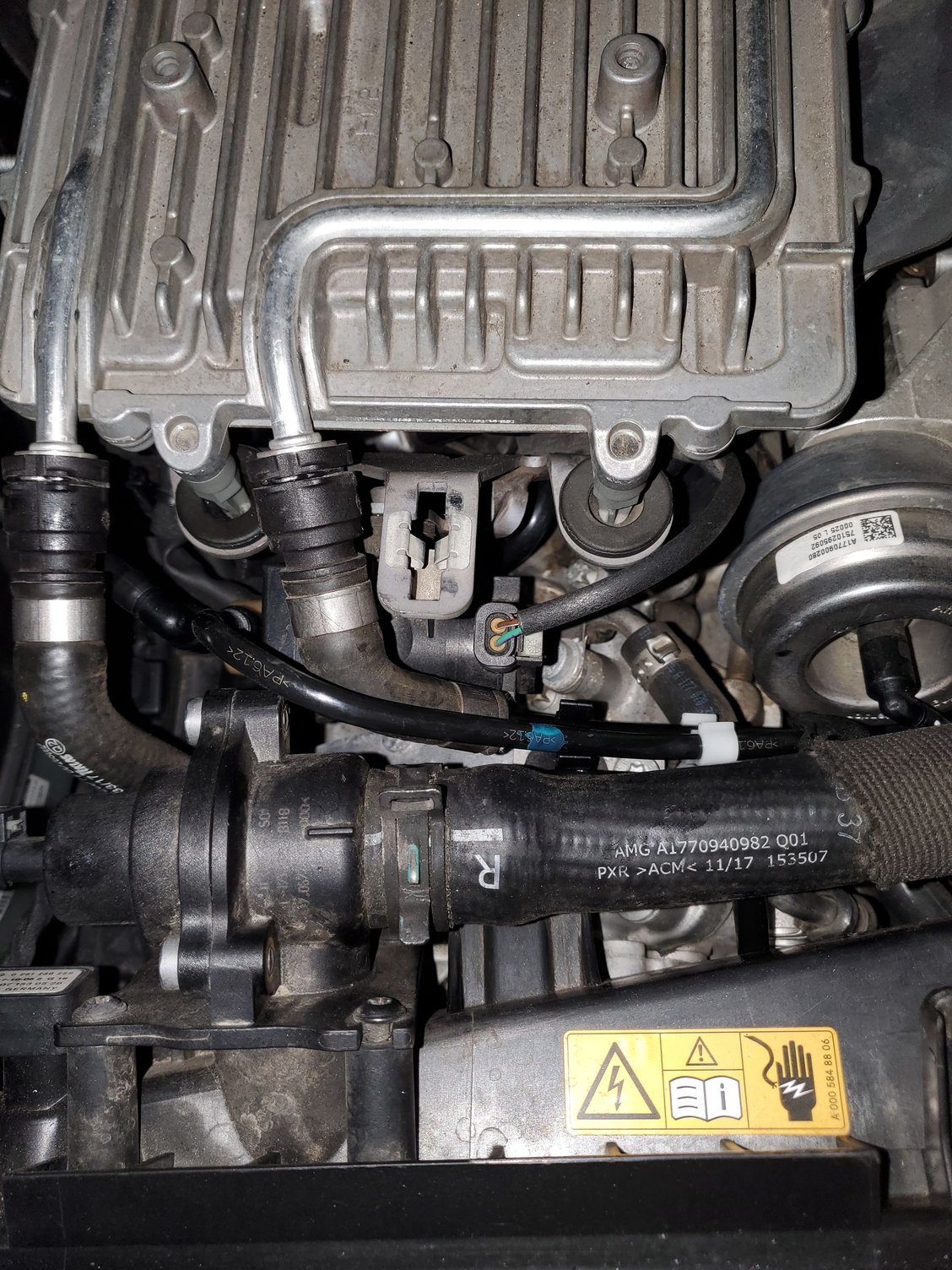

At the dealer now for this exact issue.  MB recall campaign will cover it.
Old Jan 20, 2025 | 09:10 AM
Bigwinner95's Avatar
Joined: Jul 2023
Posts: 24
Likes: 10
From: Chicago
2018 E63s AMG Wagon; 2025 M3 6MT; 2016 Golf R Revo Stage 2
couple more pictures, wide and zoomed in to show the wet fuel lines.

This is really helpful. They already charged me to replace the fuel line so I'll go back and talk to them!
Old Jan 20, 2025 | 11:26 AM
Joined: Jul 2023
Posts: 24
Likes: 10
From: Chicago
More support for you to get your $ back. I have an '18 wagon with 100k miles, so you should be covered too. Sure glad I didn't have to foot the $320/hr stealership rate!
