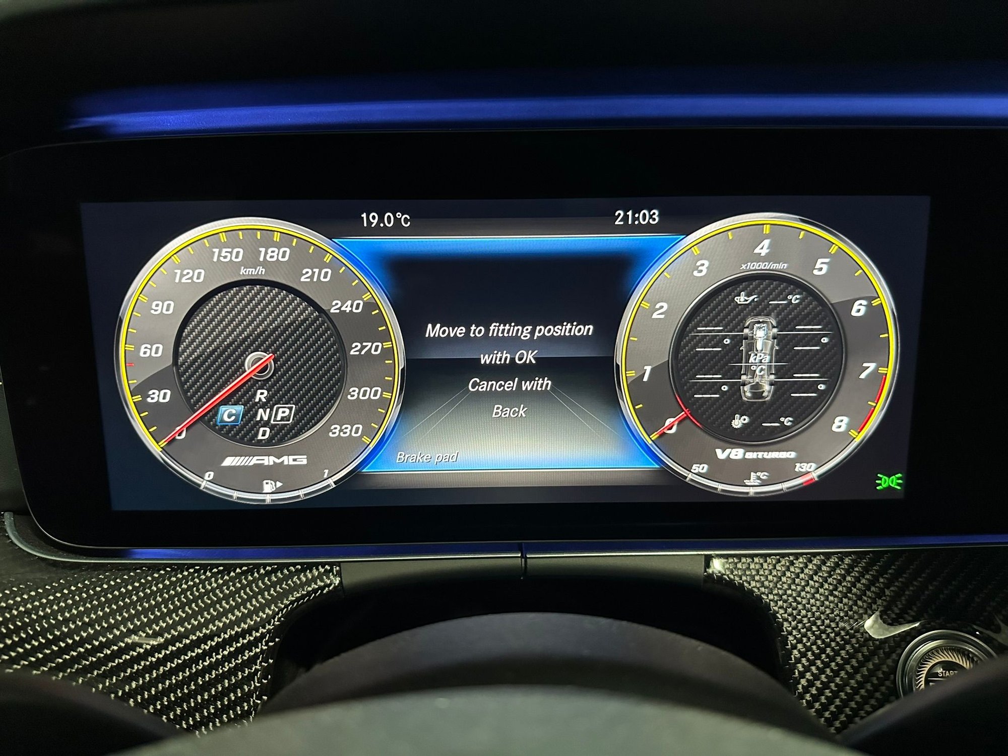

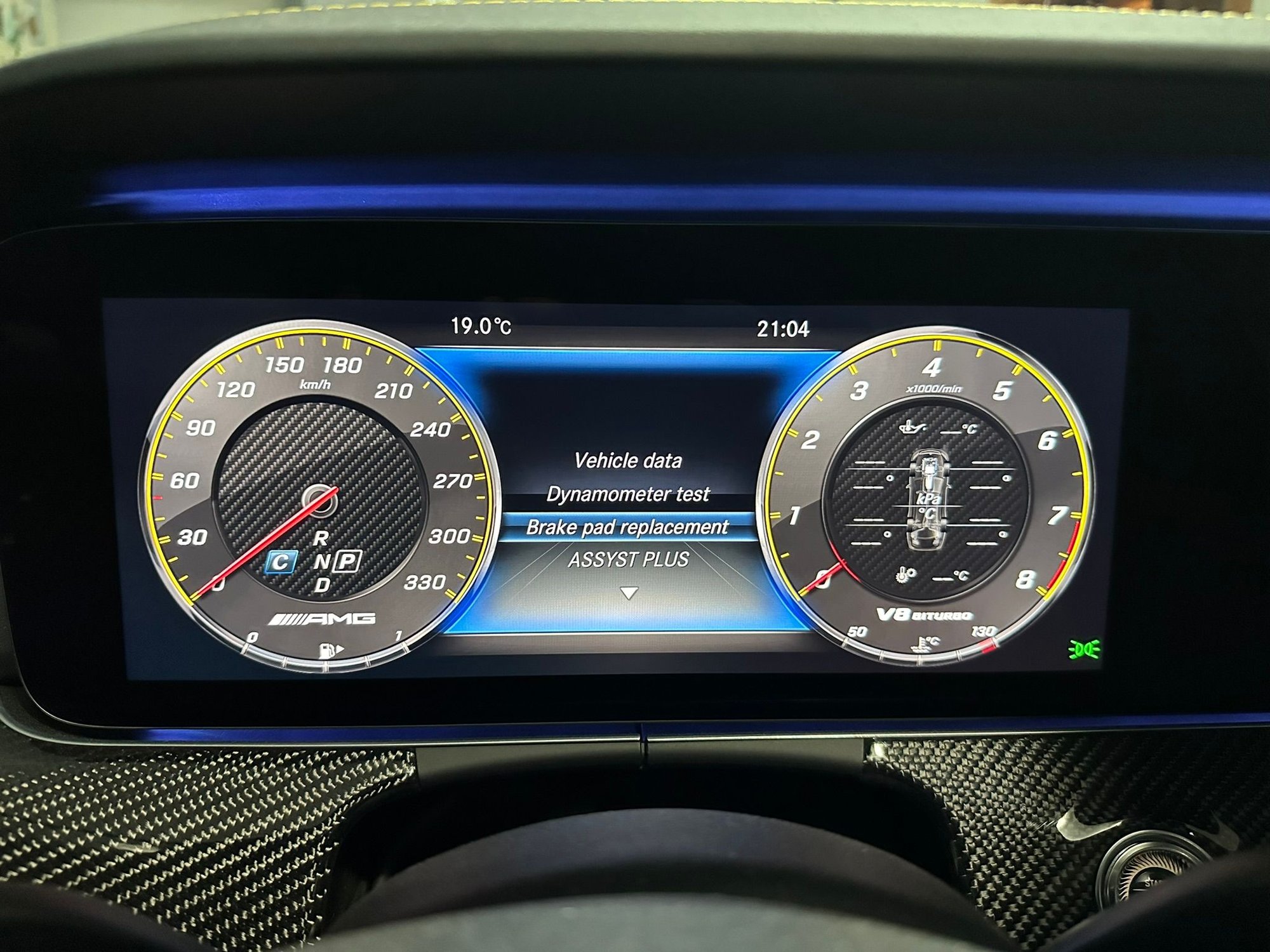

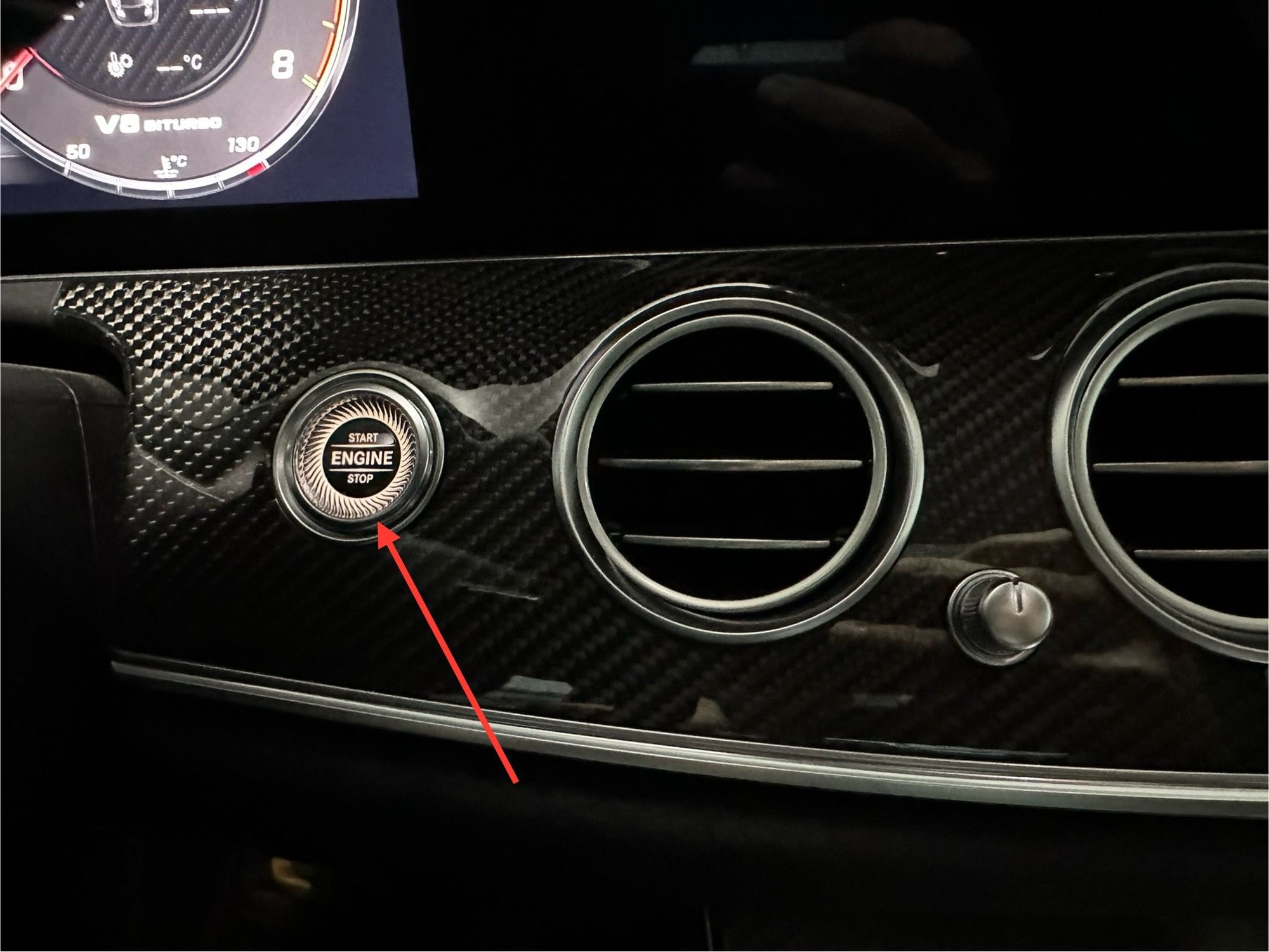

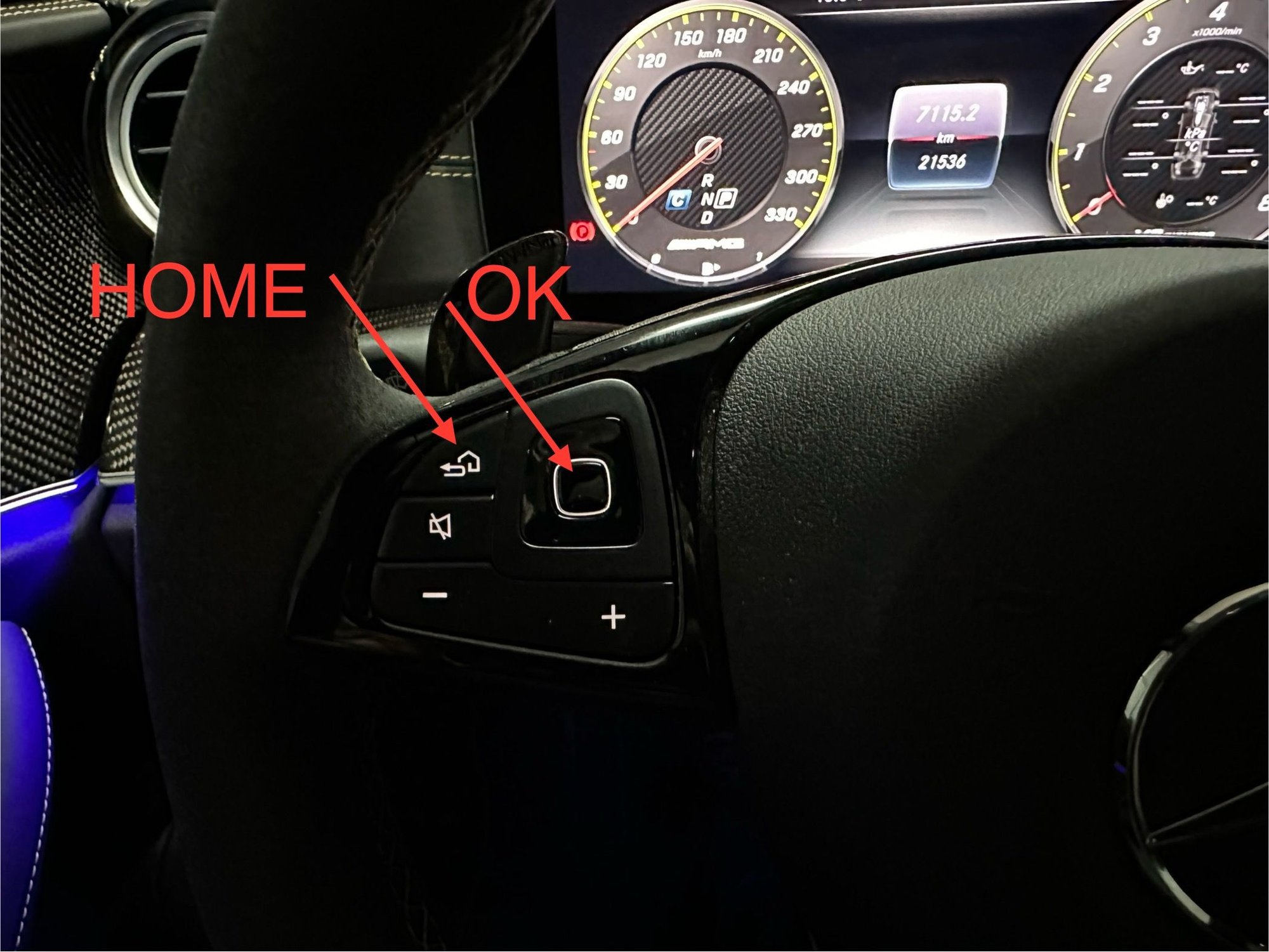

First you will need to retract the parking brake cylinder, this can be done through a hidden menu that can be accessed using the steering wheel controls, to get to the hidden menu you will need to push the start engine button once (without pressing the brake lever), then the left home button and ok button one after the other. This will open the hidden menu, select “brake pad replacement” and then press ok to enter “fitting position”.

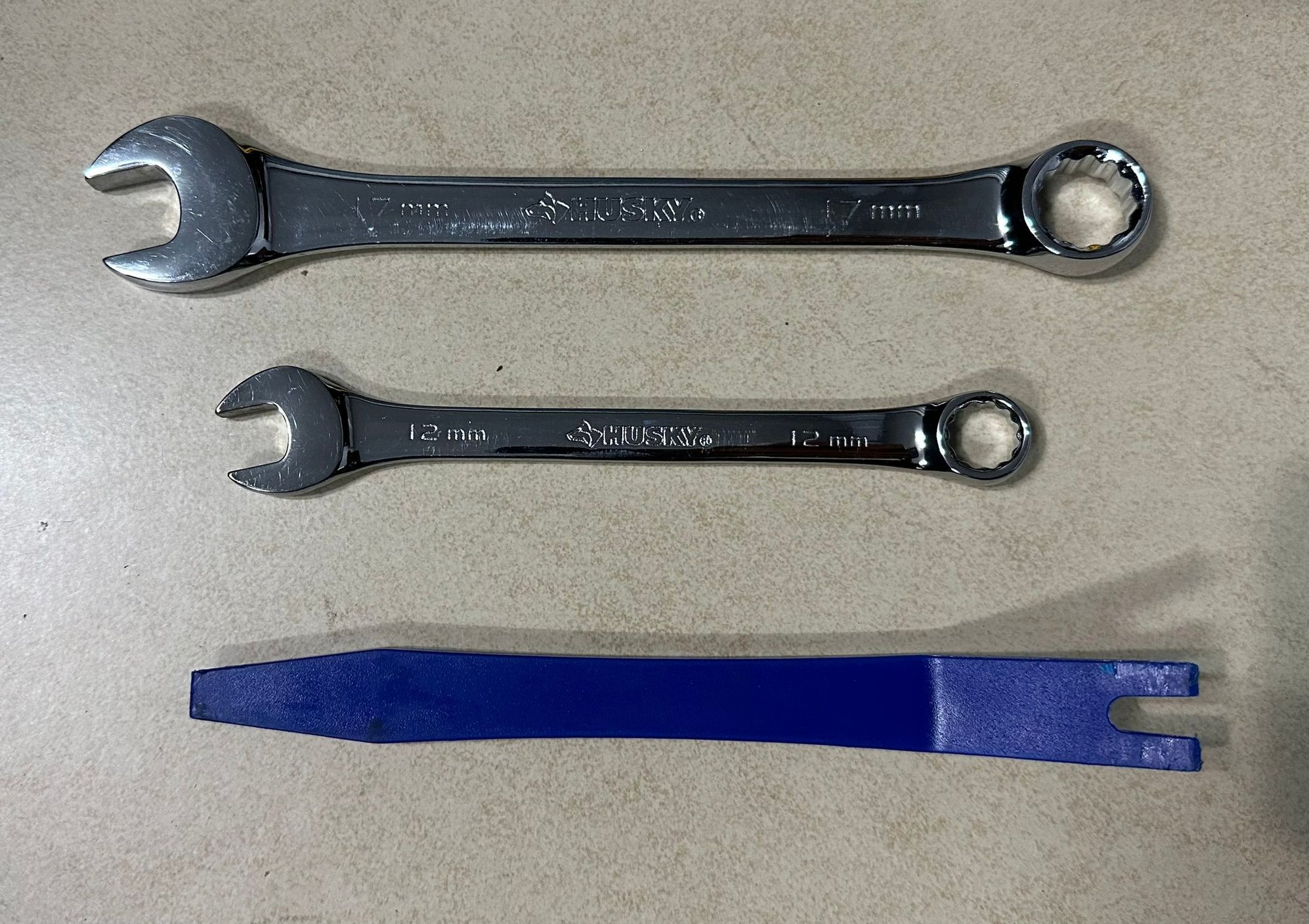

Tools used:
1- 12mm wrench.
2- 17mm wrench.
3- Plastic pry tool.
4- Brake caliper tool.

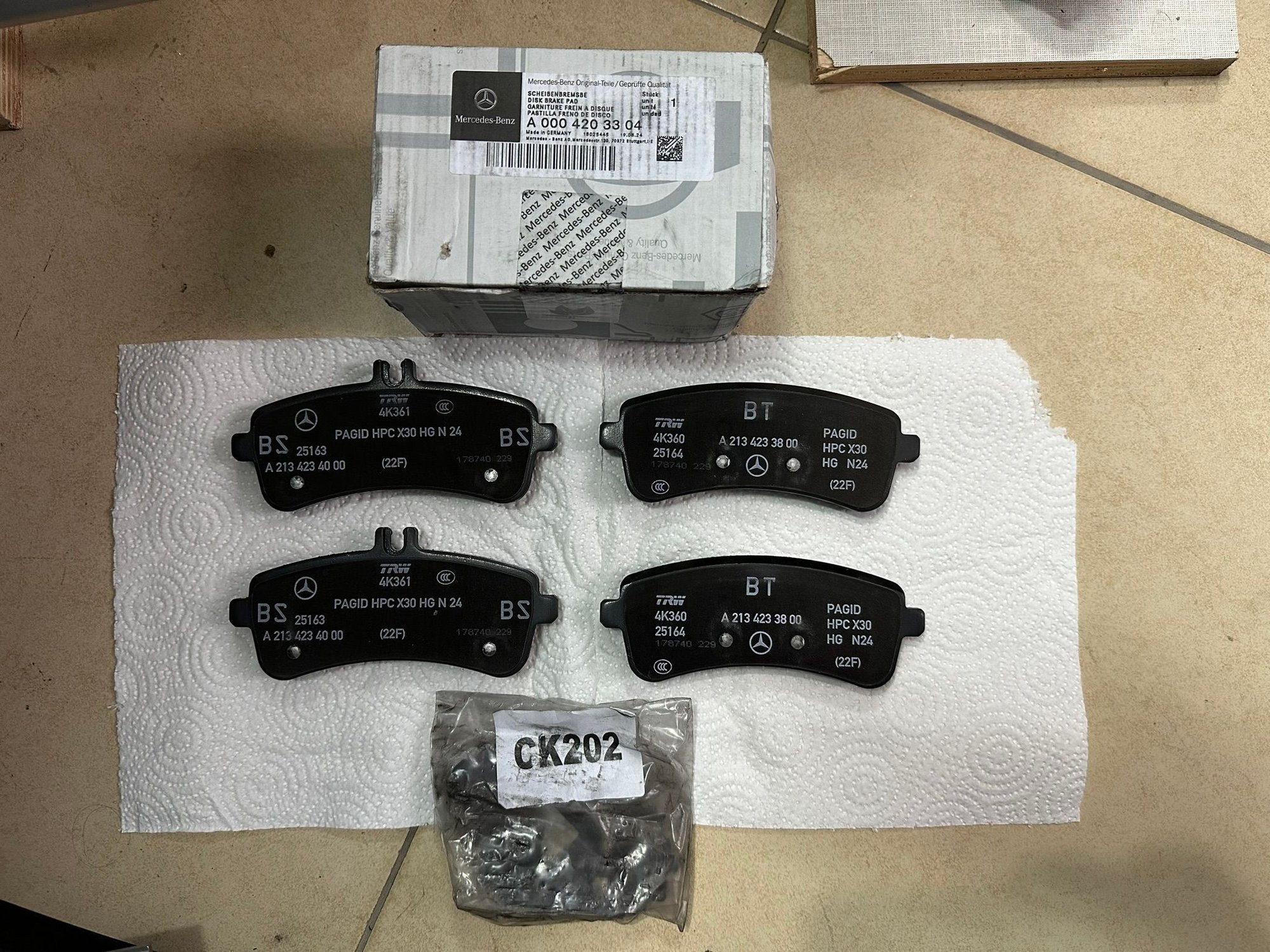

Parts:
1- rear brake pads A0004203304.

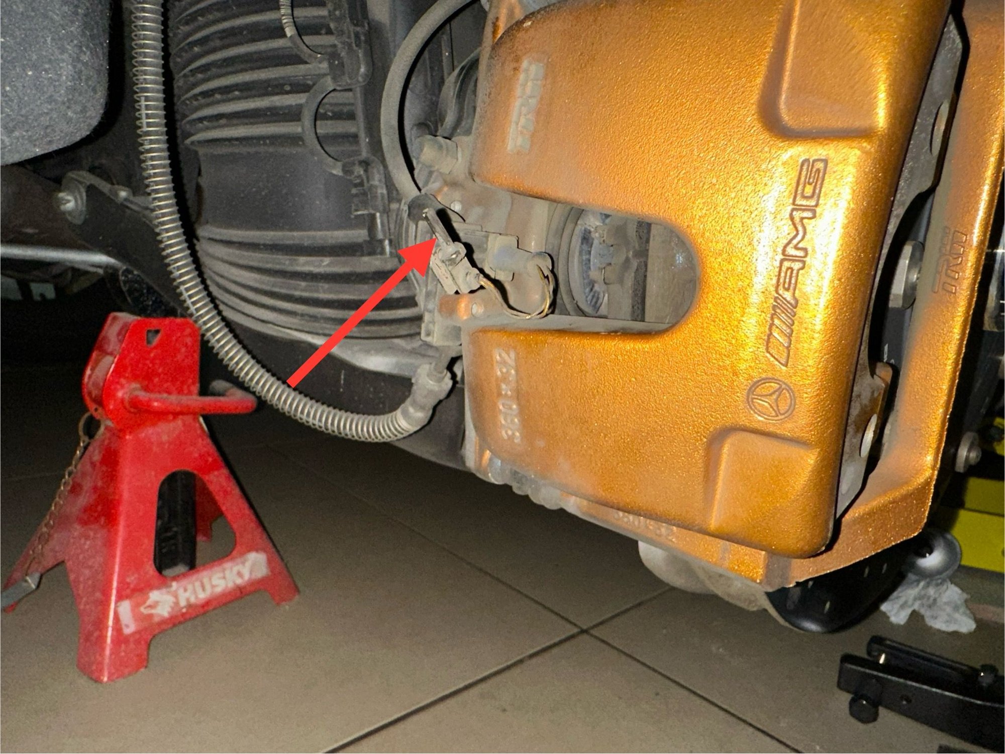

Brake pad replacement procedure:

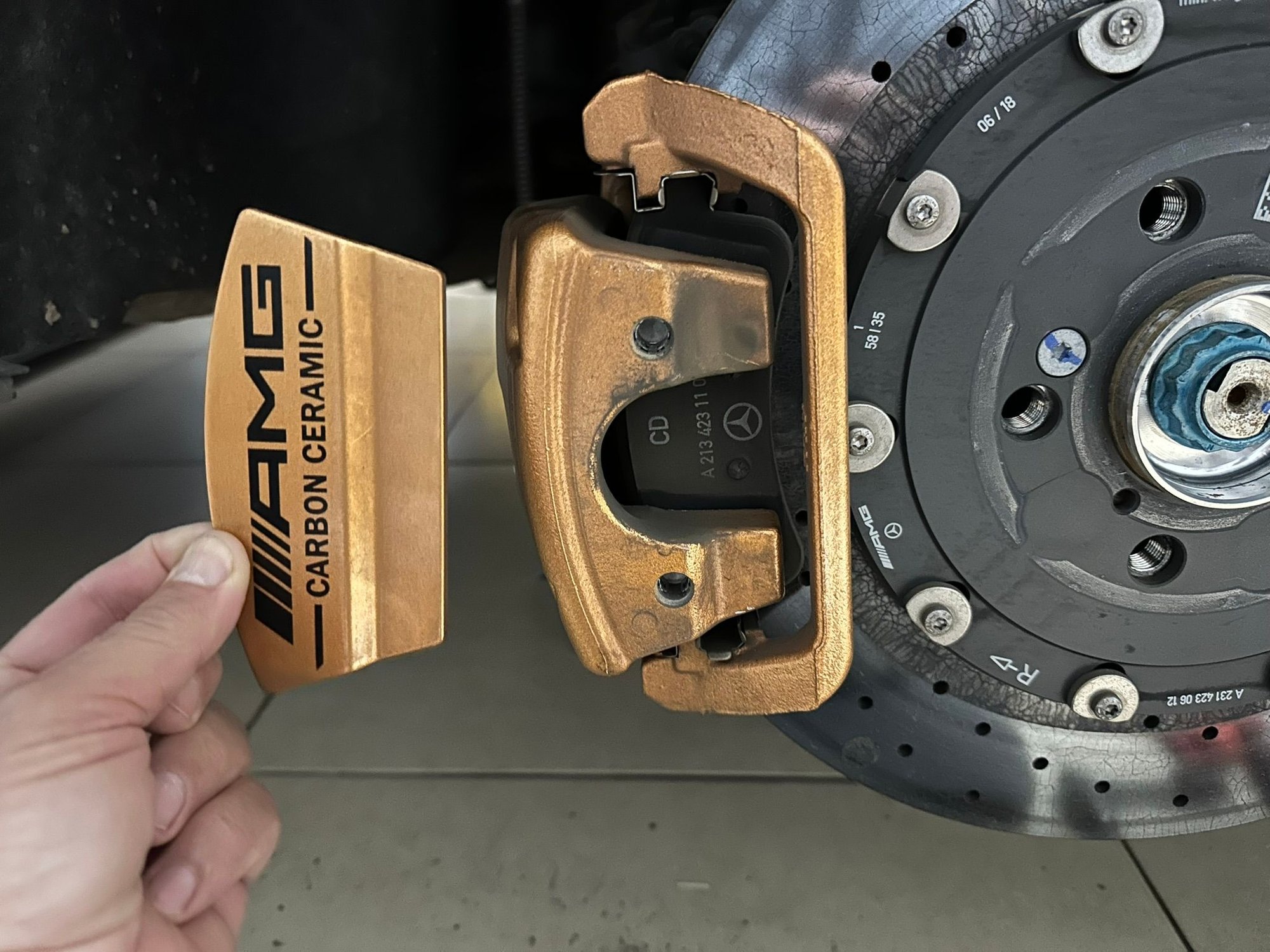

1- Pry off the caliper cover.

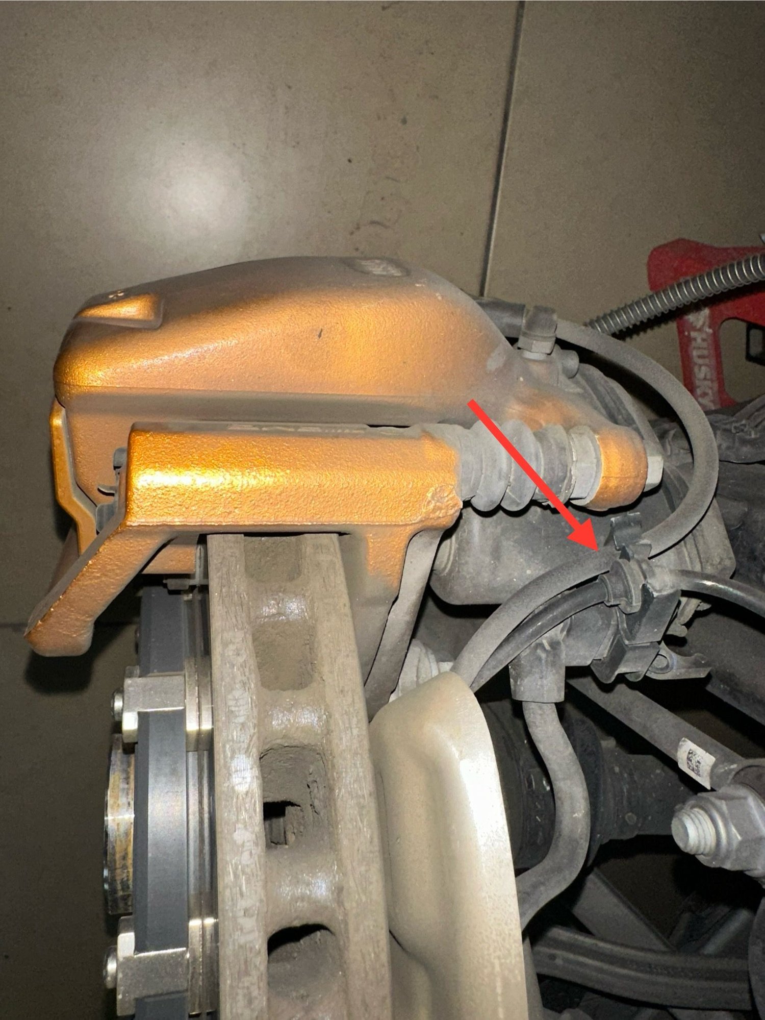

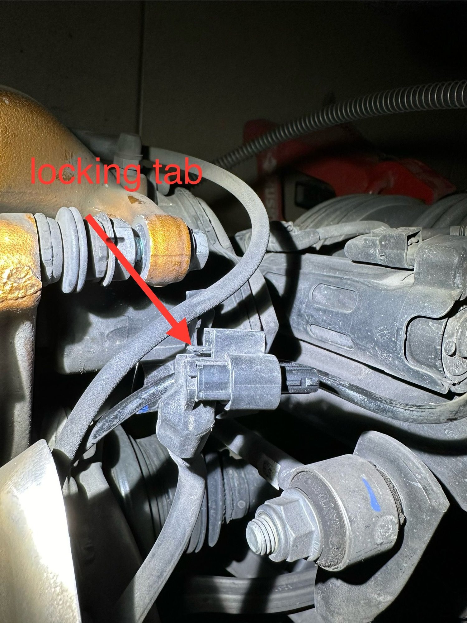

2- Disconnect the parking brake electrical connector by pressing the locking tab and pulling the connector out.
3- remove the two cables from the holding clips so that the caliper can move freely.

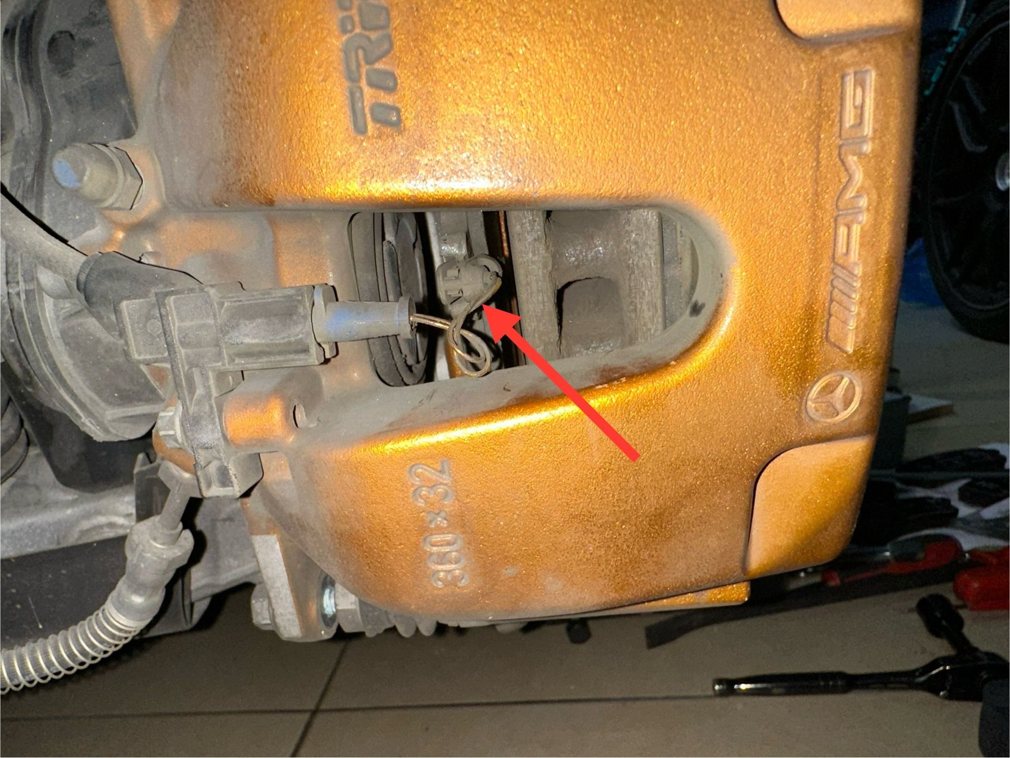

4- remove the brake pad wear sensor by pulling it straight out, no need to replace it if the remaining brake pad thickness is more than the thickness of the sensor pin.

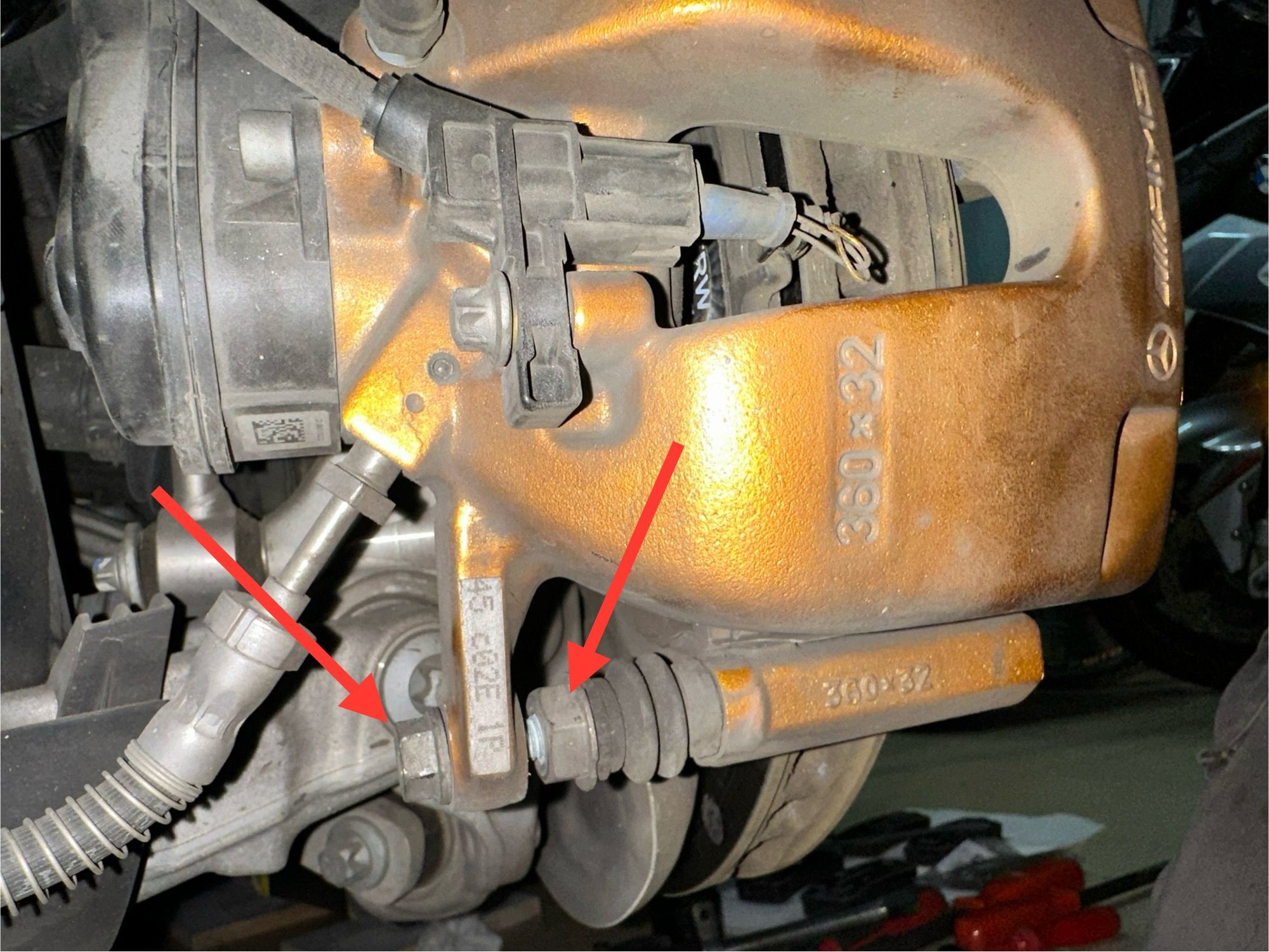

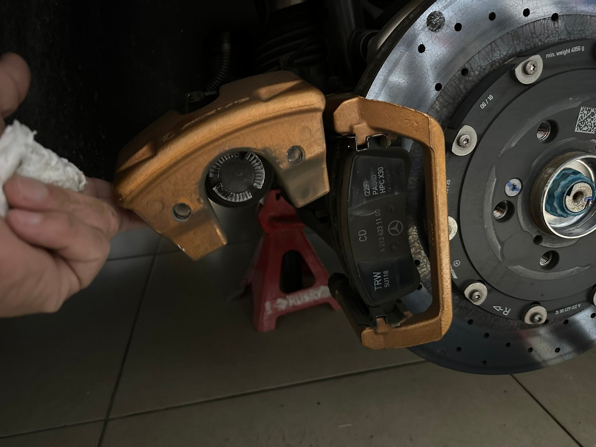

5- undo the bottom caliper bolt using a 12mm wrench and a 17mm wrench.

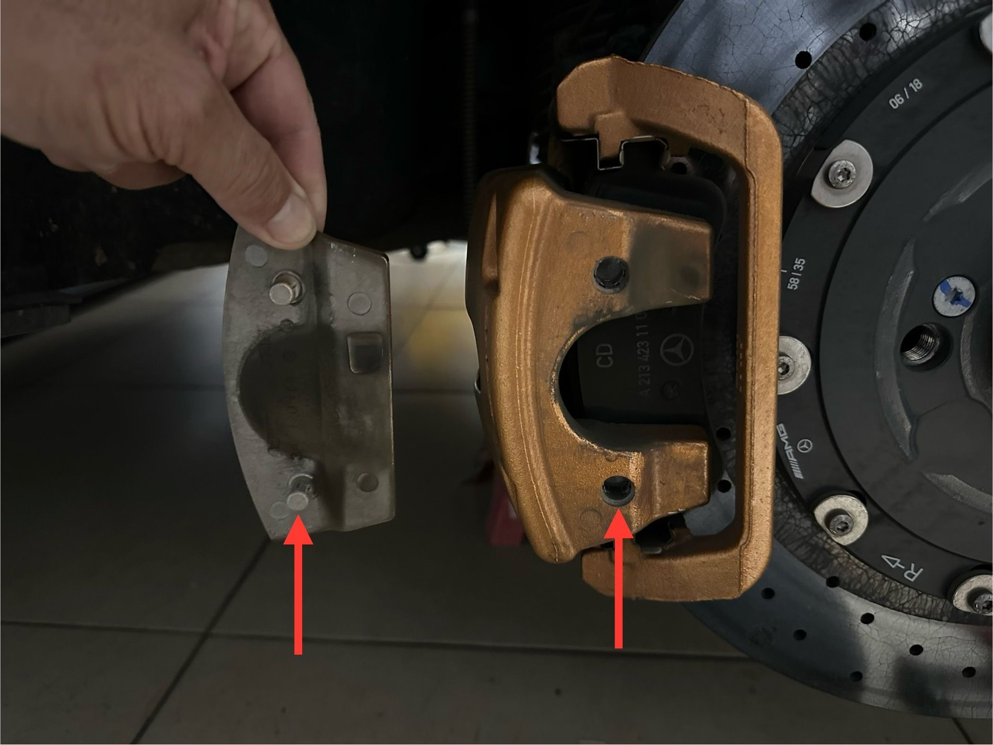

6- now the caliper should be free to move on the top bolt axis, lift the caliper up and remove the brake pads, they easily slide out.

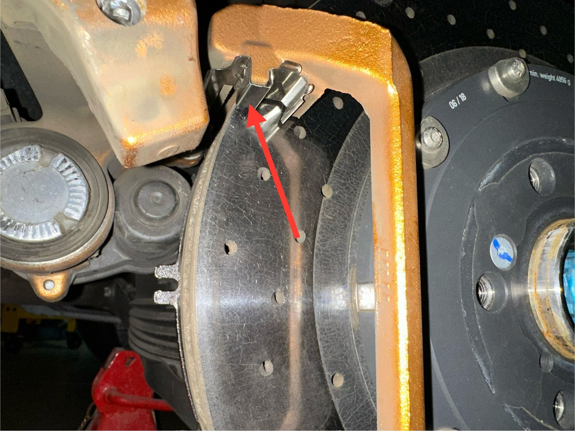

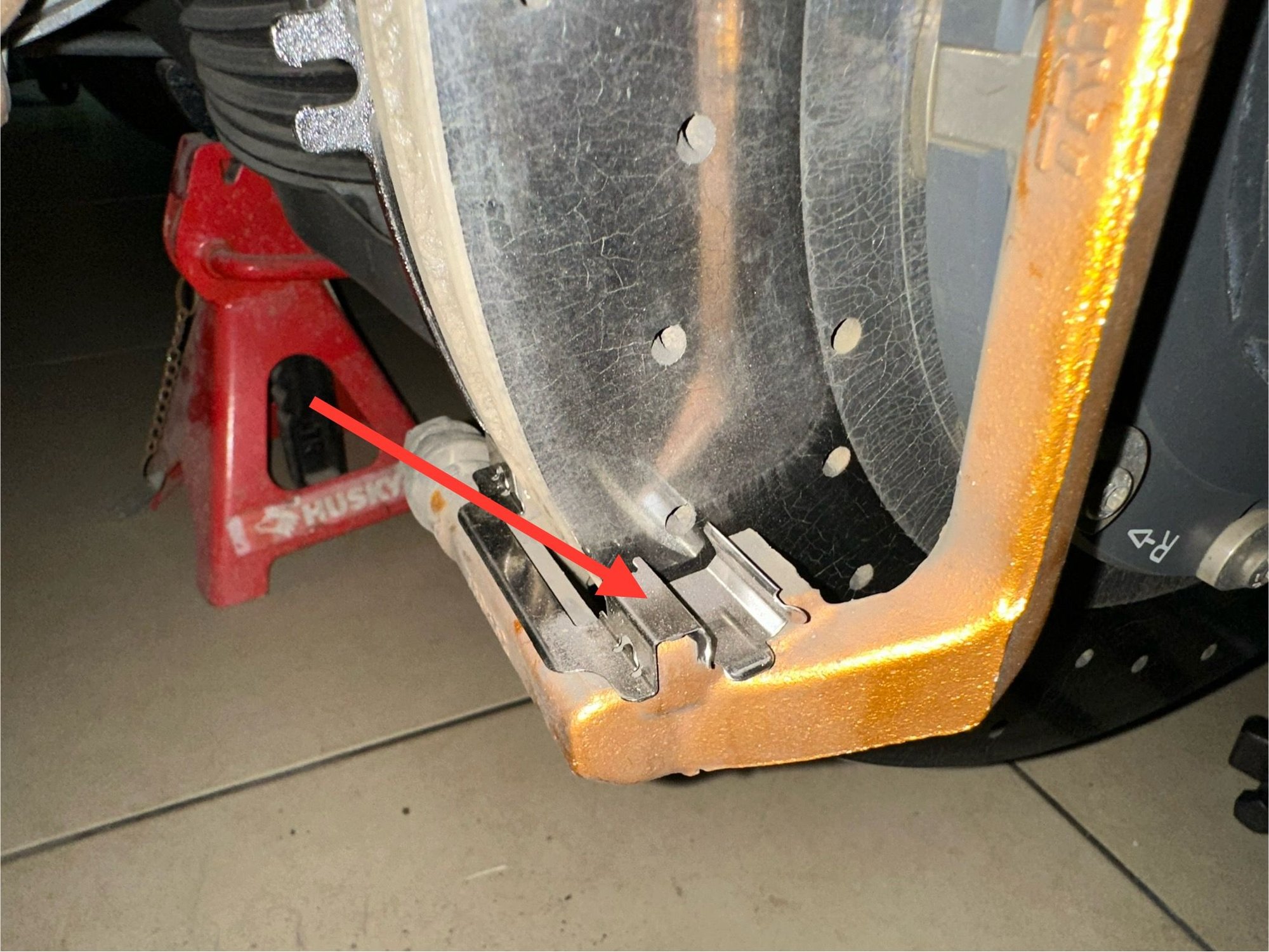

7- remove the brake pad retainer clips, you can pry them out using a flat screw driver.

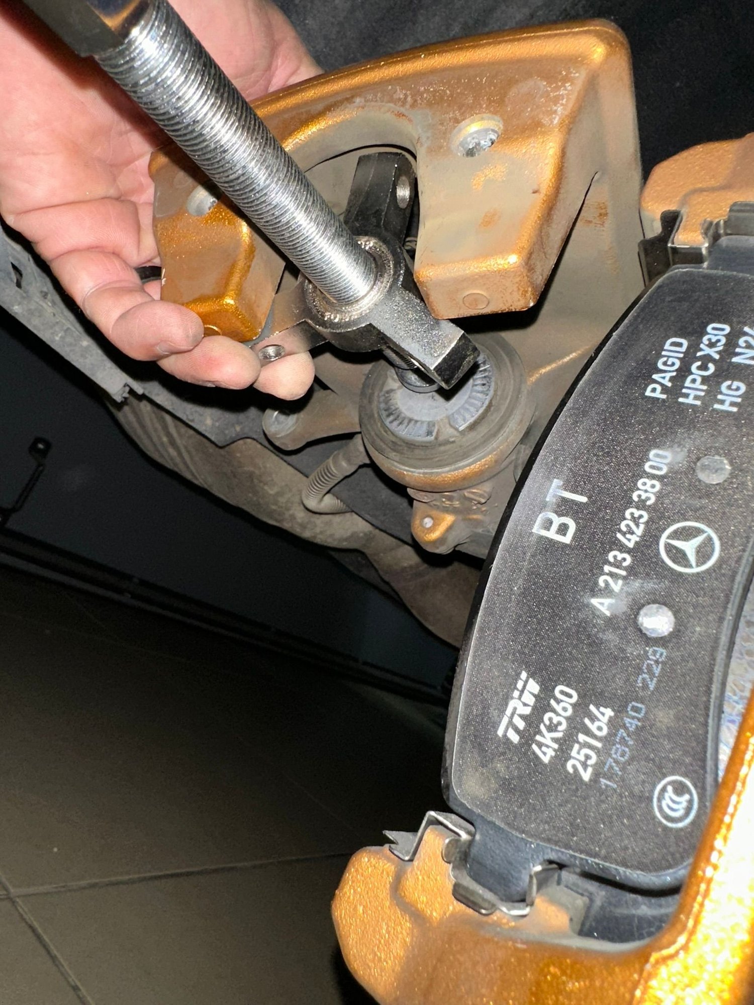

8- compress the caliper piston using a brake piston tool.
9- the installation procedure is the reverse of steps 8-1.
10- exit the “fitting position” from the hidden menu.

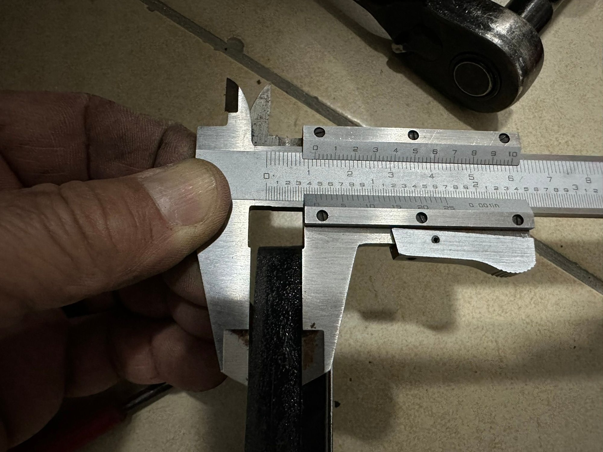

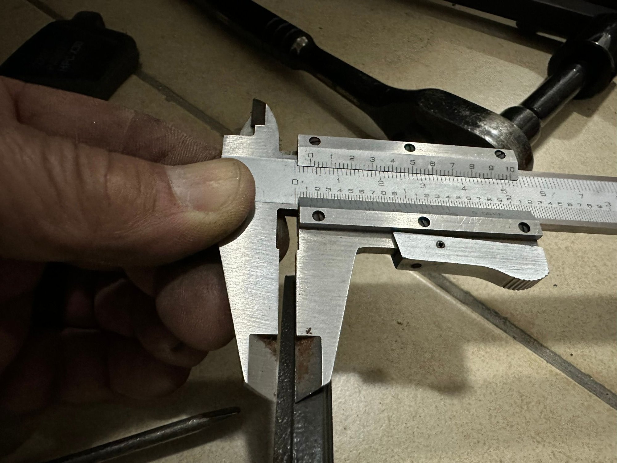

New pad thickness 11.5mm.
Old pad thickness 3.5mm, that’s 30%, next time I will be replacing them at 50%, im not going to take any chances especially since the rotors are crazily expensive.

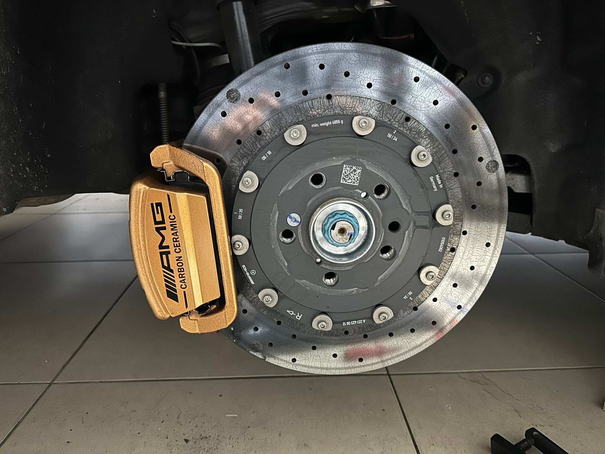

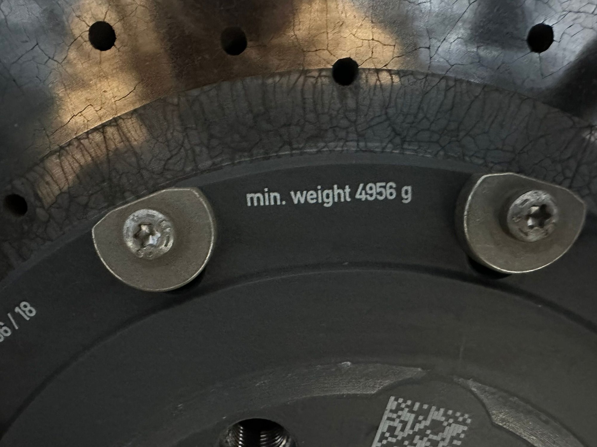

The ceramic rotors life is determined by weighing the rotor itself and not by measuring the thickness of the walls. The rotor is marked with the minimum weight that it needs to be before replacing them, if the rotors weight is under this specific weight it will need to be replaced. On this specific car it calls out “min. weight 4956 g”.
The rotors also have special marks that help with identifying in what condition they are, if the marks are smooth that means they are still in good condition, if the marks become rough that means they need to be replaced.

I did the rears on my wagon a couple years ago, and in a total brain fart I hit "pads fitted" on the dash without the calipers or pads installed on the rotors. The computer proceeded to push the pistons out of both calipers and dump all of the brake fluid all over the shop floor. I got an unexpected lesson on AMG rear caliper operation and assembly, and spent about 5 hours bleeding the system manually as I didn't have an ABS bleed tool / scanner. Not one of my finer wrenching moments

right side rear pads:
inner 4mm.
outer 3mm.
left side rear pad:
inner 5mm.
outer 5mm.
my explanation for the discrepancy is that the TC on the right side will work more than the left side due to the street conditions where the pavement on the right is usually more damaged than the left.
