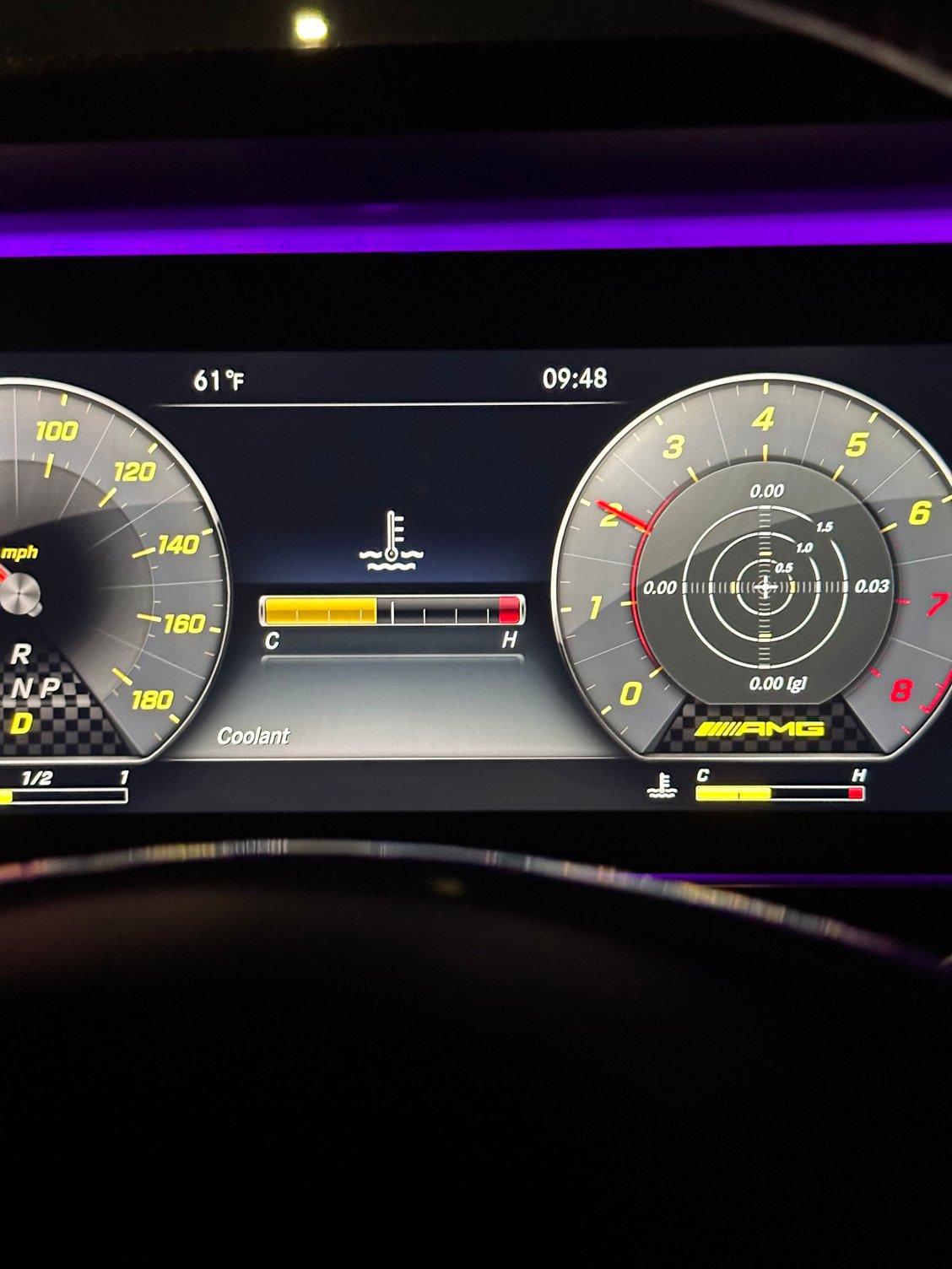

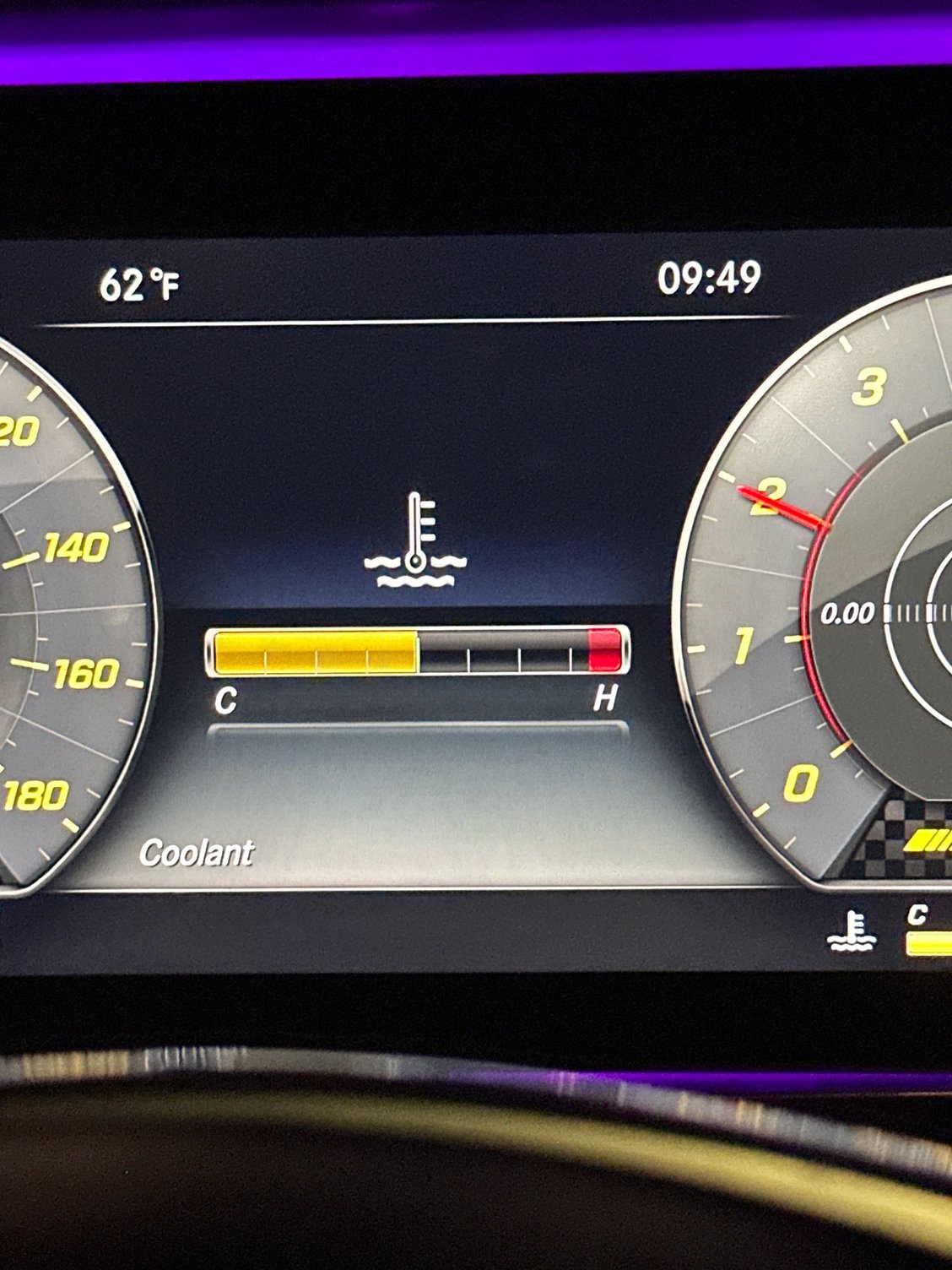

Hey guys i own a 2018 e43 amg. Usually my coolant temperature stays around halfway. Today i noticed that when i was on the highway my coolant temp became colder, when i got off the highway and onto city roads my coolant temp went back to the middle where is usually is. I don’t know if this is normal since i’ve never paid much attention to it. I have attached my coolant temp gauge of when it was cold on the highway and on the city road a minute later where it went back to normal.

Normal. More cooling while at higher speeds on the highway due to more air movement - this effect may be more aggressive in colder weather.

As said, it is normal. Do keep in mind that the gauge is still doctored.

Reason why it is doctored it is because in the past, people complained about the gauge kept fluctuating and thought something is wrong.

not just MB, many makes have doctored gauges and only really start to move higher when the temperature is too hot.

Very true, what i have done i was going through my phone camera roll looking for that little gauge for the coolant and it seems that my coolant used to stay either at the middle or a fingernail passed the middle which is the hottest my coolant still gets now. I am assuming it stays around that area. But does coolant temp change by a couple degrees? I also ask this because today i noticed my coolant went a fingernail passed the middle(which it has done that in the past which i saw in my camera roll) and then a little bit after it went back to exactly on half. so is this normal behavior for my coolant gauge to change by a fingernail on daily use or is it supposed to stay at one spot on the gauge and not move at all. During this drive i drove in sport + where the coolant went up by a fingernail and in comfort where it went to half again. Also i didn’t push the car at all in sport +. Sorry for the information dump. Also my car has no issues getting the coolant to get to optimal temps when i turn it on.
