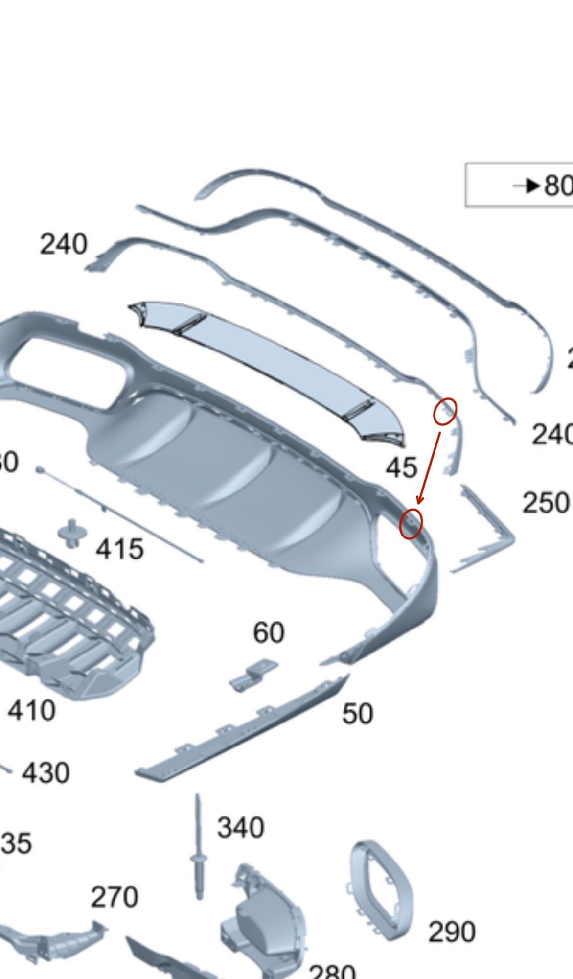

I ordered an OEM carbon fiber trim piece for my face lift 2023 E63S using a VIN number from a final edition vehicle. My car has this trim in black and it appears to be in one piece. The replacement CF piece is in 3 pieces (left, right and center). It would appear that they are just clipped in and a pry tool could get it out. I'm hoping it doesn't have to be undone from behind. Has anyone replaced one of these before?

From the part illustrations it appears to be pressure clips and can just be pried out. I’m not 100% sure though…

I just installed a brand new OEM AMG diffuser recently on my 2018. Even though it is prefacelift this particular piece installs in a similar fashion on your facelift. You'll need to remove the bumper.

I'm happy to report that it was an easy straight forward replacement and it was all done from the outside without the need to remove the bumper. Just some pry tools and patience! The original piece was one long single piece, and the CF replacement is 3 pieces and they just snapped in perfectly
