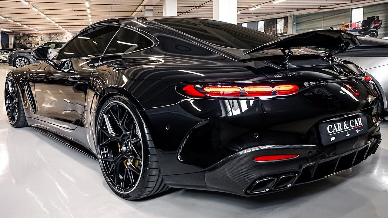

Hey all, the other day I saw a brand new 2025 E53 convertible which had the new AMG wheels that were first seen on the new AMG GT (pic).
Anyone know the name of the wheels and specs? I’d love to get my hands on a set if they fit the E63 wagon

Those do look pretty nice. Wonder how they'd look on an E63? Part number: A1924011300 (I think).

looks like it, part ending in 300 appear to be the front
rear are 400
Who’s gonna try them out first?

AMG GT wheels will not fit the w214 e53 at all. Wishful thinking 😊

They come in different specs. I saw them in pics on an AMG GT but then I saw a 2025 E53 convertible in person with the same style wheels in 20” which may (?) fit the W213.
I’d love to get a set and put them on my E63 wagon

These are the CLE53 sizes for those wheels:
20” AMG Cross-Spoke Forged Wheels, Grey
265/35 R20 on 9.5J x 20 ET19 wheels (front)
295/30 R20 on 11J x 20 ET24 wheels (rear)

Wondering if one of the offset lords knows if these will fit a W213 E63S because they are TIGHT

true. the w214 e53 does have an option for this "style".
I thought if you want those exact AMG GT wheels onto the E53, then it is a no go.

thank you for correcting me, I meant CLE53. Those specs sound like they might fit…

2364013100 & 2364013200
RIMS SIZE FRONT 9.5X20 ET19 REAR 11X20 ET 24.1

Taking a known setup for an E63
Front Wheels: 21x10, Offset 12
Rear Wheels: 21x11, Offset 48
And plugging them into Alloy Wheel and Tyre Fitment Calculator. Offset, Tyre Stretch and Speedo Error | Will They Fit
The fronts maybe fit on the front of an E63 by using 30mm spacers
The rears won't fit on the rear unless you remove 15mm from the mounting surface (reverse spacer)
The fronts will fit on the rears and using 305's be within 1mm poke of the above known setup (known being Rear Wheels: 21x11, Offset 48)
So if you had an E63 you could potentially buy 4 fronts, and maybe use spacers for the front axles if the 10.5" cleared the suspension. It's only 5mm more room required vs. a 10" wheel. Anyone with 10" wheels - how close is the inset to stuff?

easiest solution (obviously) is to just buy this gorgeous AMG gt pictured here. Done and done.
