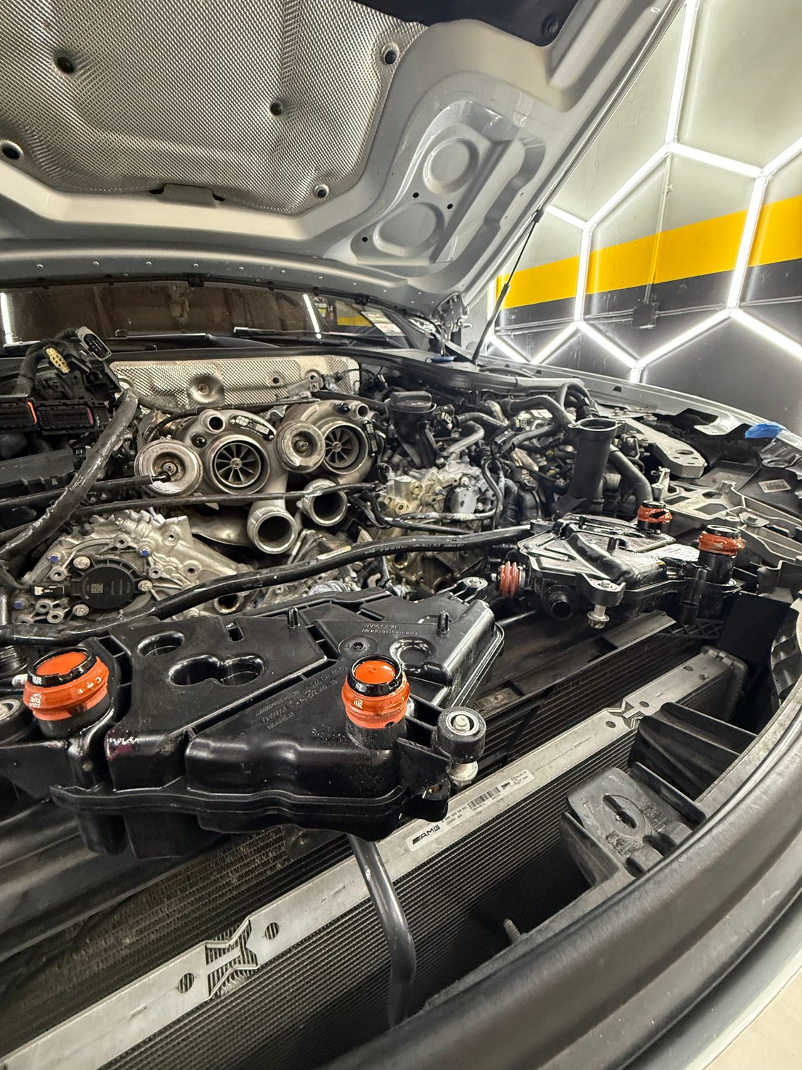

Had a client come to us here in Florida after having Hpfp upgrade, aftermarket turbos, tunes etc on his 2018 e63
he mentioned he was told he had a big oil leak from his turbo oil lines. The drain lines aren’t too easy to see clearly without turbos removed so I verified oil was indeed originating in or around this area around the top of the engine and agreed to dig into it

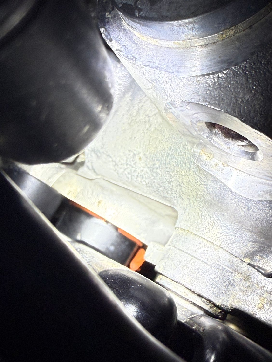

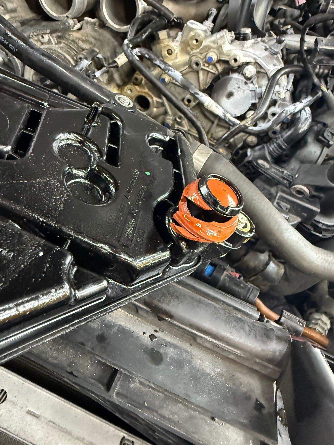

i have seen and replaced rear main seals and crankcase breathers before but this is a failure I haven’t seen before. It looks like the crankcase was overpressurized to the point that instead of blowing out the RMS, instead it blew out the seals of the crankcase breather boxes where they plug into the crankcase
the orange piece off to the side (right side) is a broken piece of the orange seals from the breather boxes
thought I’d share since I haven’t seen this mentioned among any of my old mb dealer tech coworkers or amongst the aftermarket world. Will be recommending new crankcase breathers and possibly an aftermarket PCV system to help cope with the pressure building in the crankcase

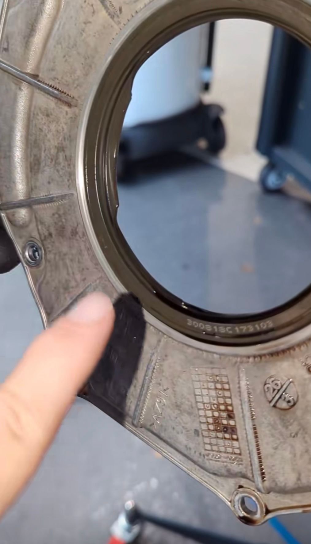

im not sure where the “seal sucks in” narrative comes from… in normal operation, front and rear main seals are folded inwards against the crankshaft, it’s why you need a special tool (or Mercedes is kinda enough to include a plastic guide in the rms trackage that doubles as an installation guide) to prevent the seal from rolling(flipping outwards) as it slides over the crankshaft. The rear main seals ive seen that dump out oil are blown outwards from what appears to be an over pressurization situation. You’ll see about a one inch long section of the seal curled outwards and after that it never holds oil properly again

Aug 10, 2025 | 05:30 PM
this photo I found online shows how I typically have seen the rms to fail on these
