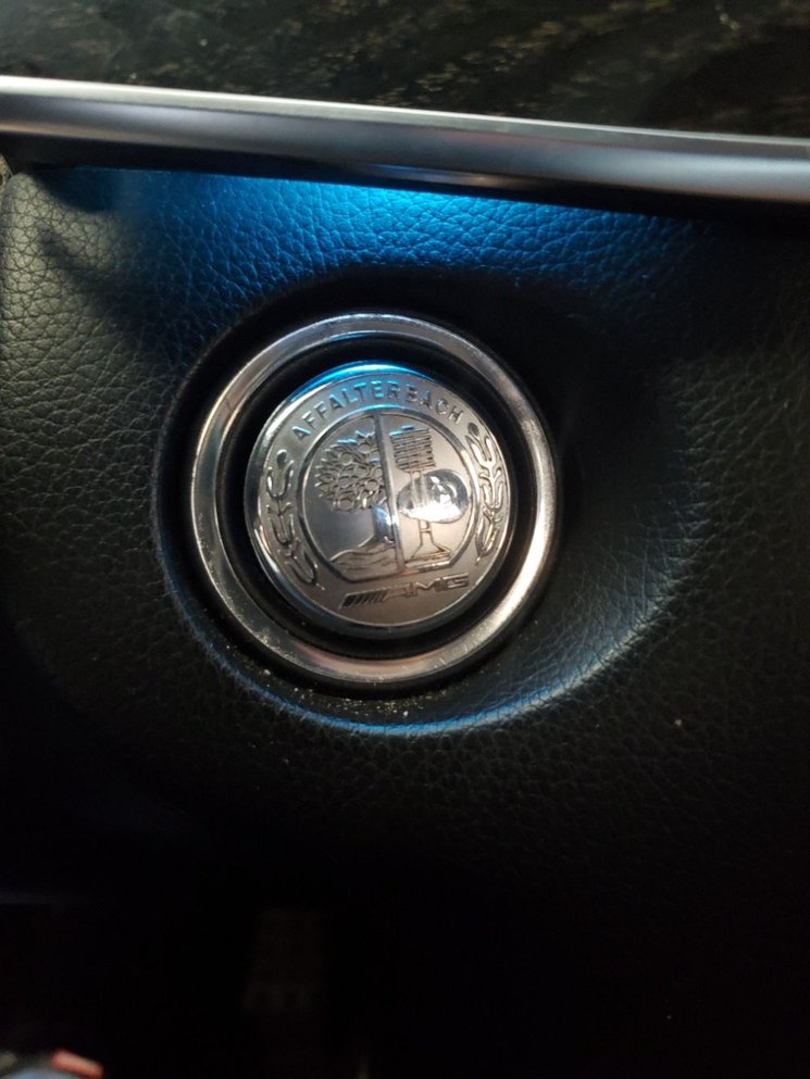

Very short story
The button of a AMG GT fits insides the E/CLS/GT dash without issues.

Originally Posted by figuwx
Very short story
Do you mind posting a side by side comparison, I must be blind but can't tell the difference.

Can you confirm if that one glows red? Will it fire up or does it need to be programmed?
that one is supposed to glow red. Stock glows white

why is there no photo of the button lit up red?!
because I am not going to test in my car...no one knows if it needs coding and since I do not have anything to code incase it needs it, will not test at this point.

Originally Posted by Sathinas
Either it will work, or it won't and will need coding. It won't set the car on fire.
but since it part of the start function (EZS module) it might trigger a no start and worse off, anti-theft and now dead in the water... no thank you.
You're half way there! Hook it up and tell us if it'll work! Like the other guy said, it'll either turn on or not. Curious if that one will light up red too, wonder if we have the right part number per the original discussion

Can you upload a picture of the electrical connector on the switch?
Don't have WIS/DAs with me, but maybe someone with quick access can look at the pinouts and see if there is data being transferred through any pin on the switch?

A recent post in the W463A forum describes replacement of the start switch that had developed a cosmetic defect on the switch's surface. Ask the OP if there was any coding issue.

Update on this - guy on facebook did it and it works without coding. Part number 1909054002
