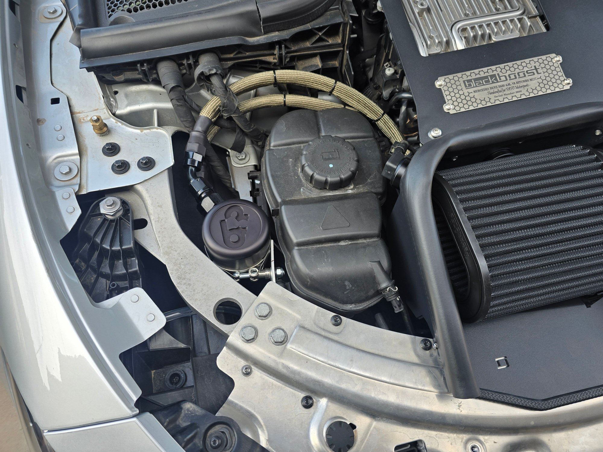

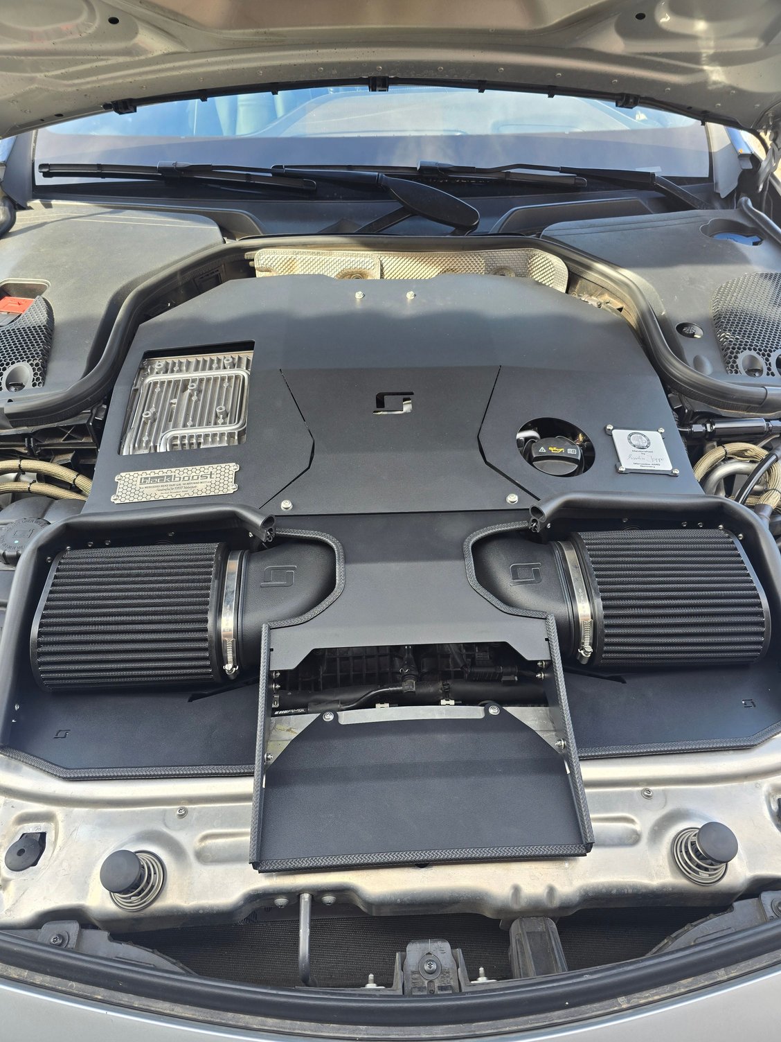

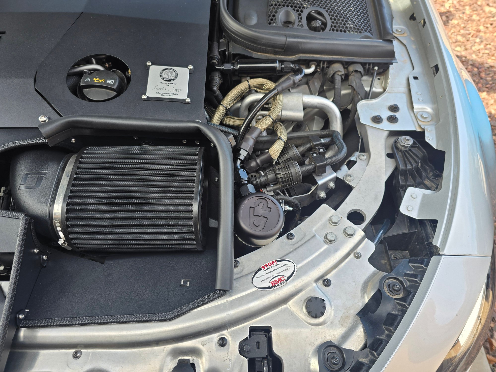

My car is a 2019 E63s.
RMS and Upper oil pan gasket was replaced at 36k miles. OVS were tested and deemed "operational".
Both OVS and a complete right side valve cover seal R&R performed at 46K miles after oil started leaking in a spark plug hole.
Car is tuned: (ECU, CPC, TCU) catless downpipes, Black Boost Gen 2 Intakes, Spool HPFP, runs on E30.
CC's were installed at 46.5K miles.
Car is not a daily driver.
Since my car is tuned, has a newer RMS, brand new OVS (both) I believe I am the best test subject for this, and I will update this thread as I perform maintenance ect.
I purchased the cans and they were sent very quickly. They were wrapped and packaged very well. From my first impressions. The CC's are built really well. All the components are really good quality. I do question the layout of the can itself, and believe a better revision for emptying them could be engineered. I also have my reservations about the one way valve on the bottom vs longevity against leaks.
After reading all of the instructions, I decided that I was not going to get involved with the install, and had a performance shop install them. I asked the tech, who installed them how it went. His response was, they are pretty involved. If you are going to DYI read the instructions and take that how you will.
I also had Black Boost Gen 2 intakes installed while I was there and the car was re-dyno tuned. If you are a Black Boost Gen 2 owner, it does make the install a bit more difficult because the BB intakes take up more physical real estate under the hood. Just keep that in mind. I don't know if it affects the BB Gen 1 intakes, or any other intakes for that matter.
Fitment seems good. I put a piece of rubber between the driver side CC and the front support. I will see if I can work on that later. I also removed the BMC air filter sticker as well.
Feel free to ask questions or comment and I will do to the best of my ability keep everyone informed.

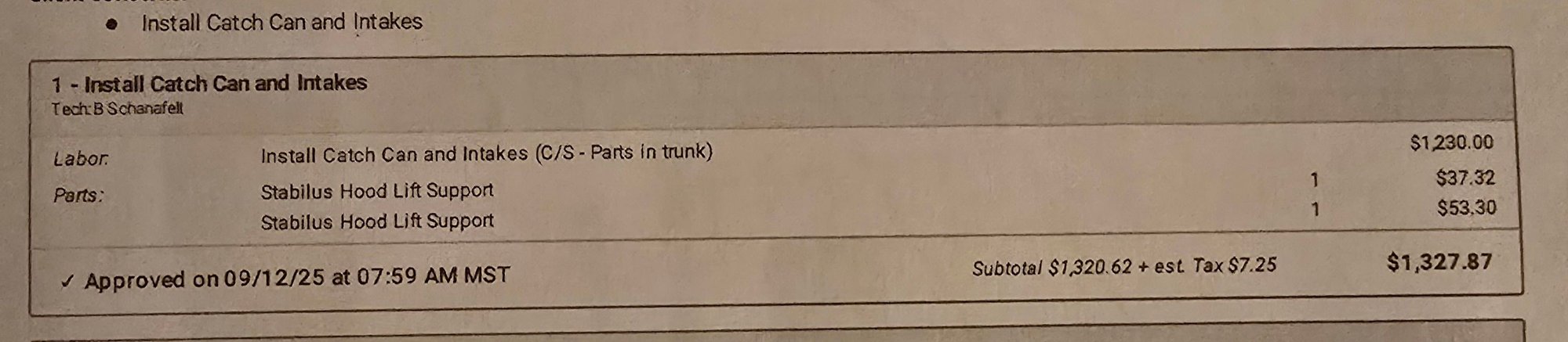

Question for those of you who've had this installed by a shop: how many hours did they need/charge? I'm getting a variety of estimates, anywhere from 2 all the way up to 7 hours.
Depends on how good the tech doing the work is. I have my work order at home. I will update here on the price, but it wont be a direct comparison because of shop rates ect. I do know installing the cans were a pretty intensive install for catch cans per say.
Old Dec 9, 2025 | 10:05 AM
SM105K's Avatar
Joined: Jan 2021
Posts: 232
Likes: 139
From: Arizona
2019 E63S and 2014 CLS 63S
This is what I was charged for my catch can install. I would probably take about $300 off because of hood struts, and the installation of the Black Boost Intakes. So realistically, I would say $1000 is pretty close and possibly a good representation of what it would cost for them to be installed.

Thanks for sharing @SM105K . Found a performance modding shop that will do it for 1K, glad to know it's a reasonable figure. Now I just gotta hope my RMS doesn't blow between now and next Thursday :P
