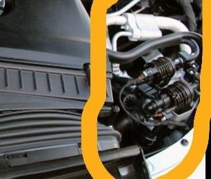

at least trickle charge your battery all the way up and see what happens (Case example)
purge valve part numbers (Sticky):
https://mbworld.org/forums/w213-amg/...ml#post9203757
https://mbworld.org/forums/w213-amg/...ise-fixed.html

I had this same exact problem (CEL, sometimes the gas cap warning (I replaced the cap and seal first thing))... the car would shudder sometimes like it was in limp mode until I restarted it. The dealer was throwing out all kinds of issues. My Indie guy on Long Island fixed it in ten minutes by replacing the purge valves.
It is caused by topping your tank off beyond when the gas station pump shuts off. Essentially we are pushing gas back into the valve and over time they fail. $160 in parts and labor.
Here is a pic of the parts. (2018 E63S Wagon with 55K mileage)

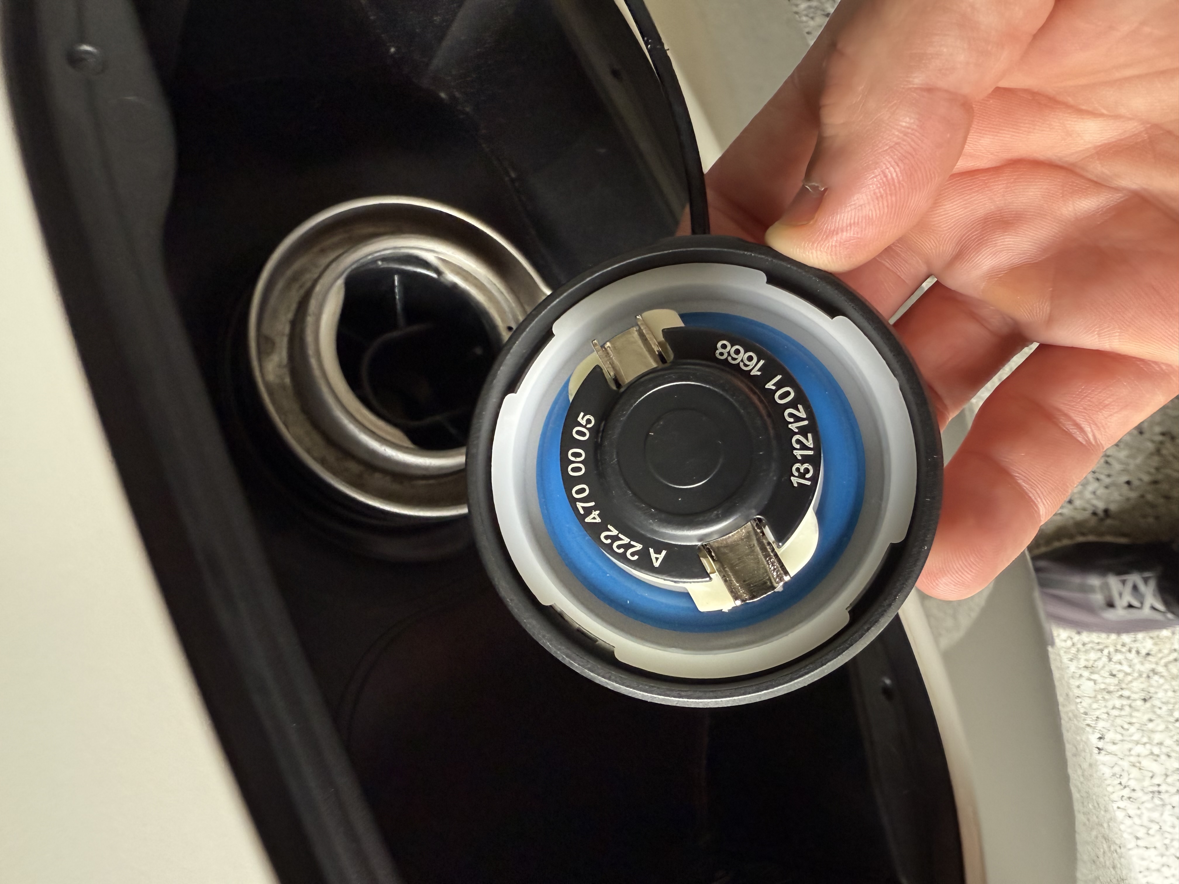

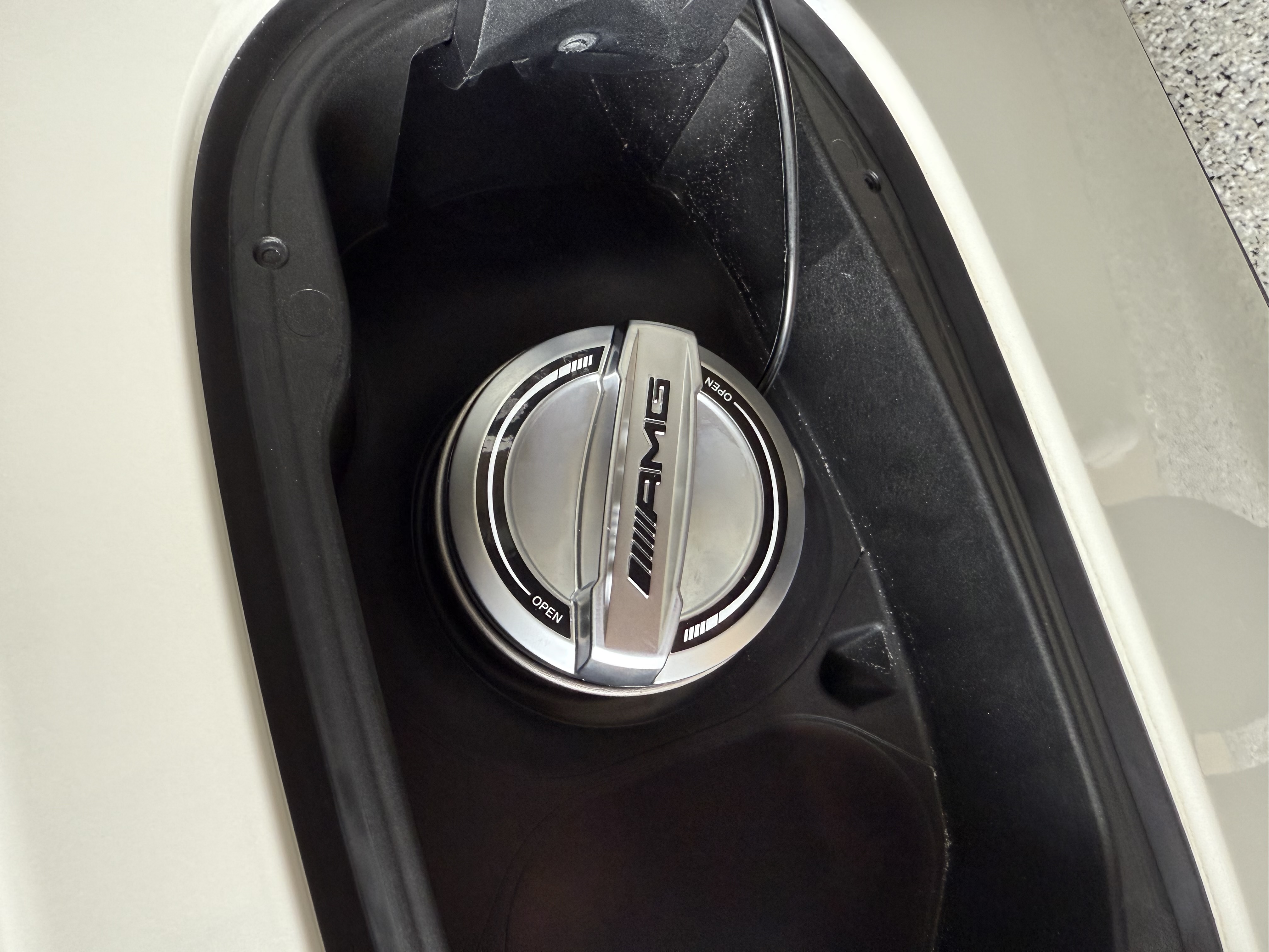

Upgraded my gas cap to AMG cap....now have check engine!
So WTF?!
Just to treat the Wagon, I decided to purchase an AMG gas cap. Prior to swapping out the original cap for the AMG one, I had NO codes, NO CEL and NO "loose gas cap" warnings. Now I'm getting intermittent loose gas cap warnings, and just today a CEL. I checked the gas cap for tightness, shut the car of for 15 minutes and still have the CEL. How is it that just swapping out my gas cap can lead to these issues? I have since put the original non-AMG cap back on in the hopes that all returns to normal(?).
I need a sanity check.....🤦🏻‍♂️
Mike

there were some defective ones, deep breath:
https://mbworld.org/forums/c63-c63s-...ap-messag.html
https://mbworld.org/forums/w213-amg/...ap-issues.html

FML
That would be just my luck.
I disconnected the negative battery terminal for 15 minutes and even with the non-AMG cap back on; still have the CEL.
This is so asinine.

it'll clear - drive a bit or use a scanner to clear it
