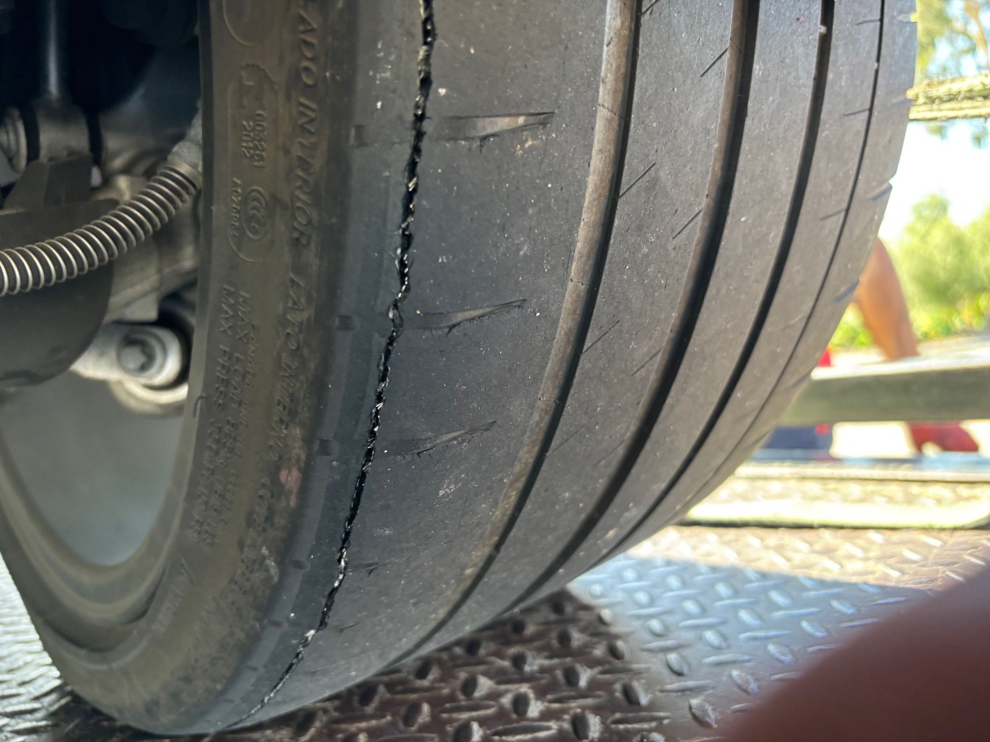

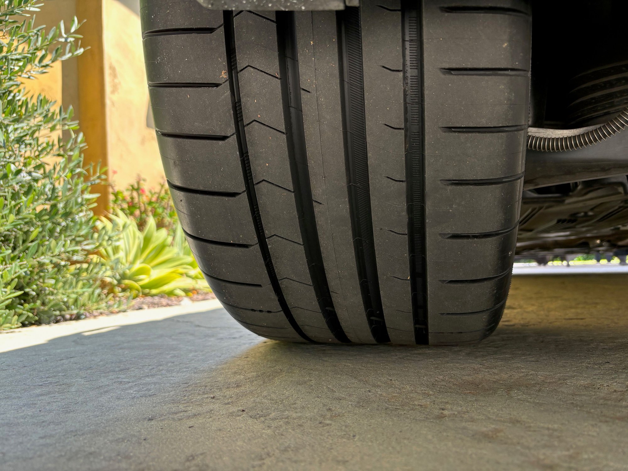

I would really check the inner corner of the tire near the sidewall. The rear has camber and the tires wear there first. My tires looked fine across the width of the tire and I thought I had another 10,000 miles of wear left on them when my pressure started going down on one of the tires. Thought I picked up a nail. Used the pump to bring the pressure back up and then limped a mile or so away to a nearby discount tire shop. They came out and looked and showed me that the inner edge of both rear tires were down to the cords and that's where the leak was coming from. Said it was really common on European sports sedans.
Called Mercedes and they arranged for a flatbed tow truck to bring the car to my dealer for a new set of PS5s. Tow truck driver said the same thing, he tows Euro sedans for the same issue all the time.
Can't really see the problem standing next to the car or looking at it from the rear. Need to bend down and look under the car closely at the inner edge of the tires.

That is what happened to me on my passenger right front tire. Tires look great and the inside was smoked. My only saving grace was I bought a forged set of rims that came with pretty new tires, and when I went to change them I saw how bad that tire was.
