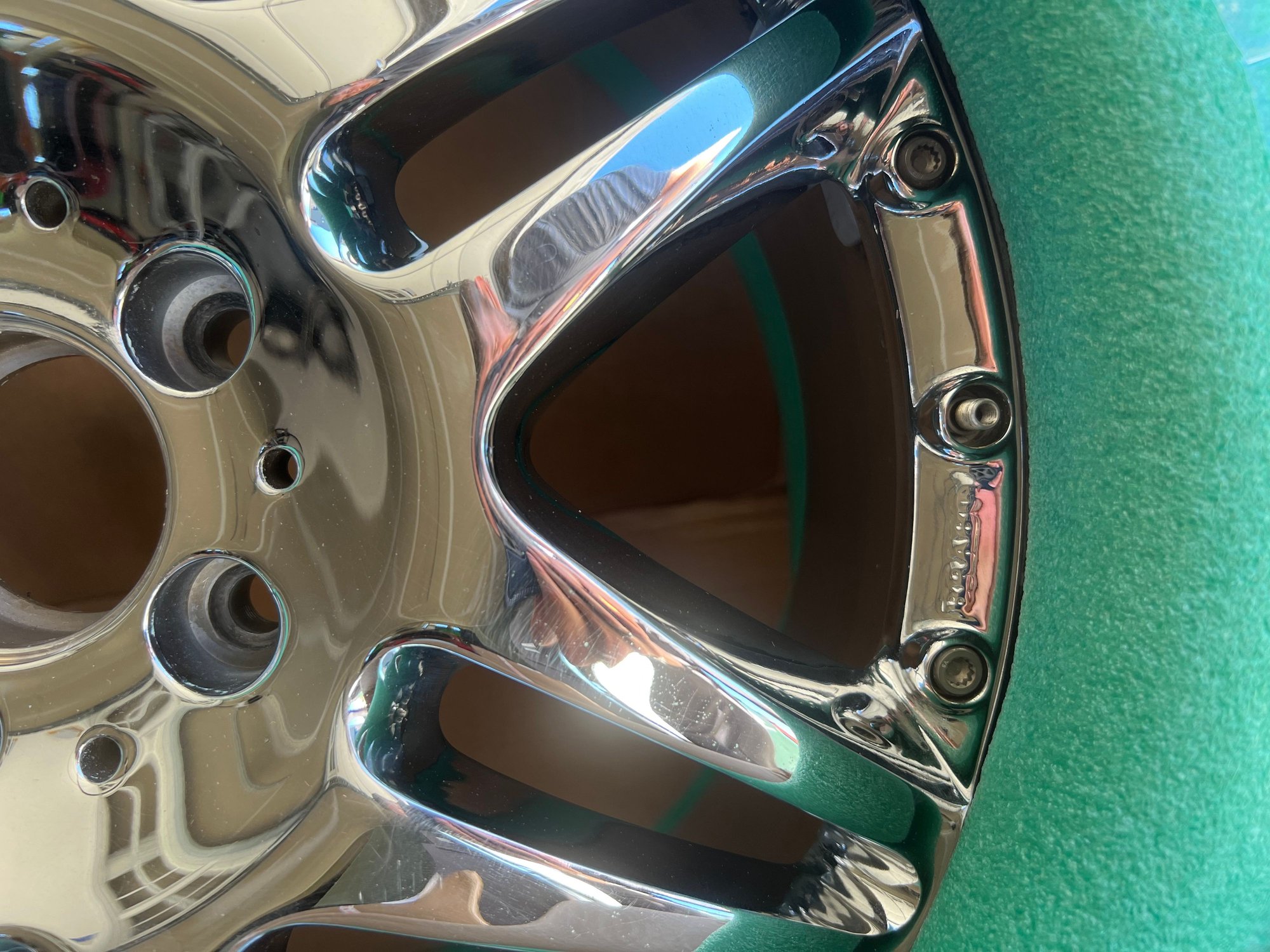

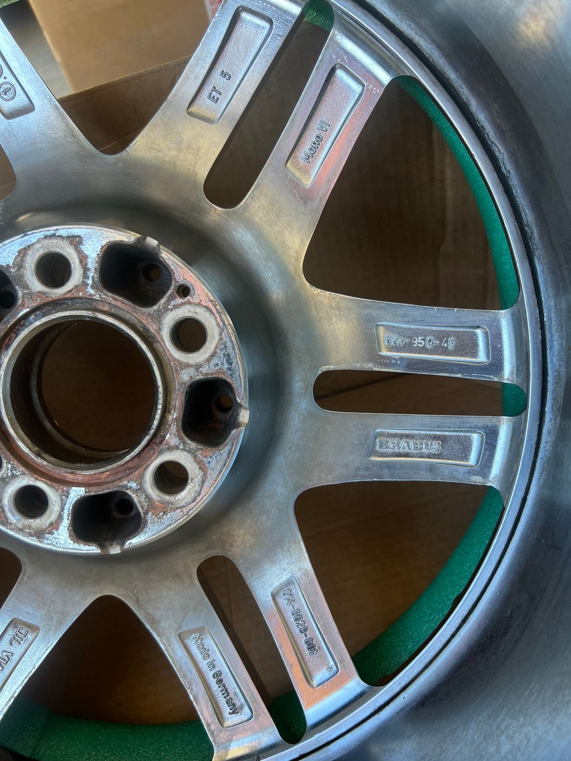

Old Oct 19, 2024 | 01:36 PM
rharts80's Avatar
Joined: Oct 2024
Are these real?!?
Originally Posted by MBJIMBO
Yes, sorry I should have mentioned that as well. The first gen 20" wheels were the 522-950-37, and the later gen wheels were 522-950-45.
Mono VI (6) wheels had also started being produced with a multiple size range, 622-900-40, 622-950-45, 622-050-35, 622-859-45, 622-959-45, 622-009-35. 622-858-35, 622-958-35.
The mono V (5) 20 never ended up having any staggered 20" wheels, just the 9.5x20.
Hope this helps.
Jim
Hey Jim,
if you’re still out there please help!!!
Are these real??
BRABU ??? Stamp is worn away or incomplete.
Part numbers seem legit.
I just don’t know. Thank you.
Rich
Old Oct 20, 2024 | 04:41 AM
MBJIMBO's Avatar
Joined: Jul 2017
Posts: 225
Likes: 21
2018 E300 Sport:Current 2015 Mercedes Benz C300 Sport- Gone.
Originally Posted by rharts80
Hey Jim,
Are these real??
Rich
They're legit, just chrome plated, that's why the lettering looks warn away, that happened during the polish process to get them chrome plated. Honestly I would steeri clear of chrome wheels, the plating process compromises the integrity and strength of the wheels. Hope this helps.
