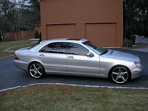

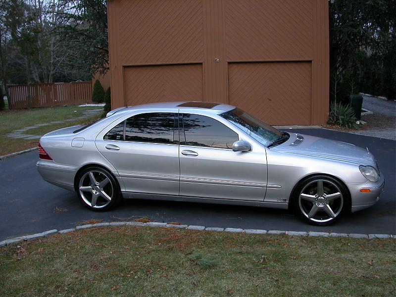

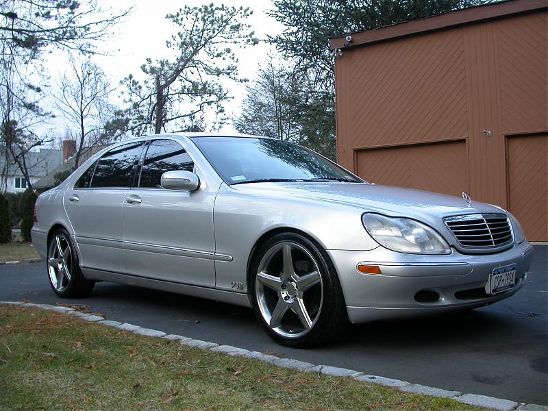

ok finally got the pics..
These are 20 x 8.5 hyper-silver CLS AMG replica rims by MB Designs? I went stock for a while after my lowenharts were peeling and bent but when I saw this like new set of rims go for $550 I couldn't resist! What do you guys think? ..and I know, that 20" emblem on the fender has to go..just haven't figured out yet how to remove them without harming the paint..

nice! what size tires are you running?
Old Mar 6, 2008 | 07:15 PM
ArMaNi S500's Avatar
Joined: Nov 2003
Posts: 389
From: Dix Hills, NY
2000 Mercedes S500
255/35/20
still rides like it should
