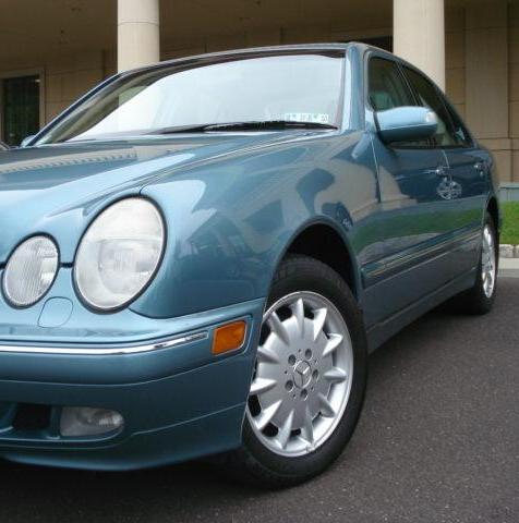

Here is a pic of the wheels from 2000 - early 2002 W210 E-Class (slight variation was made through 1999 as well). I will see if I can find a pic of my W124 Coupe or Sedan with the same wheels & tires.

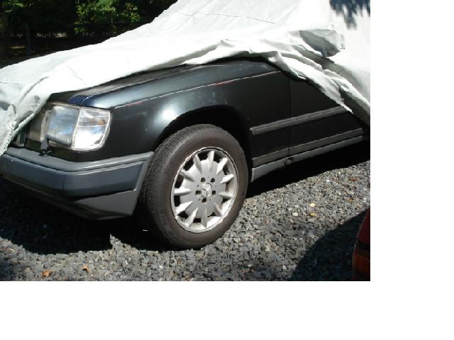

Here's a pic of my 1989 300E sedan ... peaking out from underneath the car cover. Not the best picture to appreciate the wheels ... but think you get the idea. This is called an 11-hole wheel (2000 to early 2002).

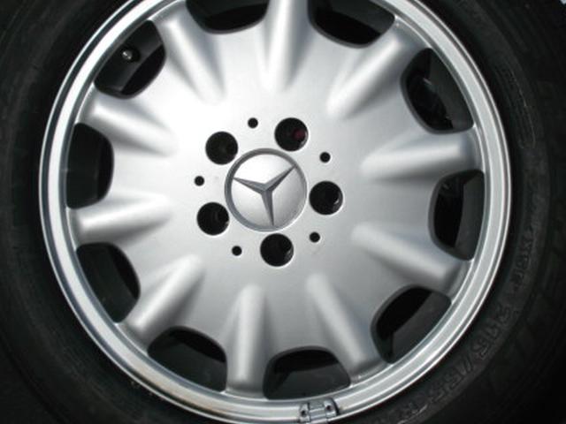

Separate pic of the alternate (slightly older wheel) W210 wheel posted as well. this is called a 10-hole wheelm annd was installed on W210's, up to 1999.
