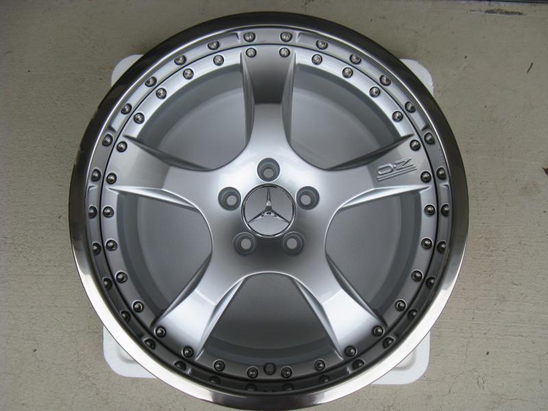

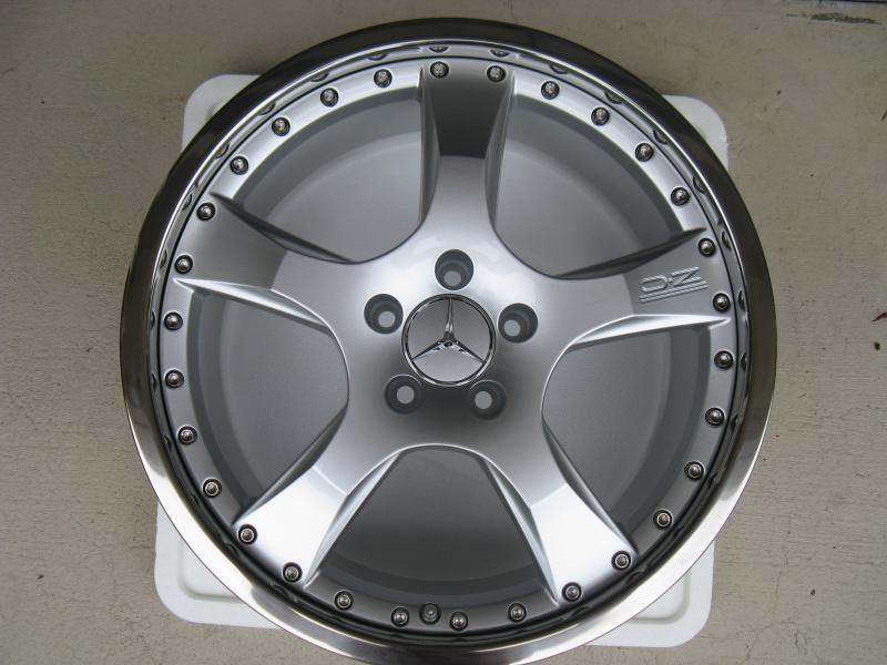

How about these? 19x8.5 front, 19x10 rear. Absolutely brand new, 2 piece, highest quality OZ wheels. Your price range - only $1,200 and I'm 2 hours away from you. But... high offset so must use H&R or Eibach spacers. Let me know if you need more info.

okay sooooo what's the high offsets you speak of? Deffinately interested

Rear: 19x10 ET40, you'll need 10mm spacer, H&R part number 2055665, for ET30.
Front: 19x8.5 ET46, you'll need 10mm spacer, H&R part number 20556659, for ET36 or 15mm spacer, H&R part number 30556659, for ET31 - choice is yours.
I know above H&R spacers are available for about $85 each pair (you'll need a front and a back pair) shipped from ecstuning.com.
The only problem is that I do not have lug bolts for your car. Your car still uses 12x1.5 bolts. I have only 14x1.5 bolts for all newer MB cars since 2003, except W203 and W209 that still use smaller bolts.
These wheels, without spacers, use about 37mm "usable" length bolts. So with spacers, you'll need 12x1.5 round/ball seat lug bolts with "usable" length of 47mm for 10mm spacers or 53mm for 15mm spacers.

I looked at them some more and realized that they're pretty ugly or just not for me. That with a combination of the offsets being through the roof just wont work.
