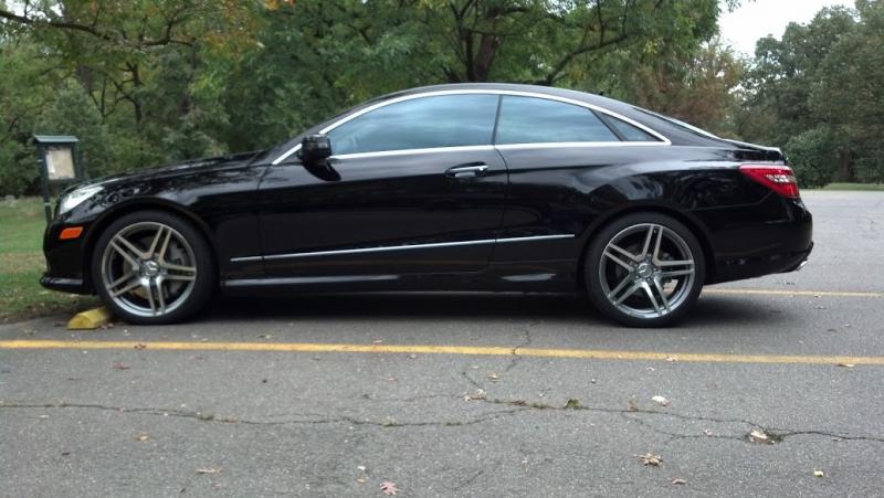

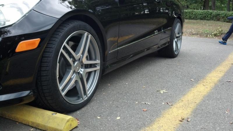

****Update****
After some "spirited" driving, I ended up putting 5mm spacers on the front. Although the fitment was fine for city driving, the inside corners of the front tires would rub the lower assembly spring plate when under heavy load (hard braking or cornering). Not enough to damage the tire but it made a lot of noise and would cause some minor oversteer near the limit. The 5mm spacer has provided just enough room for the tire.
I'm also very impressed by the Conti ExtremeContact DWS tires. Night-and-day difference from the Pirelli PZero M&S from the factory. The difference in dry weather traction is more significant than could be expected from the extra 30mm/20mm (rear/front), and the wet weather traction is incredible. I don't see the blinking yellow light nearly as often.
I was at the dealership this weekend and noticed the 2013 went back to the Michelin Primacy MXM4 - not much of a shock. The Pirellis just aren't that impressive.
Anyway, as promised, here are some pics of the final installation. The front and rear are almost perfectly flush with the body, and the stock alightment settings still allow the tire to recess into the wheel-well without rubbing anywhere.
