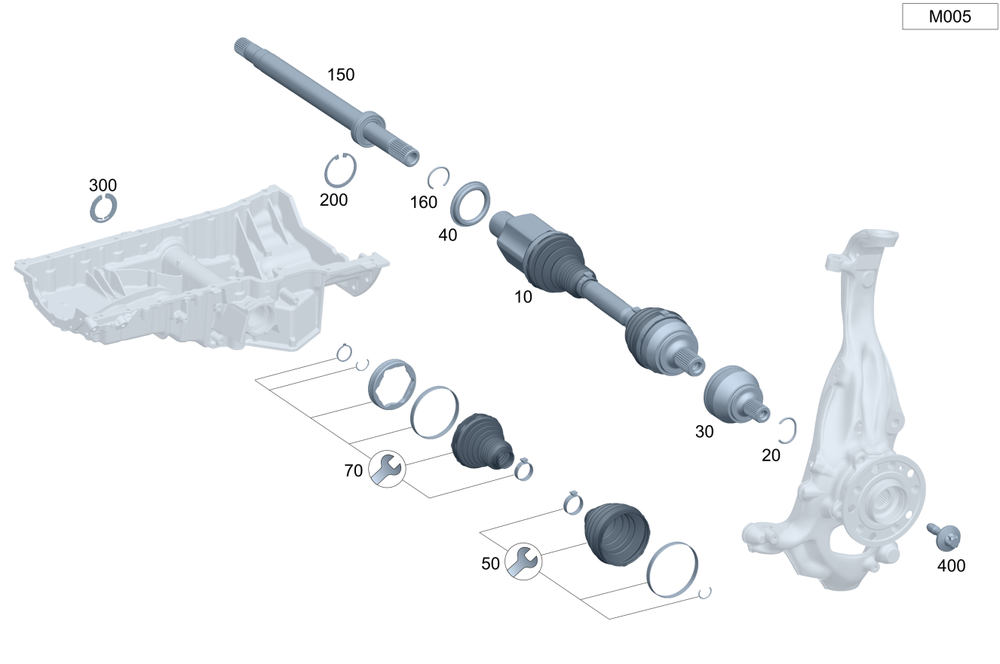

It looks like both ends of part 150, and the one end of part 30, all have slpines and could provide lateral movement.
