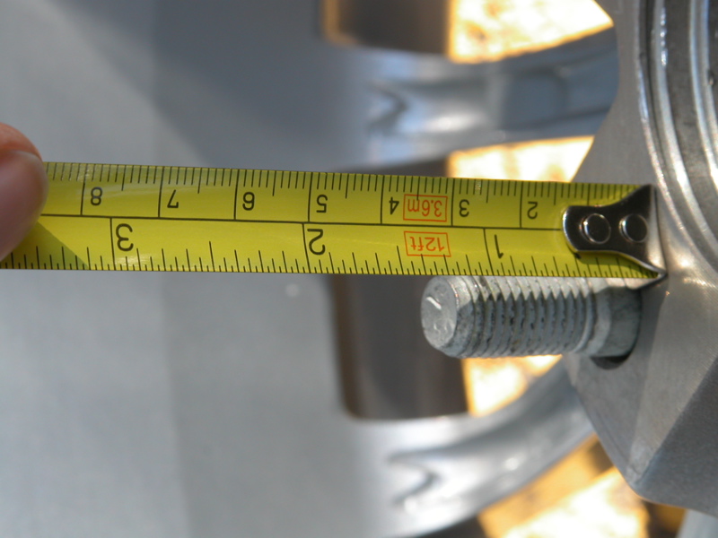

Luke,
I just installed the wheels and tires I ordered on my SLK350 and they fit perfectly.

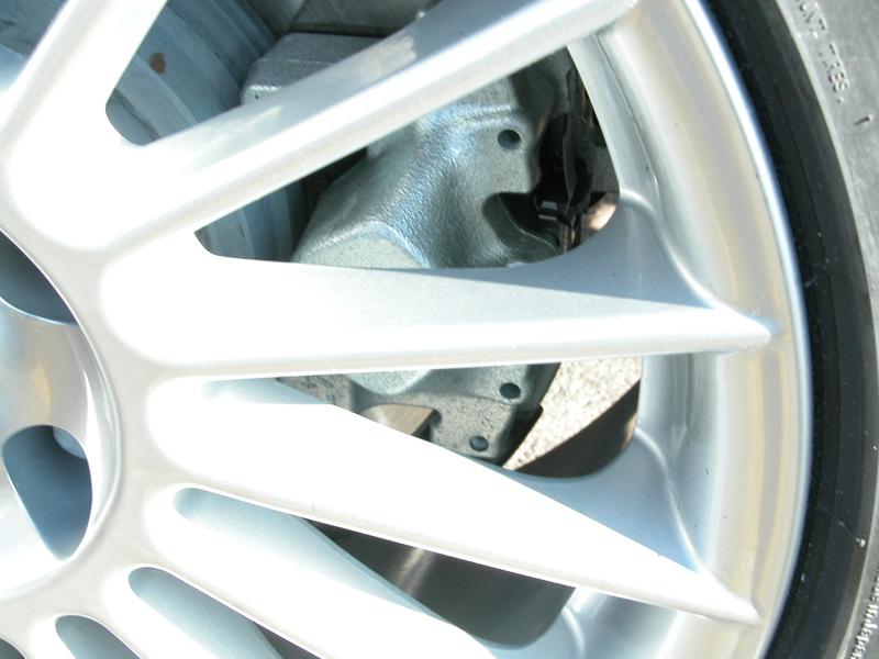

However, when i tried backing out of the lane I was in, I heard a click from the left rear wheel. I immediately stopped the car and wanted to check with you. What would make a click-click noise when the tire rolls?
Thanks!

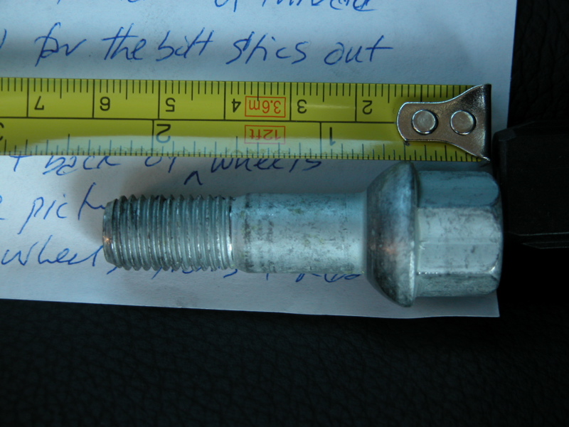

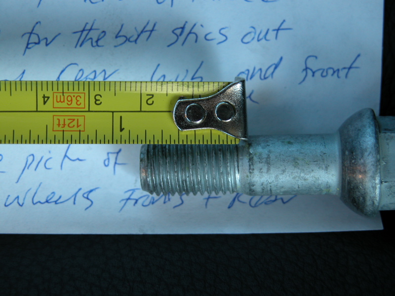

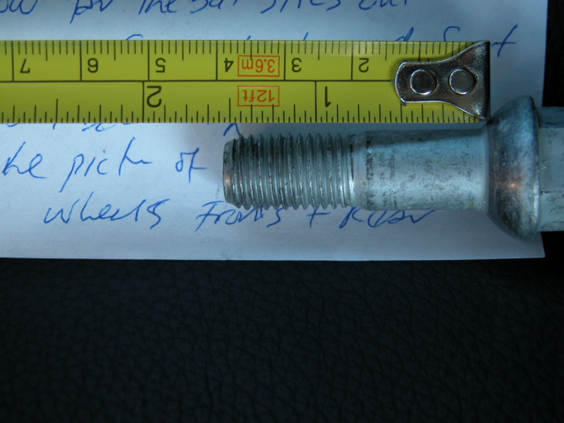

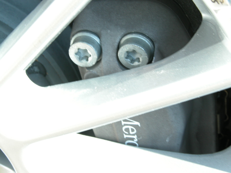

depends on the weather

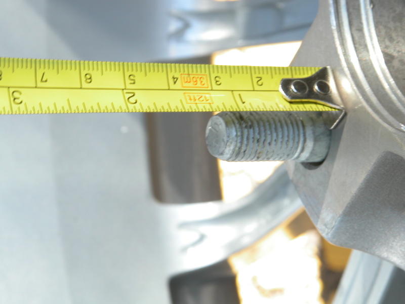

you need differnet lug bolts .. .that clicking sound is the rear bolts contactinig the parking brake

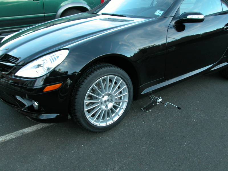

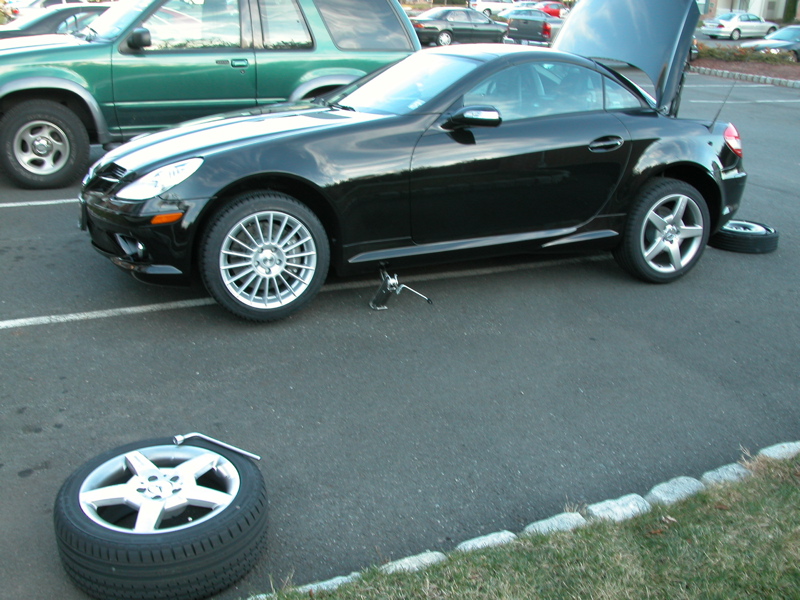

Posting the Pictures:
Attached Thumbnails Help with Tire mounting!-0.jpg   Help with Tire mounting!-4.jpg   Help with Tire mounting!-5.jpg   Help with Tire mounting!-6.jpg   Help with Tire mounting!-9.jpg

Rest of the pics showing measurments:
Attached Thumbnails Help with Tire mounting!-10.jpg   Help with Tire mounting!-11.jpg   Help with Tire mounting!-12.jpg
