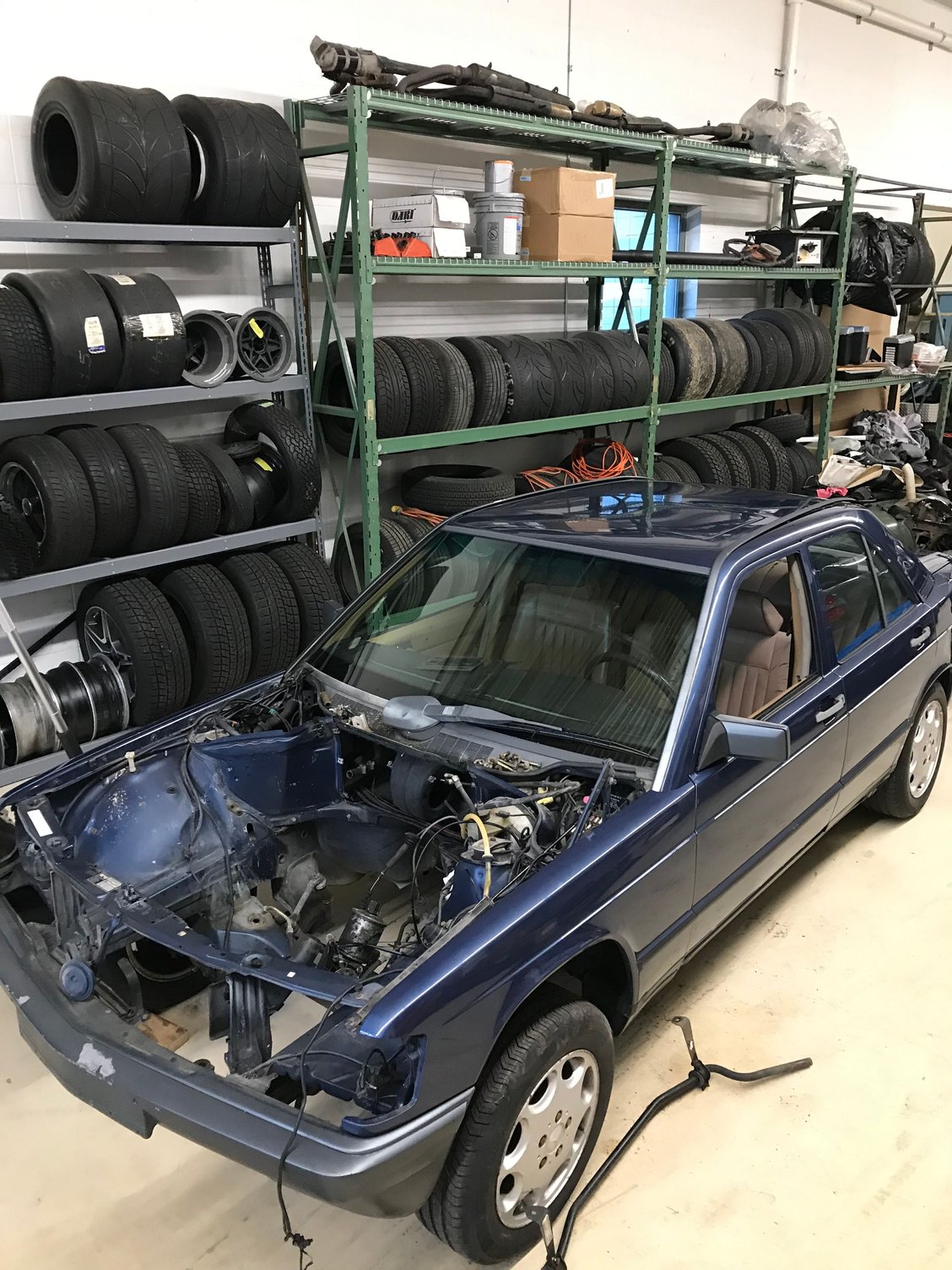

long story short I bought a 6.0 out of a 2500 Silverado, then bought a 1985 190e roller the day after, car is super clean except the interior is roached. Once I got it back to shop I started cutting the car apart to jam the v8 in. 3 months of progress photos incoming.

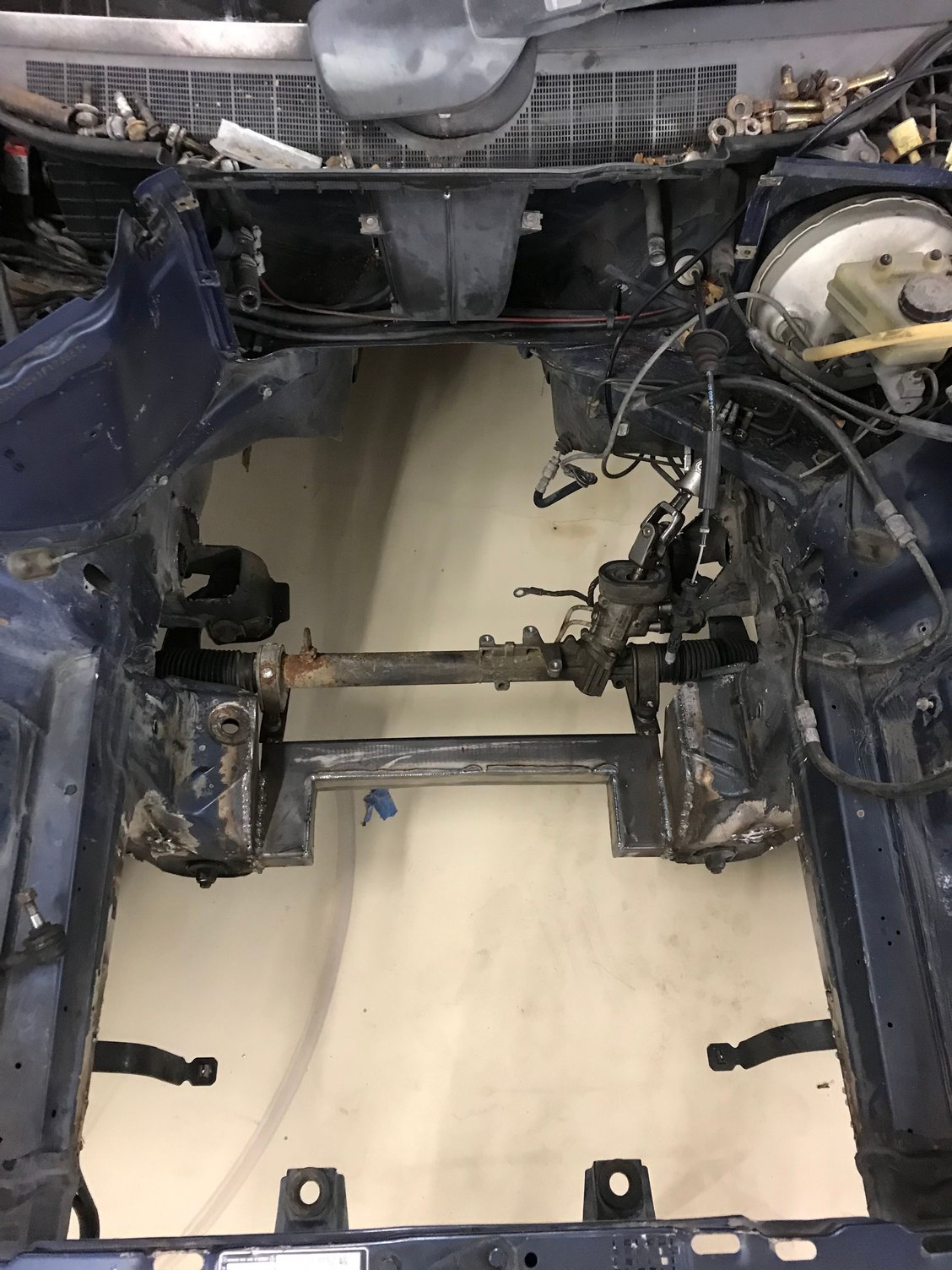

Cut out a ton of metal to make room lots of cut off wheels and grinding but got the subframe and rack where I want it

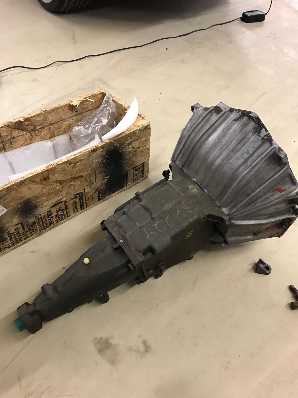

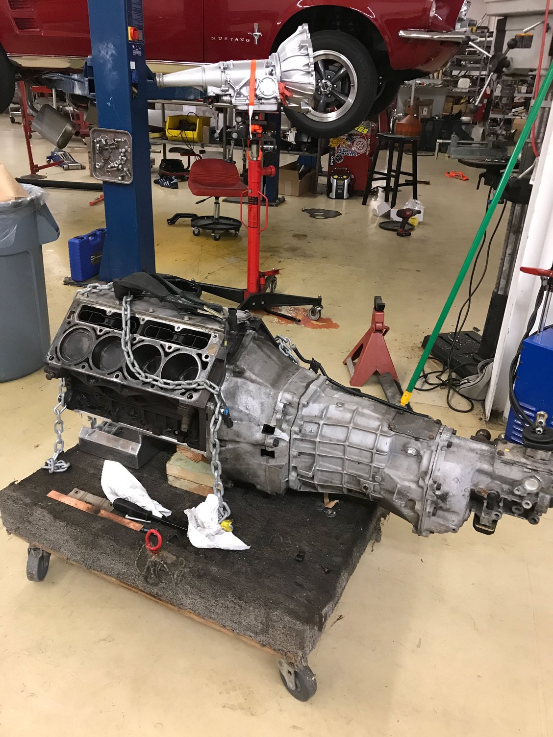

Started out with a Muncie that we had sitting on the shelf. I thought a 4 speed would be fun till I realized the shifter came up about 10” to far forward. Glad I had it tho since it was great for mock up and making motor mounts. Also found out that the truck intake was about 6” to tall.

Bought a ls1 intake manifold and a T56 which cured my shifter location and hood clearance

The steering rack was a pain to get right but for now it will have to do. Will probably change this down the road but gotta keep moving. I found it easiest to get rid the stock column and make my own shaft and supports.

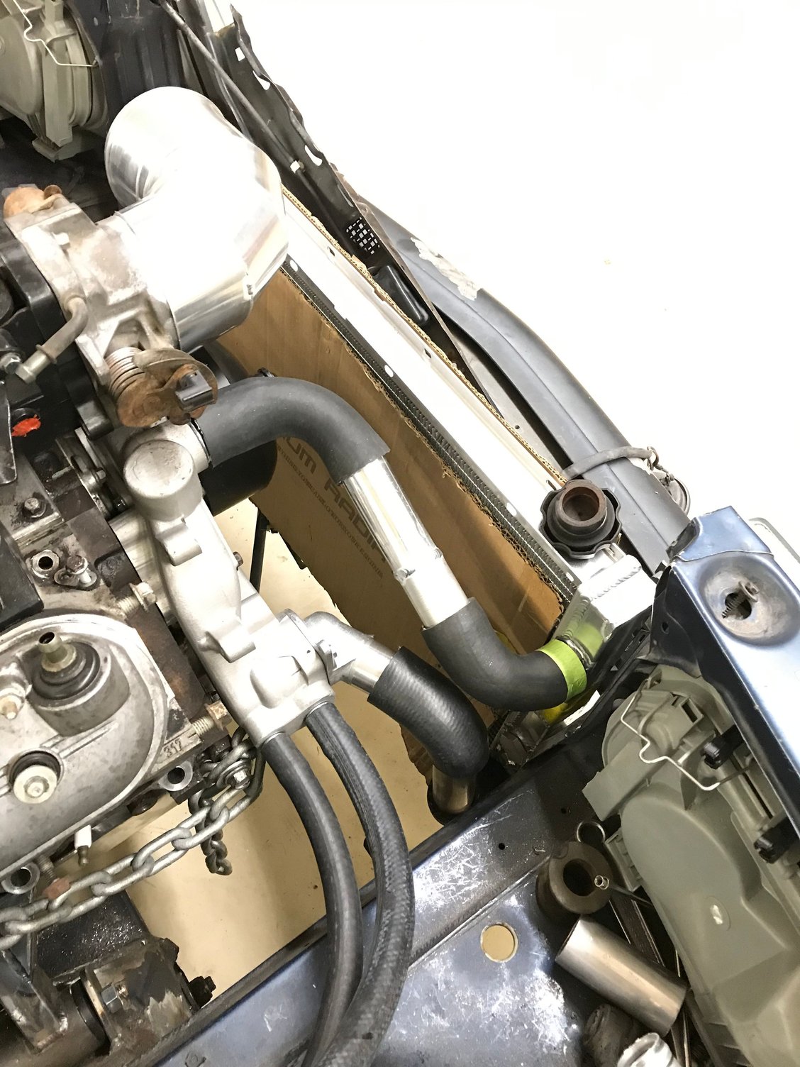

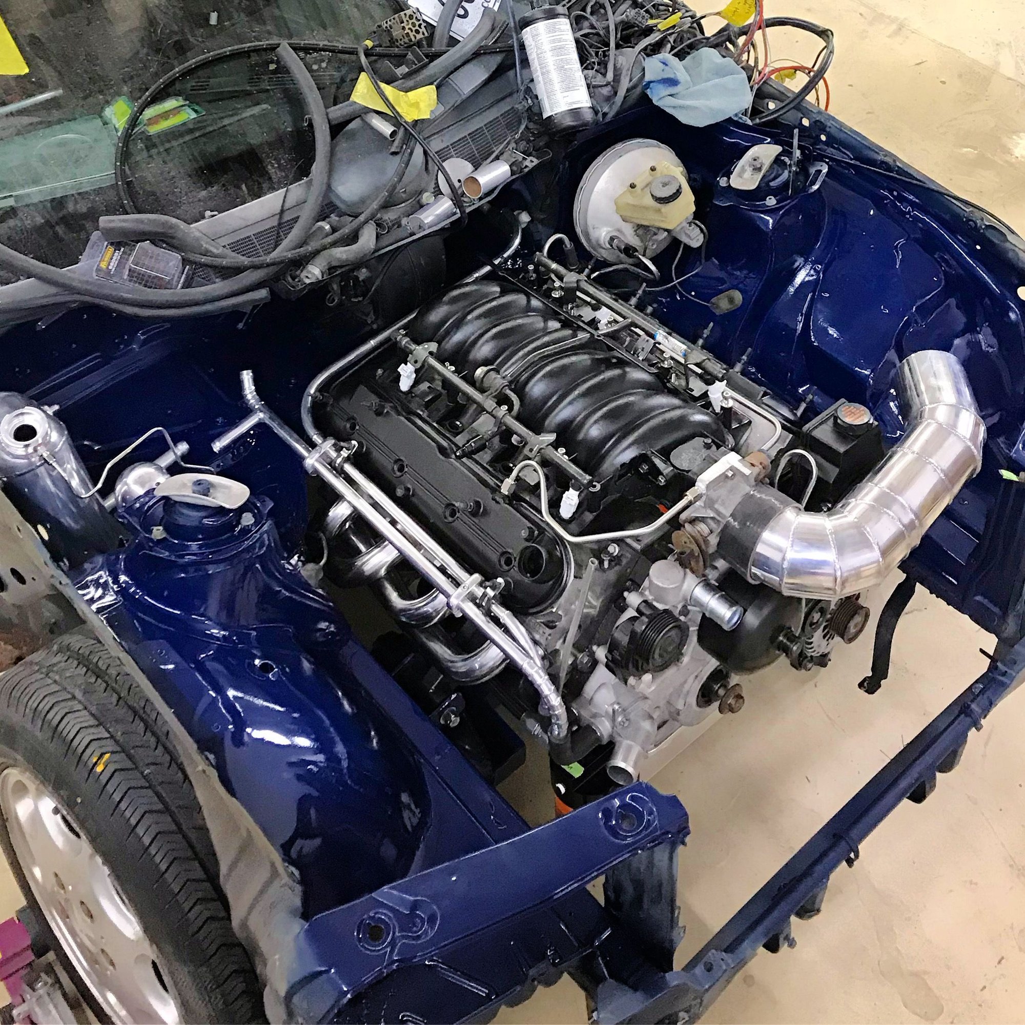

Cooling system almost all plumbed.

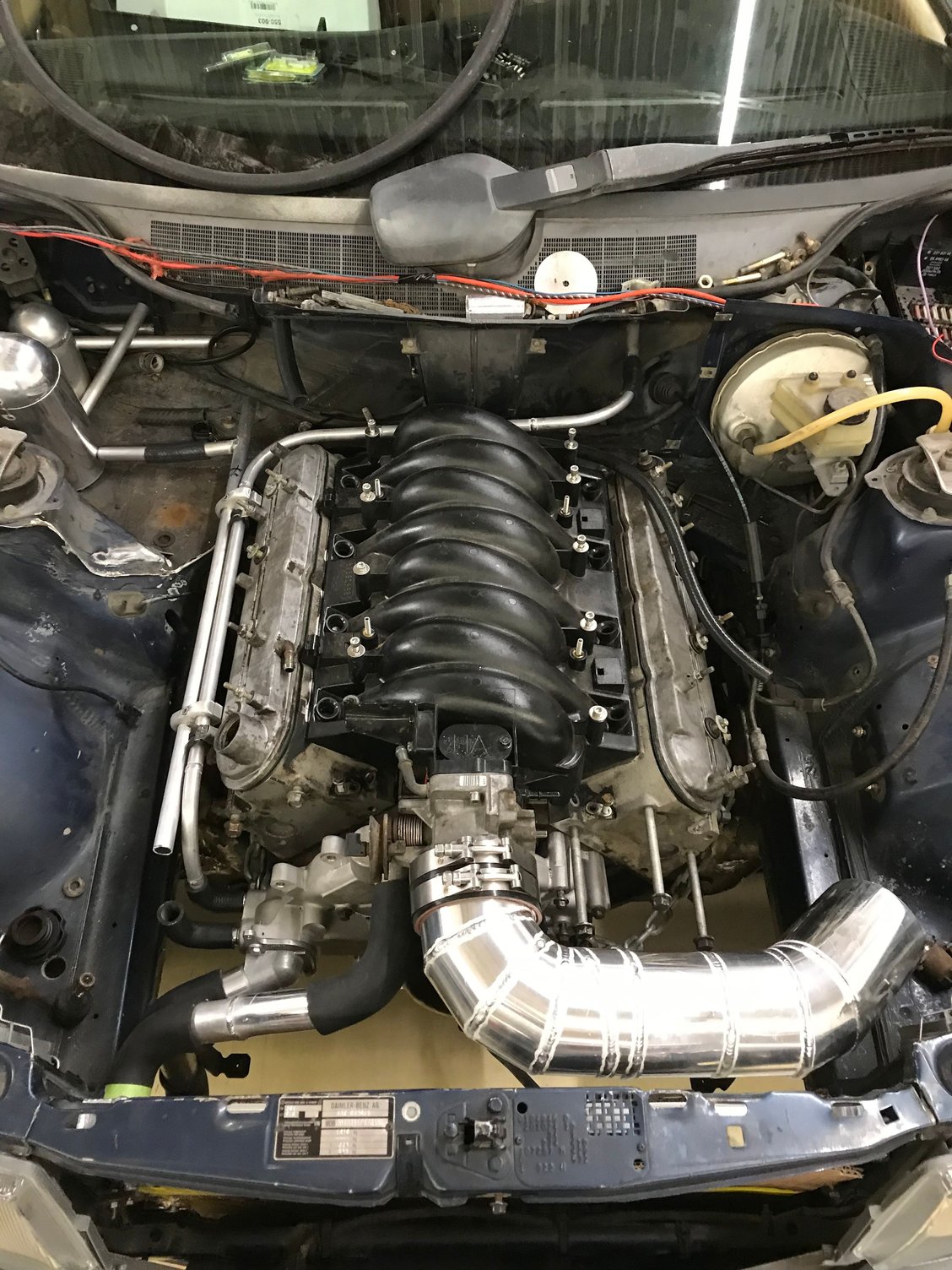

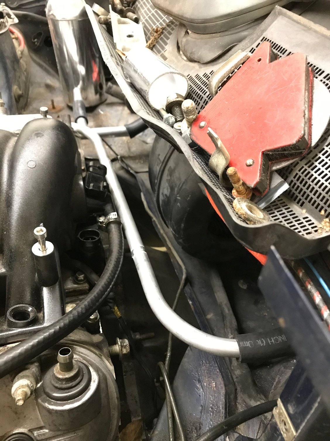

One more 90 degree bend and the cooling and intake set up is done.

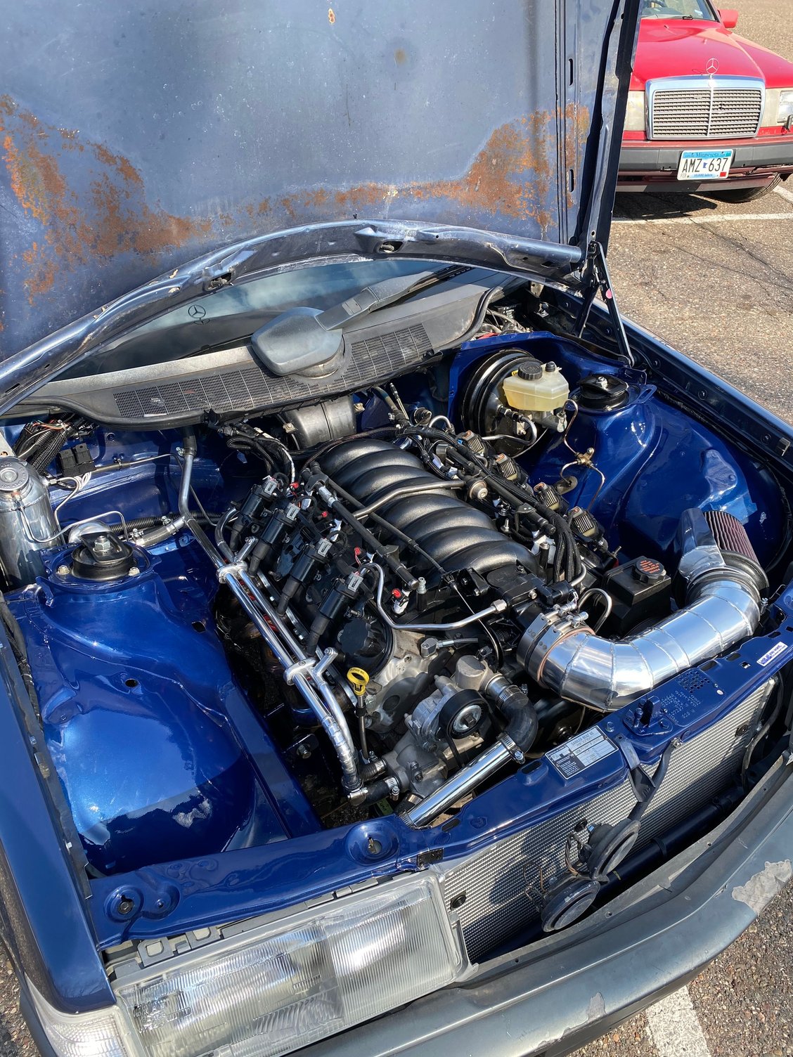

Finished up the engine bay just have to paint bottom of hood. Also got some bbs rs that I am finishing up restoring
