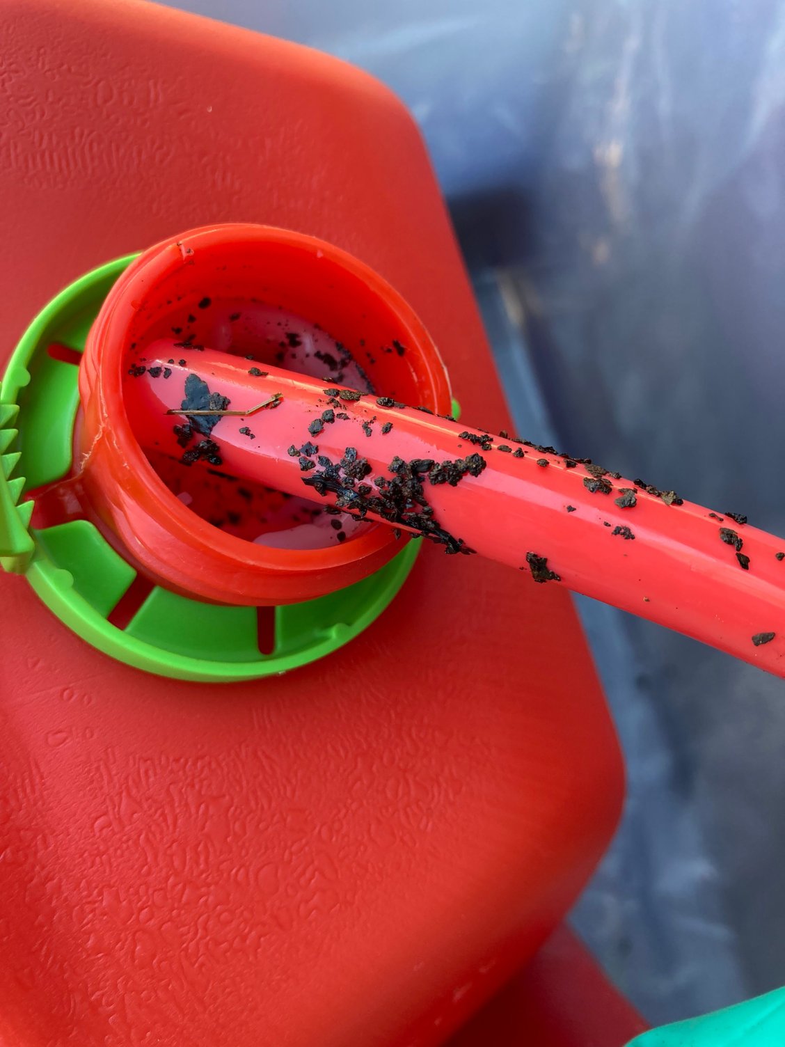

Just drained all the fuel, this was overdue
To be continued

This looks nasty. I would suggest checking your fuel filter to see if it's also full of this same crud and I would also suggest flushing your entire fuel system because crud like this can cause all kinds if trouble.

I would actually take apart the whole plumbing down there (Fuel pumps, accumulator, filter, hoses etc) and flush everything.
I just replaced my filter and swapped in another accumulator and there was a lot of bad fuel (nothing like yours but with some water) that came out from the tank side of the accumulator connection.
If you think about it that fuel is from the tank and has been there for ages as the accumulator does not allow fuel flow in the reverse direction.

I had replaced the accumulator, filter, pumps and all a few weeks ago and none of the rust had made it past the first fuel pump. Only drove it a handful of short distances since but I’ll check again and flush.
I put things on hold a couple days. I underestimated how far up into the bottom of the car that fuel tank exit hose was and the fitting was pretty corroded.

Yes I went MB brand for the screen and already have it in the glovebox. Im certain this will fix my problem. Like you said the mesh is really fine and a weird texture… My mistake was assuming the car sat all those years on an empty tank but no, the old fuel had simply evaporated and the rest turned to dust and sediment and settled to the bottom, that screen is the bottom most part of the tank….
I will take my time on this and provide an update once my car is back running

I gave up and sent the car to the shop. My mechanic was able to get the fuel tank strainer off, it was indeed seized but I have a new strainer put in now. The car is still cutting out when attempting to drive, but I’m glad strainer is out of the way.
He has boiled down my issue to two possible culprits. He recommended tackling the EZL first, car is losing spark and secondly the o2 sensor (mine is “lazy”, rounded and seized). The plan is to try and put a used EZL from a m103 motor to see if there’s any difference, once I get my car back I’ll try to get a muffler shop to torch off my seized o2 sensor.
Thoughts?
Thoughts?
Have you checked your distributor cap to make sure there is no moisture there? I would also suggest checking all of your engine wiring to make sure there are no loose or dirty connections. Any of these can cause the cutting out you're describing and they're simple, cheap ways to help to diagnose the problem.
Old May 10, 2022 | 11:21 PM
  #50
dolucasi's Avatar
Joined: Mar 2016
Posts: 1,369
Likes: 195
From: SF Bay Area, CA
190E 2.6L 1989, 190E 2.6L 1988, BMW 535dXdrive 2014, BMW 428i 2015
Also, can you describe the "cutting out" a bit more. Do you mean it does not have enough power or do you mean it is tumbling, coughing etc.
remember outside the consumables (distributor cap, rotor, spark plugs) the rest is super reliable. That includes, coil and EZL.
Also a lazy O2 sensor will hardly be noticeable when driving because if everything else is on order and your FD/airflow meter is properly aligned the O2's function is limited by design, it is just fine tuning your lambda ratio.
