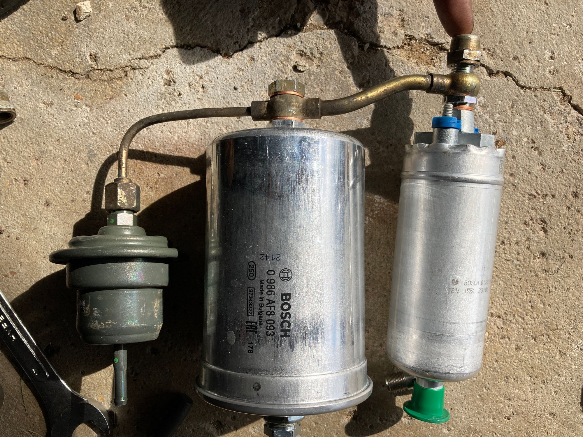

Actually got to work today and this job is easier than expected I have my car parked on an incline and didn’t need to lift it or put it in ramps at all. I was able to source a couple possible leaks so good signs well be back rolling after this. Exit hose was loose and fuel pump banjo connection was leaking,no washers were on it.
I broke my plastic fuel tank vent valve (201 476 01 32) but looks easy to replace any suggestions on where to find another?
and can someone verify if washers need to go on both sides of the fuel pump banjo like the fuel filter in this pictured below or just one? New pumps didn’t come with any.

Pretty disappointed with bosch. I have a new pair in my stock and it does not have the crush washers in it either. It includes the check valves.
When you just order the check valve separately, it comes with the washers (3 one for the base, 2 for the banjo fitting).

Much appreciated! yeah Bosch is wrong to sell these pumps with no new crush washers. The Haynes manual was clear to replace them, so I’ll pause my project until i order some new ones, the vent valve is actually on autohausaz for pretty cheap.
Will update once I finally get everything back together and see how it runs.

You figure when you purchase a $100 pump, it ought to come with a couple of 20 cent crush washers! Shesh,,,

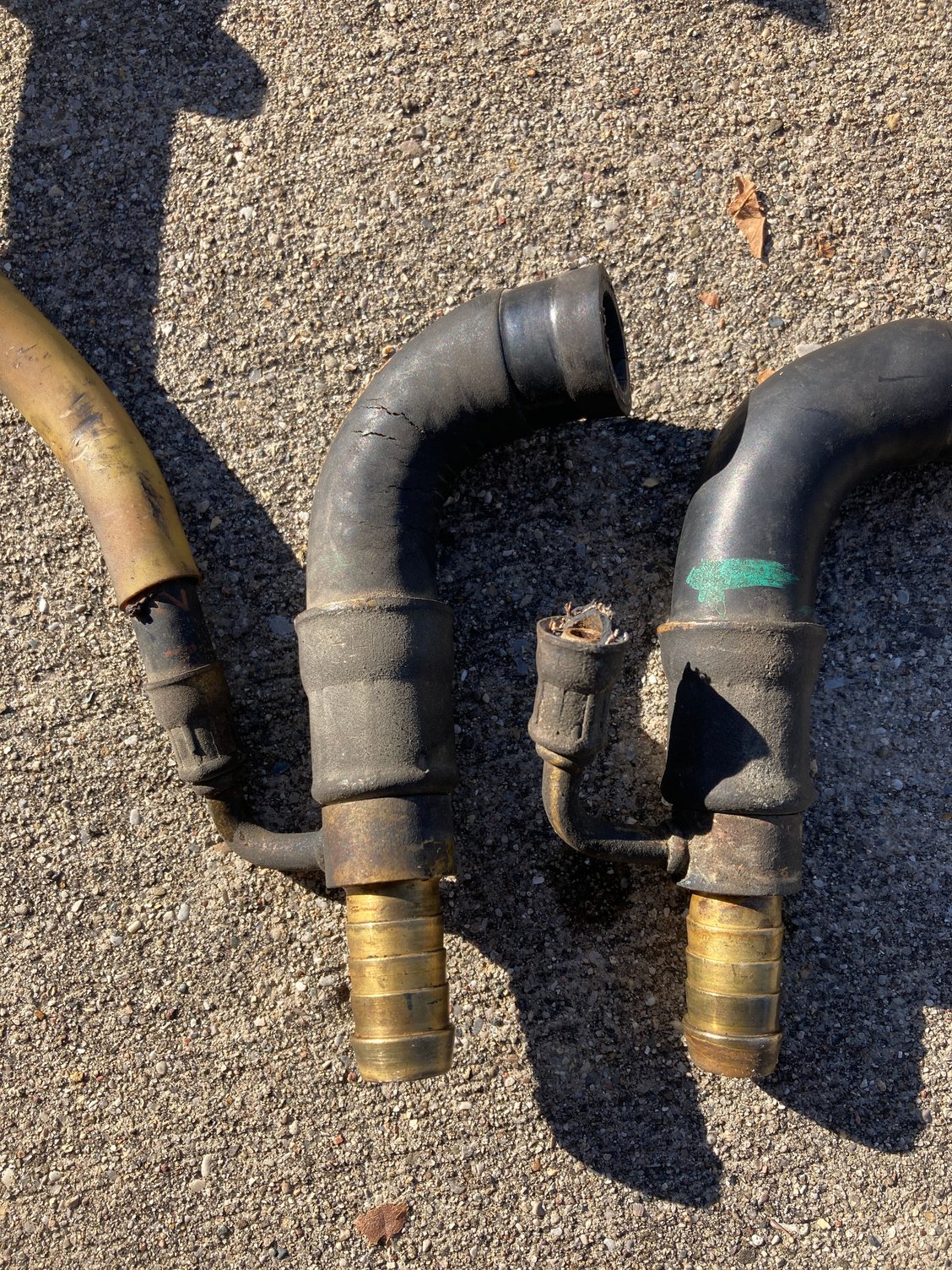

They did have it on classic center part number was superseded. Everything is back together except I lost the little electric terminal nuts for my fuel pumps and broke another brittle hose, the one that attaches from the elbow to the fuel accumulator. Thought I could combine my two exit hoses into one okay one but no…one cracked the other broke accumulator line.
Can I just get some 6mm nuts from Home Depot? And where can I get these hoses refurbished? It’d be nice while I have things undone

Yeah I recall the smaller wire can’t fit onto the larger terminal they did good to make sure you don’t mix them up. I think one is 6mm the other 7 or 8mm? Bosch doesn’t include them and the Dealer has them $5 per lol
I found a shop to take my hoses to, hopefully they can just crimp fresh rubber on the OE metal fittings

I wound up having a fuel hose made for my W201 earlier this year when a new one was NLA. I think your plan should work.

I took them both hoses, the metal fitting with the little arm is not supposed to rotate so one hose actually ended up being useless…they couldn’t replicate the rubber bends (elbow) but said it would be fine to use the non-cracked elbow. They sawed off the metal crimp that held the accumulator line, there is a nozzle within it that will securely hold the line if you put a clamp instead
Im going to keep the bad hose since it’s NLA I’m sure another shop might be able to refurb it
