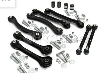

Firstly thank you to the MB world community as I have been enjoying driving my 190e now that it is warm and have confidence in it as a daily. Though I've learned we are never done!!
Recently I started to hear a constant creaking as I go down the road coming from somewhere in the rear suspension. The creaking can be recreated pushing down on either side of the trunk. I think both sides are generating equal noise. A bit embarrassing but being such an old car I accept it for now.
is there a particular link in the rear more prone than others to creating this type of noise? I am considering the full rear link kit from fcp euro and just refreshing everything. How difficult is this in your experience? Should be easier than replacing the front suspension components though there are more of them right?

Hi Betterdaze, I do not have the creaking sounds in mine yet and all links are original. They are probably due for a refresh though.
Make sure the creaking is not from the shock absorbers or the control arm. I'm guessing it is less likely to come from control arms but possible.

Thanks! I feel like the 5-links would make more of clunking noise and have more noticeable sway when cornering. Car stays very well planted.
I recorded a short video, it is either the rear struts or the rubber bushings/nut on the control arms, not sure if it’s the inner most one or outer.
rear struts are cheaper then the link kit so I’ll likely try them first. I have Sachs on the front are bilstein ok for the rear?

Sounds like struts to me but you never know. If they are original's they are most likely blown. Seems you can push it down with ease. Mine is hard to push down. I have the reverse. Bilsten HD's in front, Sacs in the back. I do not see a problem with my set-up.
Are you going to go for regular bilstein's or the sports/HD's?
Might be interesting to know if it makes the same sounds if the rear is loaded before you bounce it. You can also put the car on jack stands an try to jack up one wheel at a time and listed more closely.
Less likely to be the links in my opinion. But would like to know what you find out.

Good to hear about the rear shocks. The anti roll link indeed has some rubber bushing in it. So the rubber could be toast. But all the other links also have rubber bushings and could give you trouble.

Thanks dolucasi. Should have better framed my question, I wanted to clarify if the one vertical link is indeed the anti roll/stabilizer link(now I know it is), because it doesn’t seem to be included in the kit or considered part of the “5-link system” and I’ll need it too. I think i have one already in storage somewhere

The roll bar link is not part of the kits normally. It is a separate item. It is a plastic part in the W201. And yes it is the vertical one connecting the relatively thin stabilizer bar.
They are easy to take off. You can take one off and see if the noise goes away. Although they are stressed in aggressive driving they are not detrimental during easy driving from what I know.
Also by the design they should not move when both sides are bounced as it is an anti roll bar. They will get stressed when only one side bounces up/down. Another way to diagnose is if you bounce the car from the center of the trunk (if you can with the new struts) and they do not make a noise they are probably fine.
You can take Laura's advise and spray some lubricating material on the bushings as well to see what happens.
