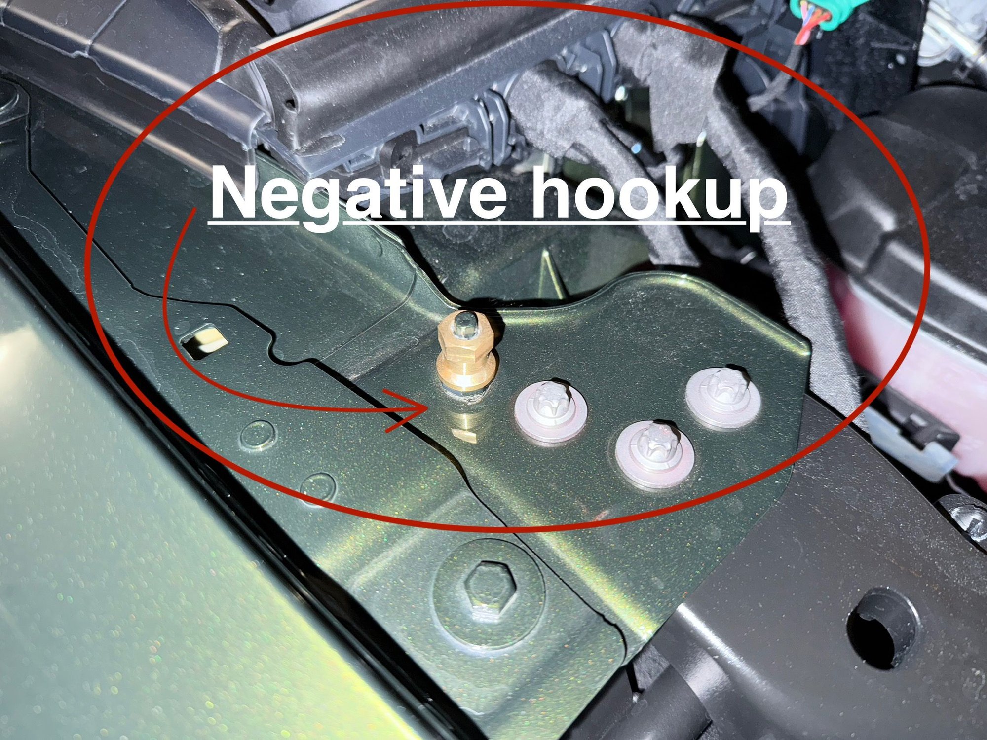

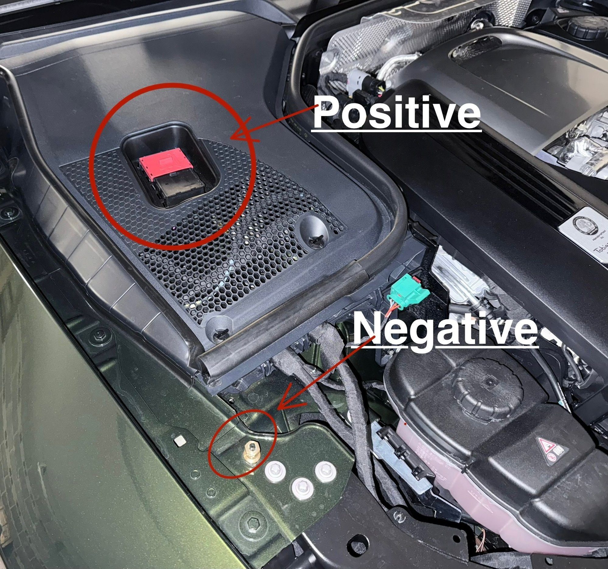

Ok Gang, these days they make trickle chargers that work with acid, lithium etc without any need to pick a setting. Below are pics of where you hook it up to and it will keep all your batteries, even the one for the 48v system all nice and charged even in very cold weather. This is for GT’s, but the G’s are very similarly placed.
You don’t need to access the physical battery. Between new trickle chargers and Mercs onboard charging dynamics, you just hook up the leads to the pos and neg and plug in the trickle to the wall.

Personally the Battery Tender Junior is the best in my book. It is designed to charge all lead-acid, flooded or sealed maintenance free batteries, including AGM and gel cell batteries etc.
Can get them on Amazon for like 50-60 bucks.
I’ve charged all sorts of different cars with them, including my RS6 that has a 12 volt acid and a 48 volt lithium ion. I just hooked it up to the under hood points like in the above pictures and it kept the batteries charged through harsh Canadian winters.
