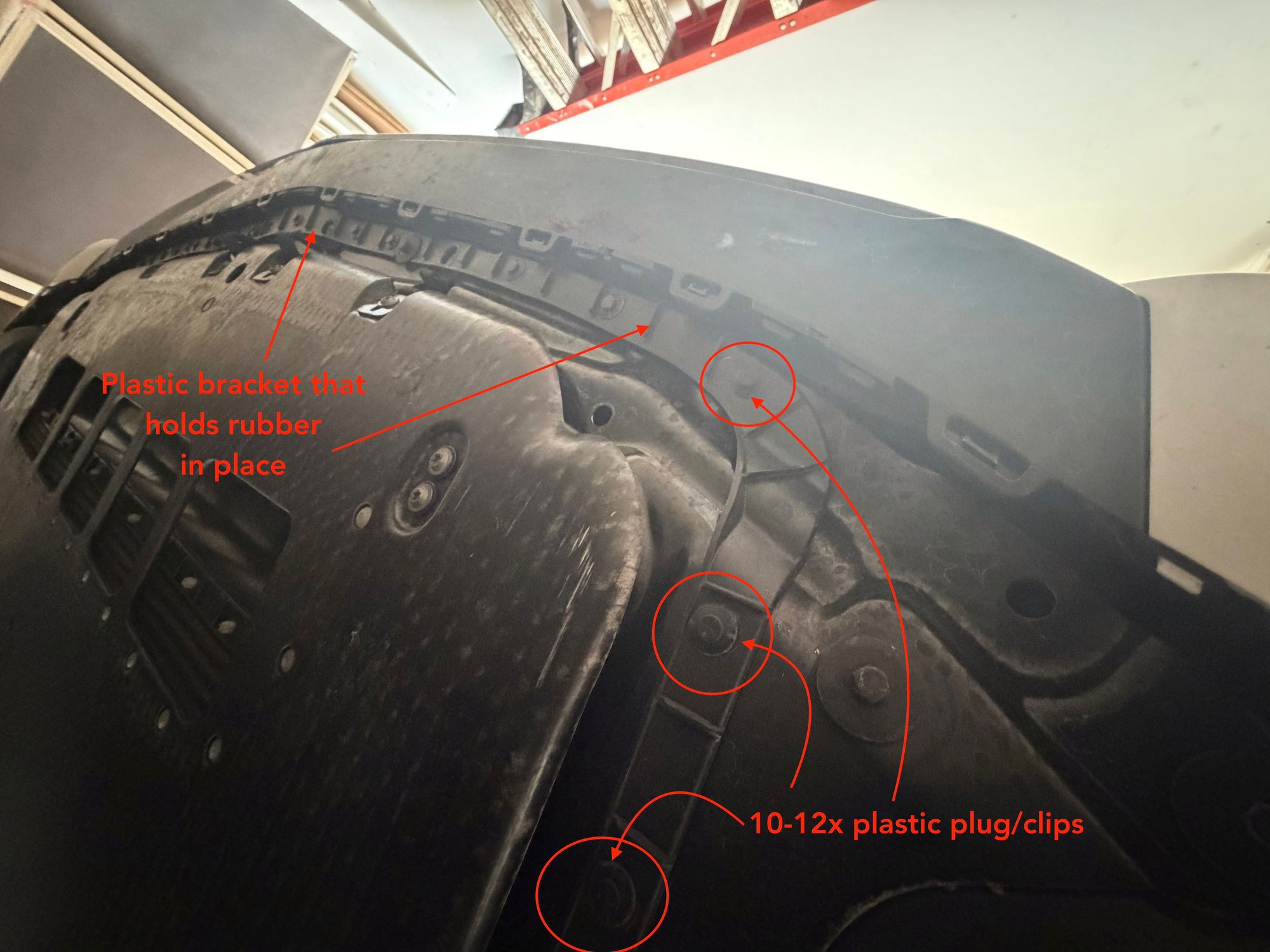

I have it on my GT63, it comes in handy pulling into my driveway with a regular rolled curb. It's also kind of cool to be able to set it to automatically rise every time I pull in my driveway. you can get away with out it, its not imperative, but the front is pretty low, and the FAL makes a substantial difference in the height. Only issue is it could be a little faster to rise in my opinion, and it only works I think below 25MPH. Over 25 it automatically lowers back down.

At any rate.... I was able to pick one up at my local dealer they had them in stock, not sure if the same part is on any other cars, but it was about $400.00 from my dealer. They wanted $300.00 to install, which is absurd. It was maybe 10-12 plastic plug/clips, and 2x 8mm bolts.
Took me longer to find my jack and get the car in the air than it did to replace. Very easy, and only need an 8mm socket/wrench and something to pop the clips out. the clips go back in by hand.
Really really easy, and no way I would pay more than about $25.00 to have someone install it. New part comes with a new plastic bracket that holds it in place.
Photo shows a few of the clips, they go all the way around. Kind of cool it appears the flap that gets pushed down may be carbon fiber but was hard for me to tell as I didnt get fully under the car. But in the photo the rubber was already cut off and not put back on yet, with it on youll see the rubber piece covering the front end of the carbon fiber flap.

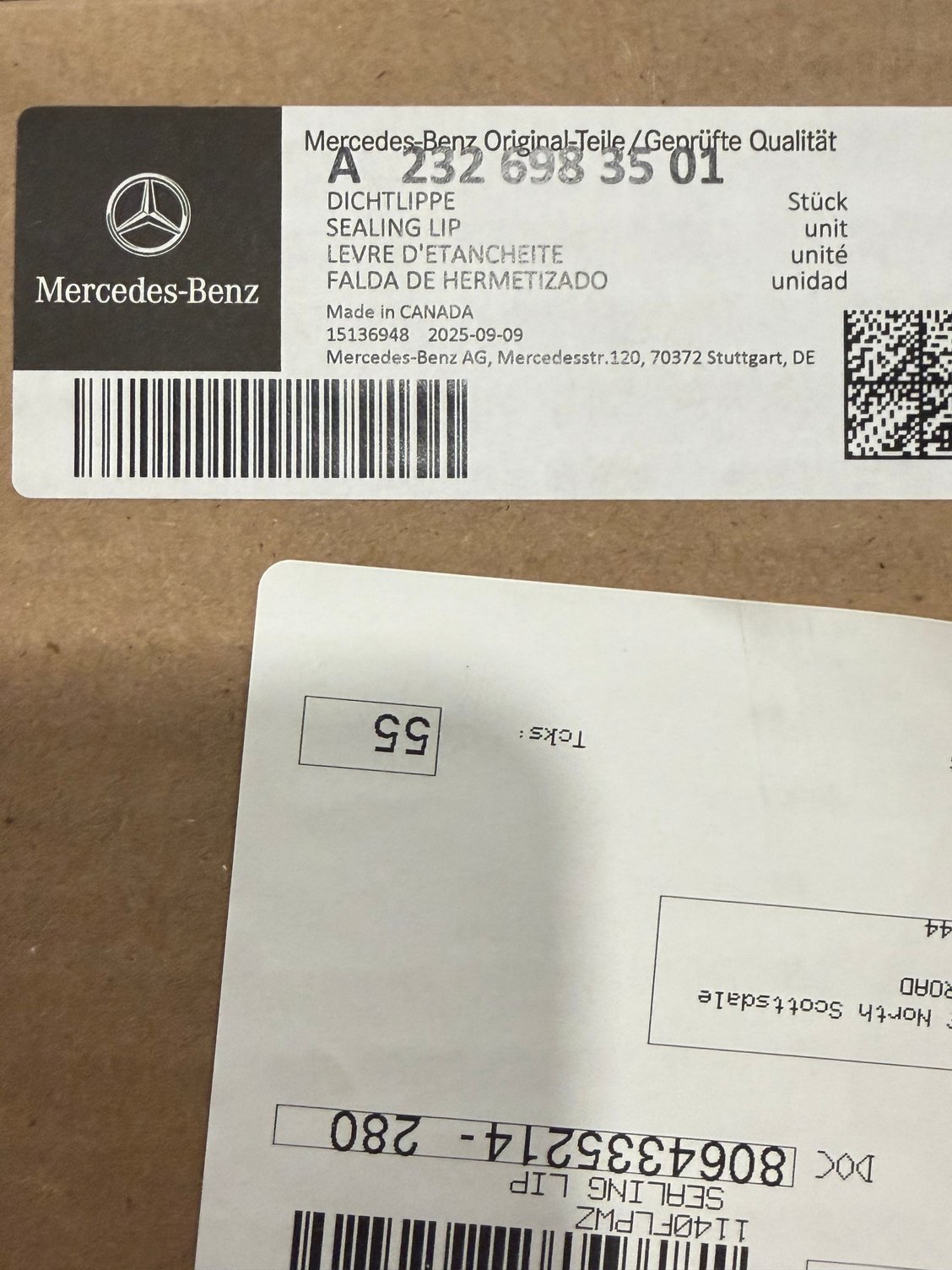

Here is the part # which may be nice to keep in handy, for some reason all the online parts sites for some reason it's impossible to find. But here it is :
