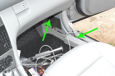

First, you need to pop-up the plastic rim on the front passenger seat as it is shown on picture #1, it is held by a metal clip underneath, so just pull it straight up using moderate strenght.

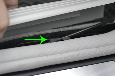

Now you need to remove the plastic shield under the glovebox compartment next to the outer side of the car (this piece is refered here as the A-Pillar) To remove this shield, you need to pop-out a small oval shaped cover located almost in the center of the shield, use a small scredriver or anything similar, then reveal the torx screw and remove it. Now pull the shield towards the driver's seat, you will need to apply a lot of strenght because there are 2 clips that hold the shield. These clips seem to have glue on the part that hold the shield.

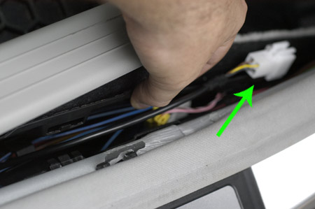

Now you will need to locate the white interconector plug. Look at picture #3.
So, now we need to cut the cable on one side and use the 3 wires to either solder or connect via spades to the Mercedes Benz white auxuliary interconector. Refer to picture #4 and #5.
If you look close to the white interconector plug, you will see numbers (1 thru 4). I connected #1 to the ground on my cable. #2 connected to my red wire. #3 was left alone. #4 was connected to my black wire.

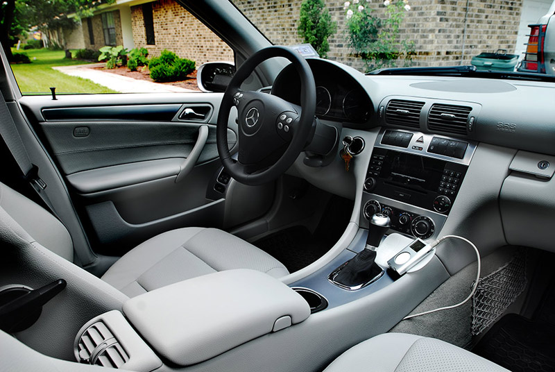

I put everything back in place and now you can look at pictures #6 and #7. It doesn't look that great but for only $ 10 who could complain?

Here's how it looks.
Pictues #6 and #7.
