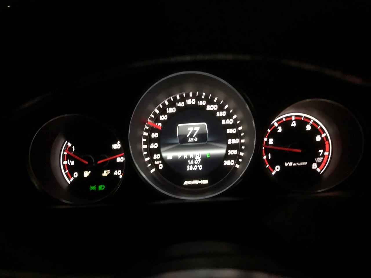

Give it a test run for a week, so far so good (since the instrument cluster speedometer bought used and have some issues when we did a sweep test)
Here's the look of the speedometer inside C250 coupe C204
interior of C250 coupe C204 fitted with instrument cluster from E63 AMG W212 facelift

Yep that's why you need to reprogram / recoding all of it via Vediamo and update the firmware, I think the mechanic who did my car took like 3-4 hours since a lot need to be changed from E-class to C-class

I'm more concerned about anything broken inside instrument cluster, especially if it's used and cheap price. It also could be mishandled at shipping led to broken parts
in my case, when we did sweep test, the speed gauge itself was kinda stuck after going up, and stuck again can't go back to 0 after test was done. When we cracked the instrument cluster open, it seems the speed gauge gear was out of track which lead to stuck when did the sweep test
for now it's normal after we tested for 1 week, hopefully the speed gauge gear was not damaged at all

It's been a month and E63 AMG W212 facelift speedometer / instrument cluster still working just fine without any error after retrofitted to my C250 W204 coupe / C204
So far I like it, even more than C63 AMG W204 / C204 facelift due to similar rpm red-line between C250 and E63 AMG + better design
