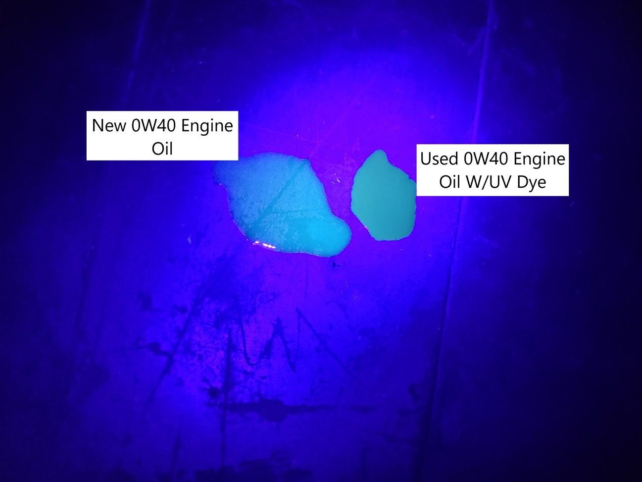

From my experience UV dye doesnt work since oil already glows green under uv light. At least on my engine it does. Cant tell the difference between new oil stains or old.

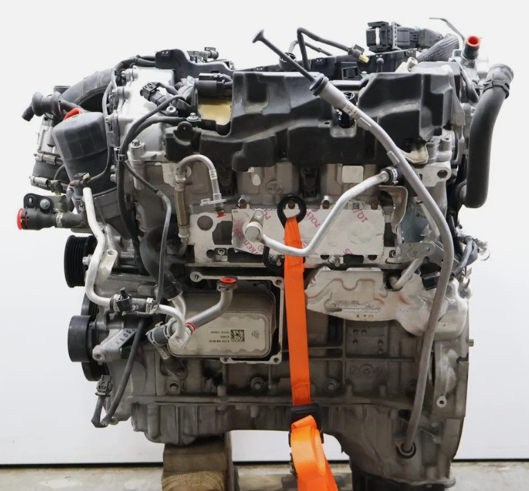

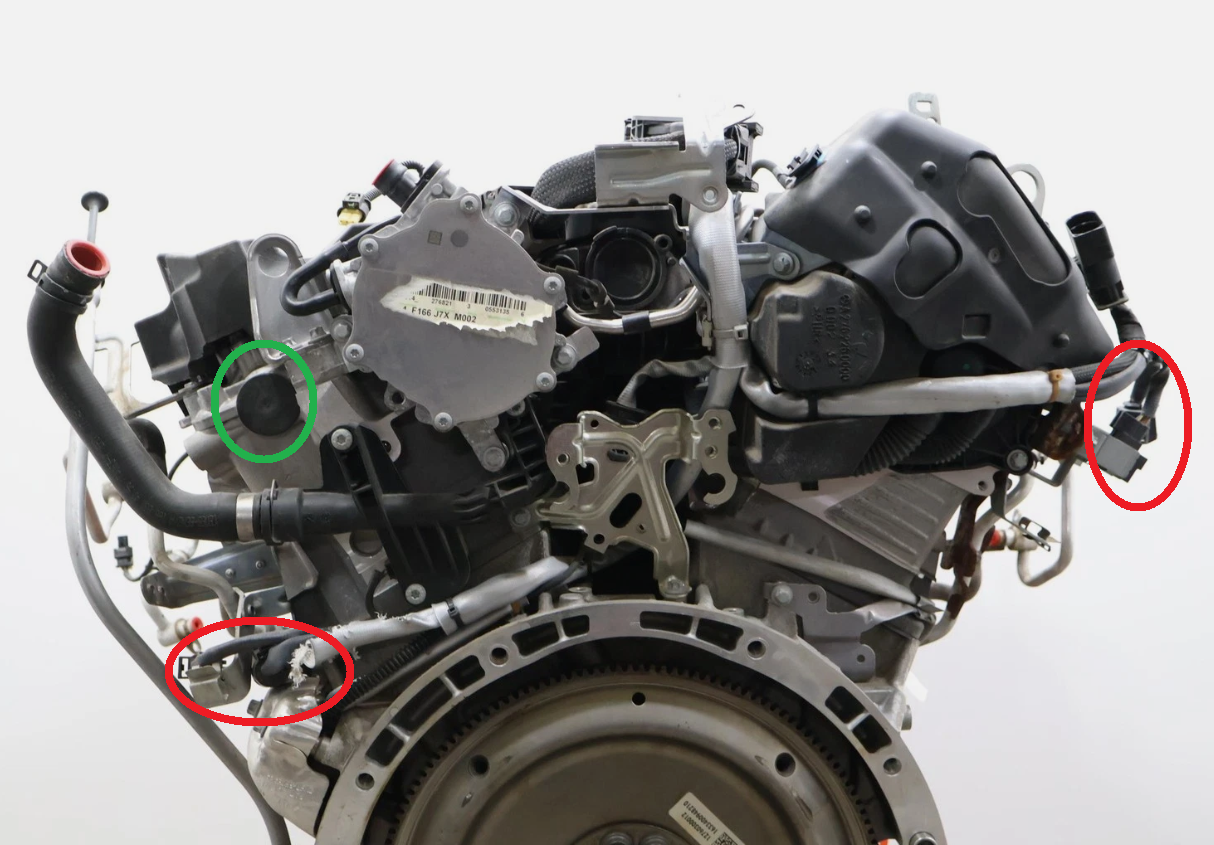

The O2 sensors plug into the ecu harness at the top middle rear of the engine. Not sure how oil would leak down onto the wires. May have oil leaking from the vacuum pump that is above the drivers side O2 wires. There is a small round plastic plug at the back of the drivers side cylinder head.
I'm able to hold my phone down in behind the engine and snap photos then view them on my PC. Snap a bunch because most photos come out blurry with space so limited back there.
I cant see oil leaking from the oil filter housing or cooler making tis way onto the O2 sensor wires or exhaust manifold. You would most likely see oil dripping down directly below it if it were leaking.
I believe the O2 wires are in the silver wire covering, connectors circled in red. Plug circled in green. Can see the silver cover of the vacuum pump next to the plg.
