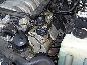

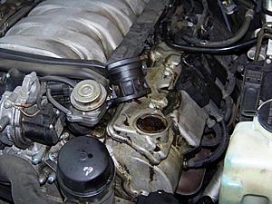

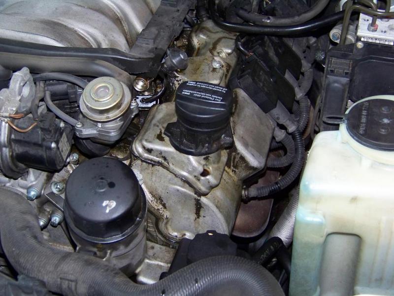

Here are the pics. You can see the oil leaking from the bottom of the plastic filler neck. I removed the filler neck and put the oil cap directly on the valve cover. The gasket on the oil cap seemd much more pliable than the gasket on the filler neck, probably hardened from years of oil exposure and heat. Upon driving, I can still smeel some burning oil. This may be residual, the oil spilled from the neck was quite an amount. I will see if after a few days it goes away. In the meantime, does anyone kow where some new oil cap/filler neck gaskets can be had? All I've been able to find are oil caps.

Hey I thought I better update. Thanks for the suggestions.
I'm pretty sure all the oil came from the filler neck. After I changed the gasket and cleaned up the motor, the oil smell went away completely. I never had any more oil leaks after that. Amazing motor with 200k and no oil leaks except one superficial little gasket problem! I ended up getting the oil cap gasket on autohaus, it's the same gasket for the neck and cap so I replaced both.
BTW, I bent the one of the metal tabs on the bottom of the filler neck getting it off It was prety easy to bend back and re-install. It doesn't come off quite like the filler cap......
