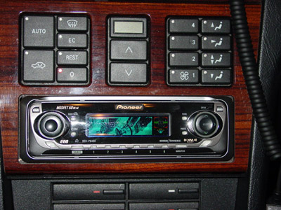

Got the pics finally.
Attached Thumbnails Subwoofer installation/wire running-dsc00749-web-.jpg

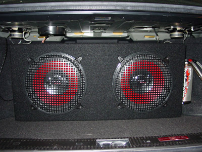

Old Jun 17, 2003 | 11:32 PM
GDawgC220's Avatar
Joined: Apr 2003
Posts: 4,781
From: Boston
'05 A4 1.8TQM6
another...
Attached Thumbnails Subwoofer installation/wire running-dsc00751-web-.jpg
Old Jun 17, 2003 | 11:33 PM
GDawgC220's Avatar
Joined: Apr 2003
Posts: 4,781
From: Boston
'05 A4 1.8TQM6
last one...this one of deck.
Attached Thumbnails Subwoofer installation/wire running-dsc00753-web-.jpg
