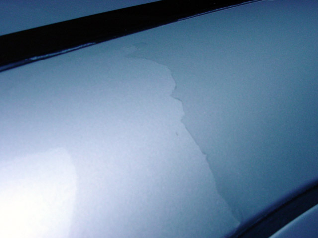

Hi all,
I have a small bit of a clearcoat problem along the driver's side pillar...right above the middle of the driver and rear driver's door. A small area of the clearcoat is gone and starting to peel away. Is there any fixes, aside from repainting? Thanks!

here's one pic

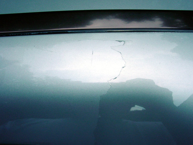

last one...doug, i'm confused at what u'r trying to say

I'm saying that there's no way to fix it. A body shop may be able to wet sand it a little and then put on new clear coat. If not, they will have to just repaint that area.

will anythin happen to that area where the clearcoat is gone? IE, rust or whatnot?

Yes, after a period of time. The clear coat protects the paint.

DIY in paint is HIGHLY not recommended.. especially in such a large area and without a "pro" status.
clear coat in a can is aresol... it will "spit" sometimes.. ie. large chunks of coat onto the service and then it'll look bumpy and not smooth. plus to get a job done so that u cant tell its been painted, they gotta paint the ENTIRE panel so there is no seams. masking it urself would look horrible because either 1. there will be a thick seem where the masking tape is. or 2. it will look like overspray in the area where ur DIY clear coat ends and the original begins under. i used to work in a body shop and i tell u all shops use an compressed air gun.. so its smooth all the way... no "spitting" like aerosol. plus the clear coat is alot thinner and better quality than the ones from a can there it gives the "glassy shine"
if it really bugs you, i'd say spend the cash for a pro shop to do it. otherwise saving $100 will lead to $300 in repainting the whole panel after u screw it up with the aerosol.

I didn't want to be the one to bum you out but I agree completely. If you want it done right, take it to a body shop and let them sand and respray the entire roof. If you try to do it yourself you will regret the results. If you want to save some money you can sand and prime the roof yourself and just take it there with all the trim pre-masked off. Just make sure you know what you're doing before you do it. Preparation is the key to a good paint job.
