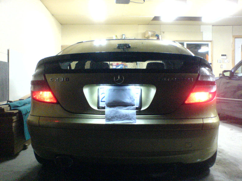

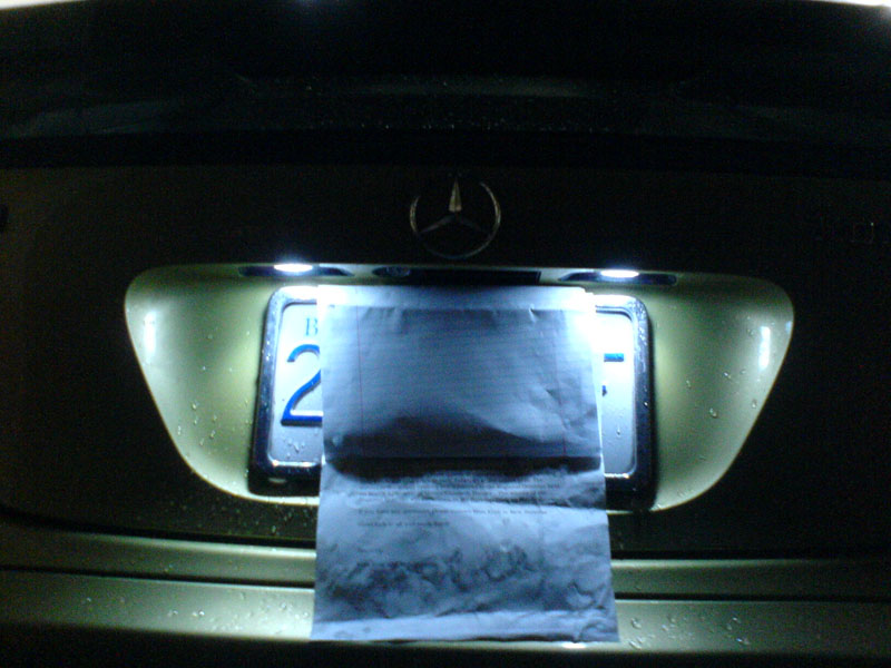

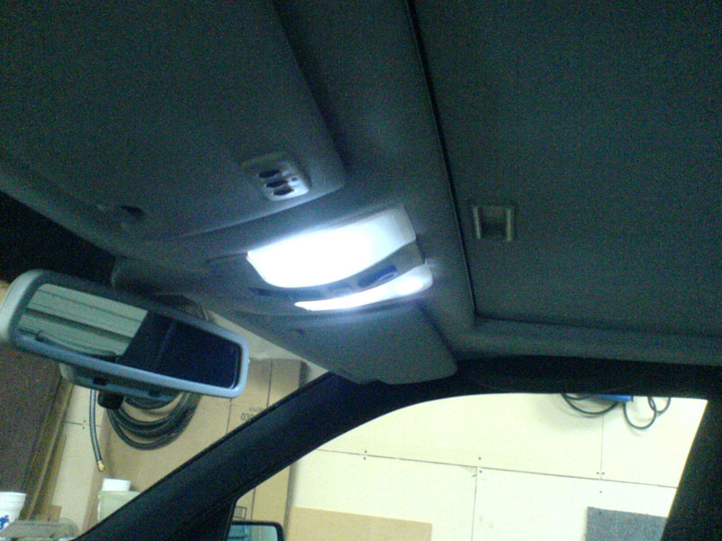

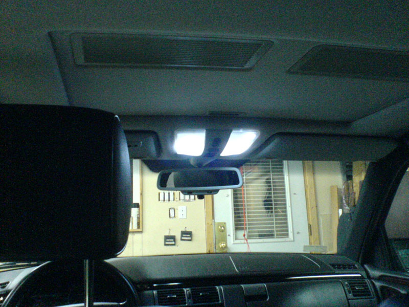

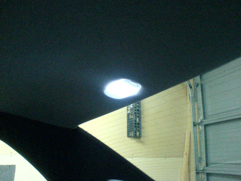

Here's some pics, since most o you have either already seen or don't wnat to see my Green Interior, Here's some pics of my Dad's W210 LEd interior, along with my LED license plate lights.

woah! that is hott! more info on the plate lights please! they look exactly like the lexus lights!

I made them.........Works just like any other dome bulbs. Not much more I can say.

and you were able to put the LED's for the plate w/o resistors? please tell, looks sweet! I want, I want!

I made the LED bulbs with resistors attached.

that's pretty bright! :Y

The risistors I used are the normal cylindrical ones that soder on to the ciruit board, I designed the circuit boards to accomadate the resistors because I knew MB would have these complications. ALl my components are special ordered or me in china. I think I could come up with a few bulbs I use as spares for those who really want them.

It is simple really, MB uses a system that monitors the power used or current drawn by each of it's components. Since normal bulbs draw a lot more current than LEDs, when you use a LED bulb in place ofa normal bulb, the computer will tell you that the bulbs are out as dictated by it's programming. The job of the resistor is to use up whatever current is needed for the LED bulb not to trigger the bulb out warning.
