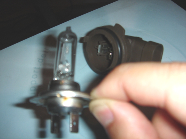

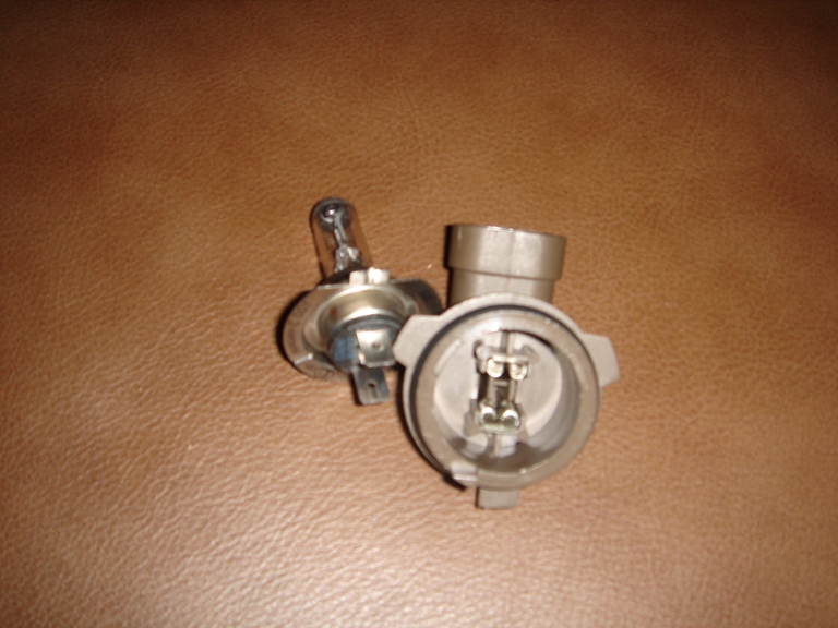

BMW 135i
Originally Posted by drexappeal
Merged with a bunch of threads regarding how to change the fog light bulb.
Just so we have it straight for EVERYBODY.
9006=HB4 Same bulb
2001-2007 w203 has HB4/9006 fog light bulbs.
End of story.
are you sure thats the end of the STORY?
then how come my shop pulled out an H7 bulb from my fog light?
PS please dont move my thread to other THREADS
anwayes here are the pictures
Attached Thumbnails DIY Changing Fog lamp Bulbs & W203/CL203 Fog Lamp Thread-picture-297.jpg   DIY Changing Fog lamp Bulbs & W203/CL203 Fog Lamp Thread-picture-298.jpg   DIY Changing Fog lamp Bulbs & W203/CL203 Fog Lamp Thread-picture-2999.jpg

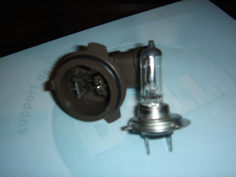

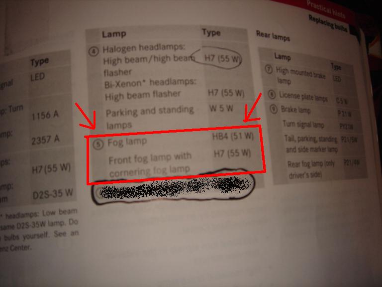

Old Jun 12, 2007 | 11:38 PM
  #178
c230 o5's Avatar
Joined: Nov 2005
Posts: 651
From: N.Y
BMW 135i
i just found out from my manual book . why i have H7 bulb its because
i have got my BI-Xenon Stock from mercedes wich also gives you cornering
front fog lamp wish is H7 thats why i guess i have H7
Attached Thumbnails DIY Changing Fog lamp Bulbs & W203/CL203 Fog Lamp Thread-picture-3000.jpg   DIY Changing Fog lamp Bulbs & W203/CL203 Fog Lamp Thread-picture-3002.jpg   DIY Changing Fog lamp Bulbs & W203/CL203 Fog Lamp Thread-picture-3003.jpg   DIY Changing Fog lamp Bulbs & W203/CL203 Fog Lamp Thread-picture-3001.jpg
Old Jun 12, 2007 | 11:40 PM
  #179
advans's Avatar
Joined: Jul 2005
Posts: 7,424
From: New York City
C55 ///AMG, 535xi
thats freakin h7 lol thats the first time i've seen a h7 bulb with a connecting socket lol, how I got a solution for someone...lol
Old Jun 14, 2007 | 03:09 PM
  #180
c230 o5's Avatar
Joined: Nov 2005
Posts: 651
From: N.Y
BMW 135i
Im the only one with a H7 fog light lamp here i feel special i got conering fogs
That must be an '05+ thing, cuz I had bi-xenons from factory and my fogs are 9006/hb4. Whatever the case, it's not exactly something to brag about though. 9006/hb4 bulbs are less expensive.
Old Jun 14, 2007 | 06:05 PM
  #184
c230 o5's Avatar
Joined: Nov 2005
Posts: 651
From: N.Y
BMW 135i
yea i found out when i read my manual book
i guess we All learn something new everyday
