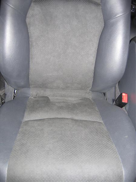

Still a work in progress, need to do the driver's seat, fake perfed vinyl on the doors, and face of the headrests. Probably the top of the center armrest while I'm at it if I can ever figure out how to take it apart without breaking it.
In addition to the Alcantara I removed the incredibly hard fibrous matting in the seats and replaced it with 1/2" medium density visco foam, and also installed some 4mm polyester breathable mesh to allow more air flow through the perforations, although the Alcantara is already very breathable. The seats are still very firm, they just have a lot more give and more of a "bucket" feel to them since the visco foam flows away from areas of high pressure, notably your ischial tuberosities ("sitting bones")
Why did I do it?
I just happen to have about 100 meters of charcoal grey perfed Alcantara hanging around, and my butt hurt pretty bad after my last long trip.Those OEM seats are EVIL. Oh yeah, it is VERY lux looking as well...
I can honestly say they were the only thing I did not like about this car.
These pix are pretty poor - taken in the dark, I'll post some new ones in daylight when the entire job is finished.

They look very comfy, and nice!

I think it looks great...

nice fit looks good.

Damn that does look really nice.

looks very nice!

front looks nice, but the rear looks a bit odd
