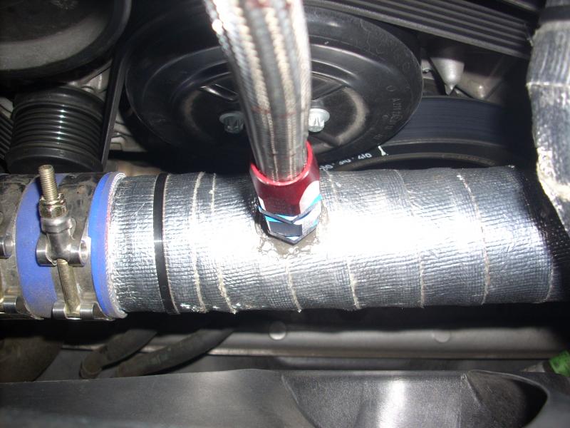

C
M271 EGR hose connection to intake pipe
its been awhile since I first posted my resonator delete and new intake pipes. here are some pics of the finsh. I used earls fittings to make it look nice. If you decide to use a regular hose to egr to pipe it is a 3/4 hose.
for earls fittings need:
3/8 npt pipe tap (to tap out EGR and intake pipe where resonator was, to ad new fitting)
qty of 2 (3/8 to -8 an stright adapter) one will go into egr, and other will go into new pipe where resonator was deleted.
qty of 1 (45* degree hose swivel end, -8 size)
qty of 1 (straight hose swivel end , -8 size)
-8 hose , measure to your lenght depending on where you put your hose on the intake pipe.
Clear your codes on ecu. This will clear your p0410 code
and your done tada. gl all
Attached Thumbnails M271 (1.8L) Supercharger Intake Resonator (baffled muffler) removal-c230-004.jpg   M271 (1.8L) Supercharger Intake Resonator (baffled muffler) removal-c230-005.jpg   M271 (1.8L) Supercharger Intake Resonator (baffled muffler) removal-c230-006.jpg   M271 (1.8L) Supercharger Intake Resonator (baffled muffler) removal-c230-007.jpg   M271 (1.8L) Supercharger Intake Resonator (baffled muffler) removal-c230-008.jpg

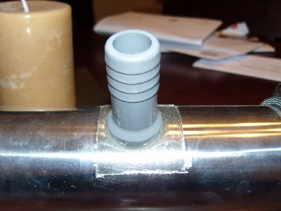

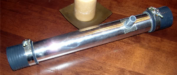

Here is some pics of what I have come up with for a breather hose attachment to the IC piping:
M271 (1.8L) Supercharger Intake Resonator (baffled muffler) removal-sn151221.jpg
M271 (1.8L) Supercharger Intake Resonator (baffled muffler) removal-sn151220.jpg
The earls fittings look sharp Teamredline! But unfortunately I don't have a whole lot of extra money to spend at this point.
But I ended up using a high strength, high heat 2-part epoxy, and a 3/4" lawn sprinkler connector that I beveled to fit the aluminum pipe ($.55!). Drilled a hole in the aluminum piping, attached the fitting and that's it! I've attached a MAF sensor before with this stuff to another car I had, and can't believe how strong it is! Its definitely not going anywhere.
I haven't had a chance to install it on my car yet, but within the next week or so I'll see if I created something that will work.
